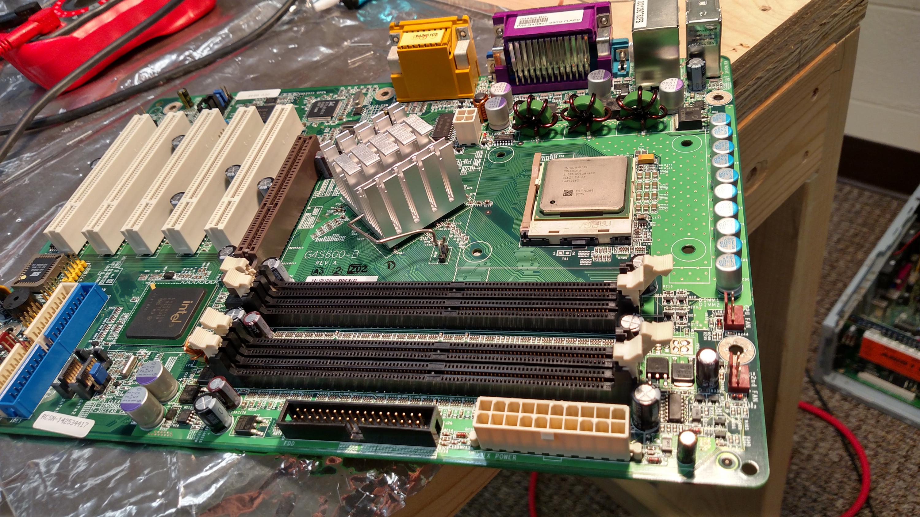

    Hey guys,
    I've got a G4S600-B (this board) that has about 2 dozen UCC KZG caps on it. This is in a digital audio encoder used at a radio station, so it's been on/powered pretty much 24/7 for a number of years. recently it's been getting flaky, so I pulled it apart and noticed that 7 of the 16 1500uF caps on the board are bulged. Did some more research, (signed up for this board!) and find that the KZGs are pretty much despised here.

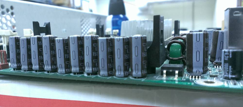

    So I'm looking to recap the motherboard. The KZGs on it are all 6.3V, 105degrees:
    1500uf 8x20mm marked 5(7) 7S- 10
    1500uf 10x20mm marked 6(7) 6G - 4
    1500uf ~10x12mm marked 6(k) 8E - 2

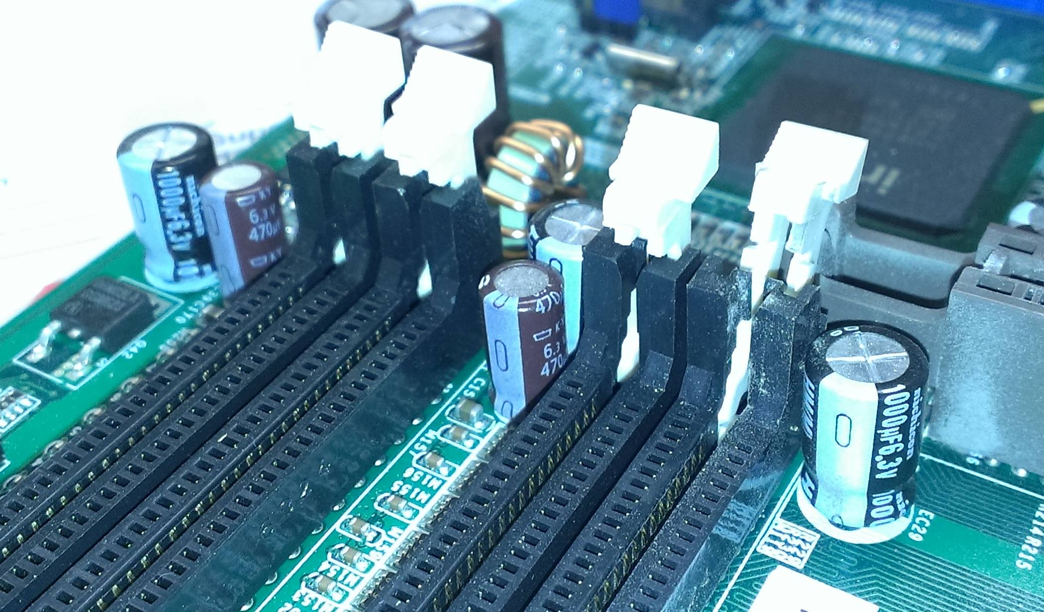

    470uf ~5x11mm marked 5(k) 6c - 3
    470uf ~5x11mm marked 5(k) 6V - 3
    I'm assuming that I ought to replace the 470uf caps too?
    (EDIT: looks like all the rest of the on-board caps are Nichicon HM(M) or OST RLG)
    I'm looking through Digikey, most of what I'm seeing is Nichicon/Panasonics/Rubycon. I'm not very knowledgeable on ripple currents, esv, etc., so I'm hoping someone on here can help me out with some compatible replacements. Here's where I'm looking:
    I've never seen a MB with this many popped caps!
    Thanks guys,
    -J

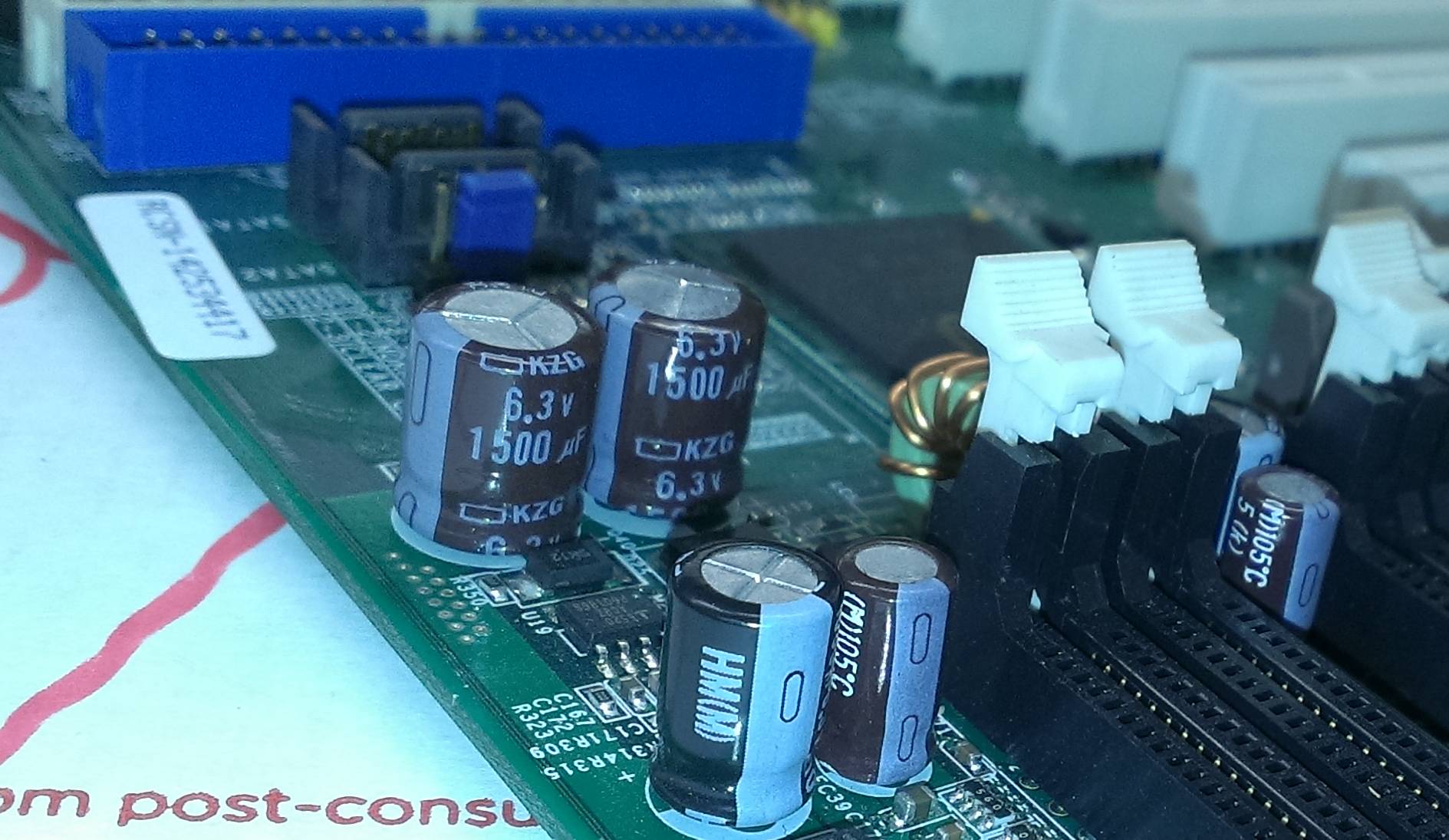

      Re: DFI-ITOX G4S600-B with Chemicon KZGs - compatible caps?
      Nichicon HM series is a direct replacement, and HN and HZ series have lower ESR. I think any of those three series would work.
      The 470uF caps in the second picture are KY series, which don't need to be replaced.
      Are you sure they are all rated for 6.3V? The larger 1500uF caps might be rated for 16V.
            Hey, thanks! I wondered about the 470s. All the Chemicons are 6.3V; the 16v ones are all OST.

                      I think you meant those 4 caps were 16V, not 6.3V. So for the 16V 1500uF caps, here are the choices:
                      this, this, or this. (Nichicon HM/HN)
                      If you want to experiment with polymer, this, or this should work, maybe even overkill.
                      For the 10 6.3V 1500uF capacitors:
                      this, this, this, this, or this.
                      Polymer:
                      For the 2 short 1500uF caps:
                      this, or this.
                      Polymer:

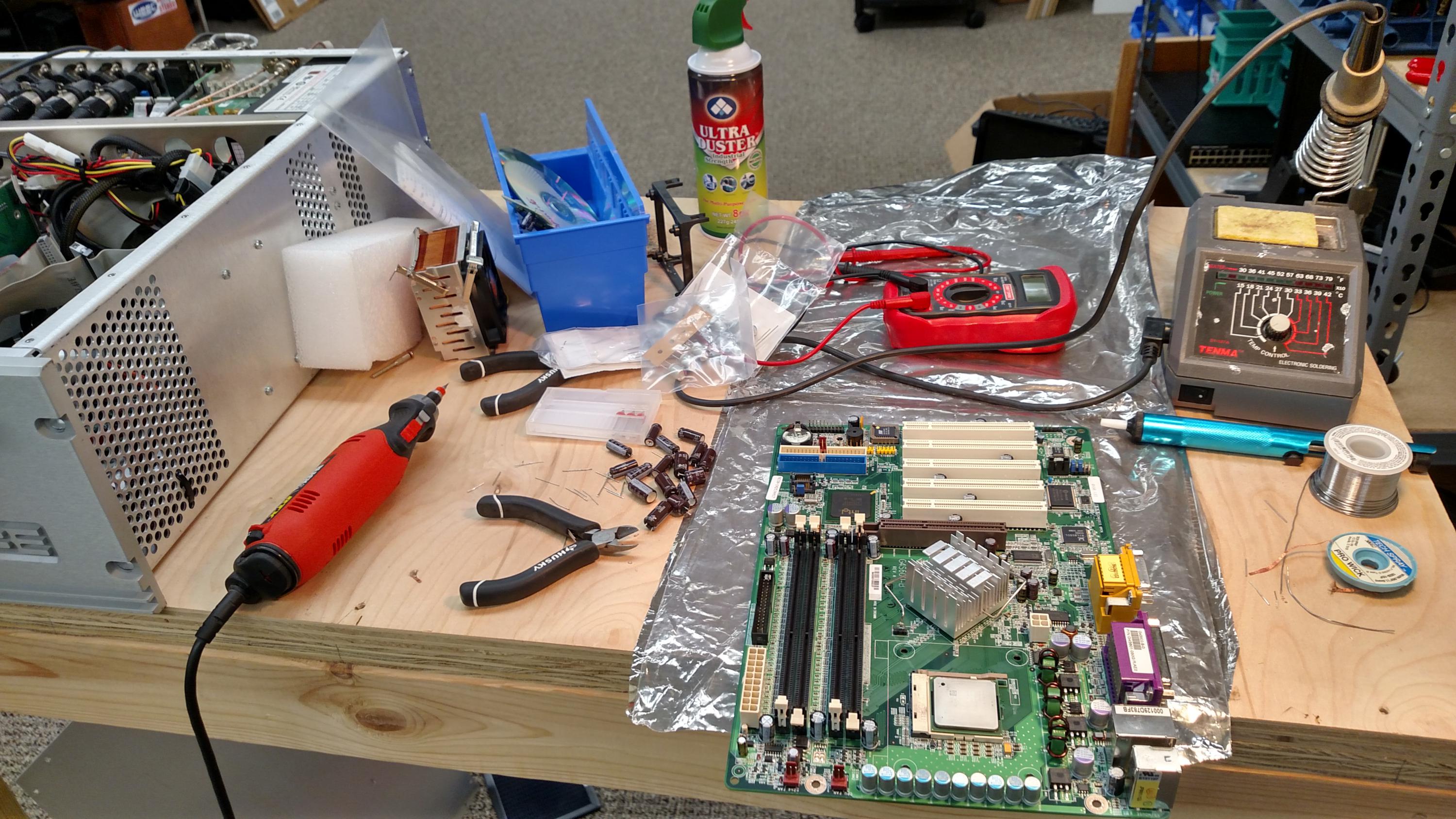

                                  • jesscat606
                                    • Feb 2015
                                    • 18
                                    Bam!
                                    Now to see if it will boot back up. Here's hoping I didn't screw it up!
                                    • c_hegge
                                      • Sep 2009
                                      • 5219
                                      Looks good! The caps all look like they are installed correctly. Fire it up and see how it goes.
