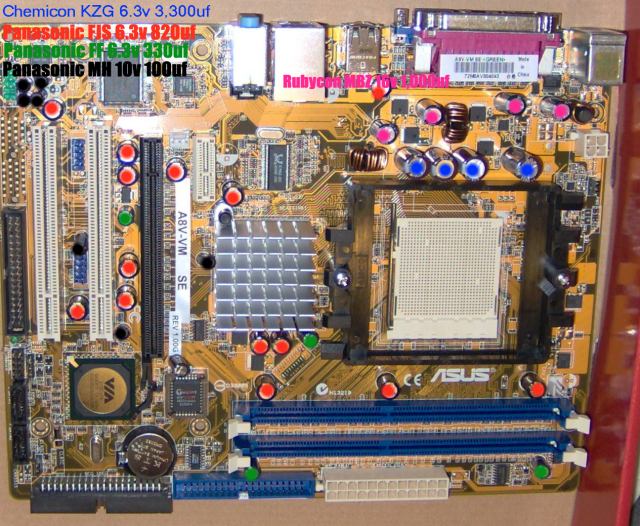

Caps on the Asus A8V-VM SE motherboard
  • geforcefly
    • Jul 2006
    • 33
    Socket 939 motherboard with VIA K8M890 chipset
    Legend:
    Blue: Chemicon KZG 6.3v 3,300uf
    Pink: Rubycon MBZ 16v 1,000uf
    Red: Panasonic FJS 6.3v 820uf
    Green: Panasonic FF 6.3v 330uf
    Black: Panasonic MH 10v 100uf
    Looks pretty good to me (although KZG might not be the best).
    It should outlast the 3-year warranty period.
