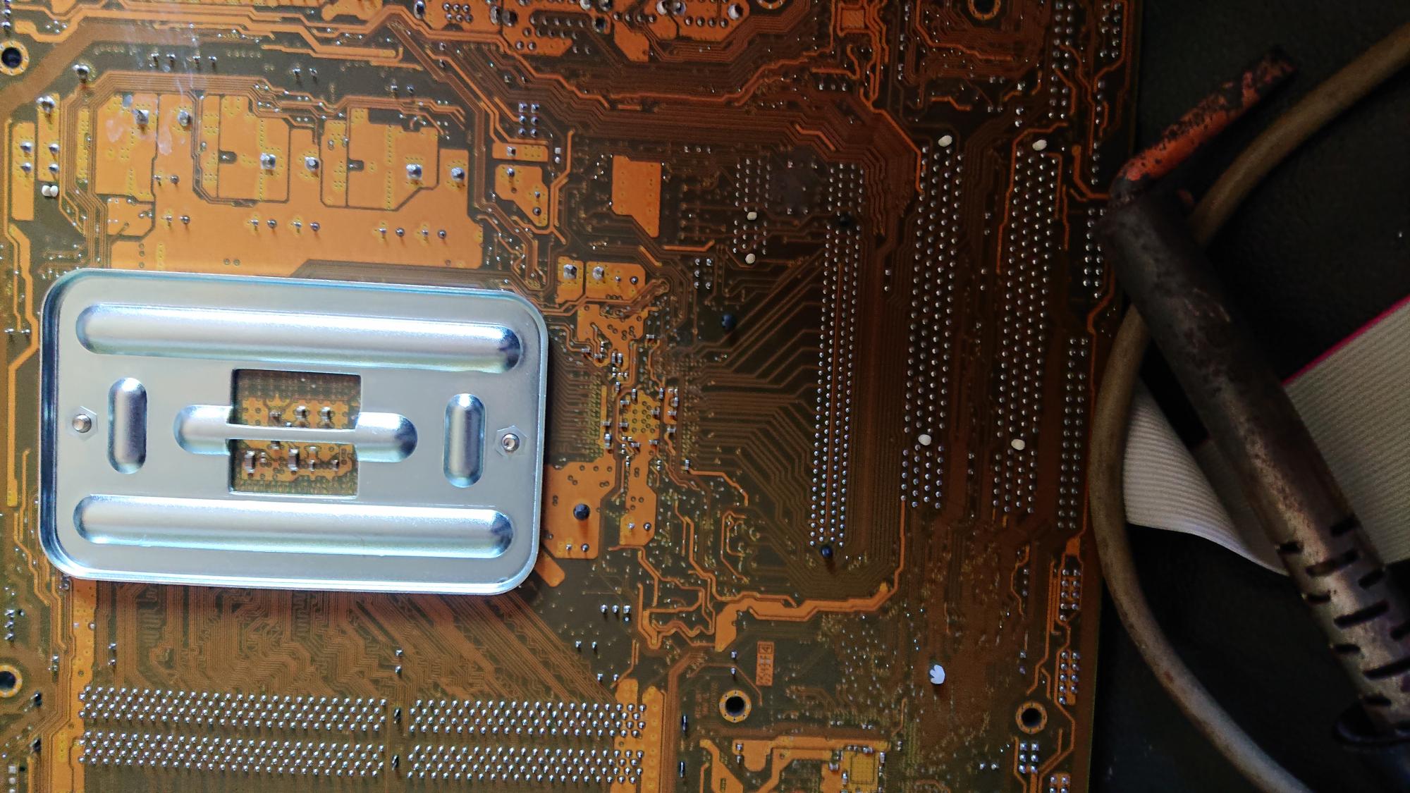

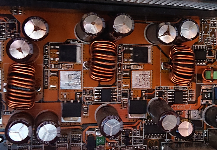

    I have a asus a8r-mx/dp motherboard, can anyone id the open ones? I can't see the text without removing the processor and i can't at the moment. The motherboard is from 2005, support a dual core processor, rare at that time.

    Those caps look to be from Nippon Chemicon. I am going to guess they are KZG or KZJ series, which are known to die ugly.

      Thanks, 1500, 6,3v 8mm/20mm. I have found an amazon but i don't know if they are false or good.

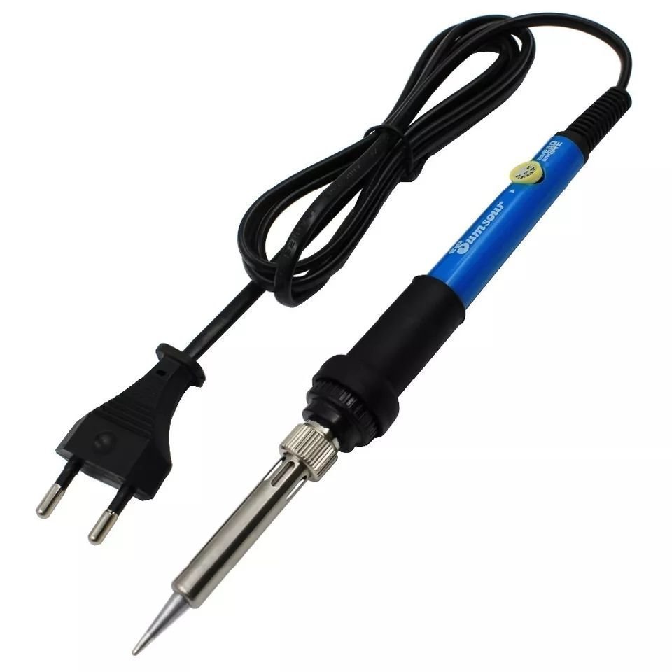

        I have tried to solder them out with 350 to 450 heat but it don't work. The tenn isn't much on the pins and it's hard to reach them. It seems like the tip only gets against the legs? The solder tool is not the big right to the motherboard. It is the blue one.

              I got one loose so the legs are left on the motherboard. It seems to be a black plastic plug on the back. It had been easy to insert a new one to the legs on the motherboard. If the + and - gets right. It is KZG 6.3V 1500UF (M)105c.

                No that is completely retarded!
                You need to add some fresh solder to the legs, the more the better really.
                It helps with heat transfer.
                But above all you need to practice soldering on some scrap PCB's if you never did it successfully before or you will destroy this mainboard.
                You also preferably need a decent soldering iron with say 60W of power, and thermal regulated.

                  It seems hard i tried with 400 and it goes up to 450. But it dosen't loose. I tried to add more solder to the legs but then it only gets loose and the original solder to the legs are left.

                        I solved it by taking a bigger solder tool 75W. Thanks for the help. I bougth these https://www.amazon.com/dp/B08RXW8VJ2...roduct_details i took a chance
