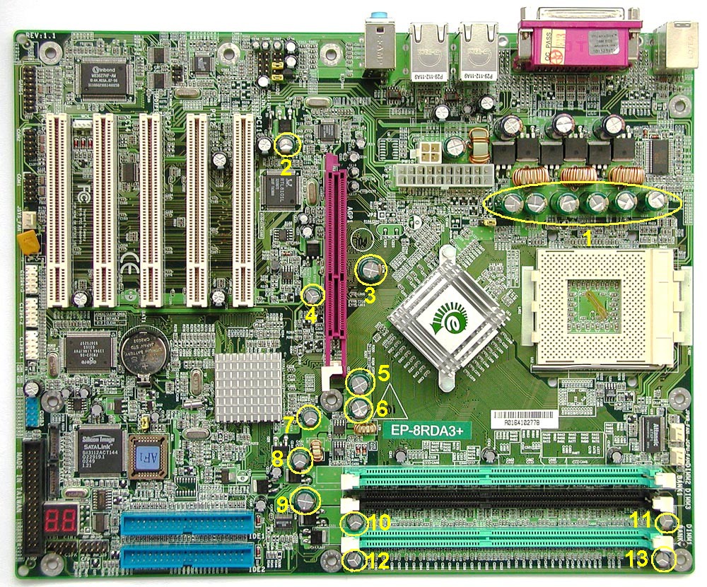

    Anyone here got one of these boards?

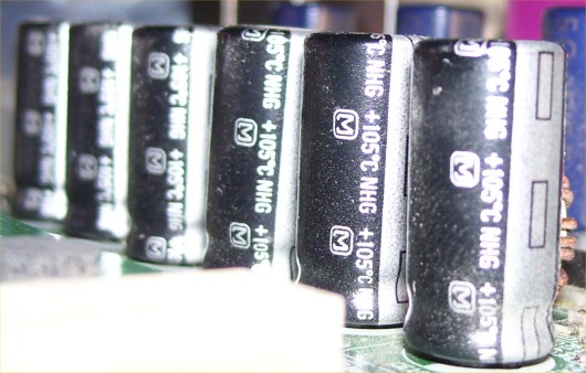

    Just brought one, but it has being sloppily recapped with Matsushita NHG caps - which i believe are general purpose.
    Am also suspicious that a few of them are the wrong value/size/voltage, when comparing photos of the board
    If you have one of these boards floating around, could you please have a look and let met know the values (capacitance, voltage and size),
    so that i can recap it properly
    (the photo is not of my board, but rather, what the original would have being - same model and version)

    In your circle you have the CPU VRM. Fill that area with 2200uF 6.3v caps of good make (Rubycon MBZ/MCZ, Nichicon HM/HZ, Panasonic FJ/FM/FL) and it will be just fine.
    Those Matsushita/Panasonic NHG are likely to be fake and you should replace all of them.

      So, am i right in saying that these caps are not suitable for a motherboard?
      Have attached 3 photos - do they look like fakes?

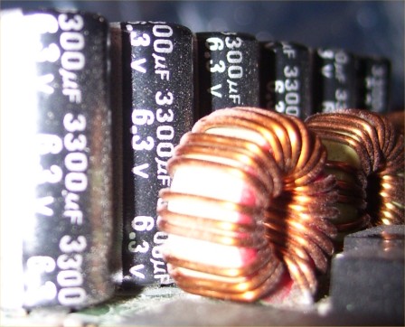

      Interesting to note that the VRM output caps are 3300uf, and that there is 6 of them - because on the microstar boards that i have, there is usually 6 X 2200uf on the vrm output, and 3 X 3300uf on gigabyte
      Why is there 6 X 3300uf on this board, rather than 3?

        You have no way of knowing what and how many caps were there originally. Maybe they were 2200uF but whoever did the recap decided to put 3300uF ones instead. The Panasonics you have there look to be genuine, but indeed, they are not suitable for use in the VRM of a motherboard.

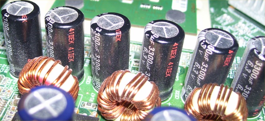

          Here is a list of the stock caps from a board that I have, hope it helps.

            like you, and from what i have seen on other boards, i was thinking the vrm output would have being 2200uf, but they were indeed 3300uf
            seeing the 3 chokes, i assume that the vrm is 3-phase
            would that be a reason why there is 6 X 3300uf, rather than the 6 X 2200uf on my other boards, which are probably 2-phase?

                If it helps, my old EPoX 9nda3J has the same VRM layout and were all Sanyo WG capacitors. The first row was 6x 6.3v 3300uf, the back row consisted of 3x 16v 1500uf capacitors.
                The majority of the other next smaller sized caps down across the board were all OST RLP 6.3v 1000uf with a small peppering of Teapo SH 16v 470uf capacitors.
