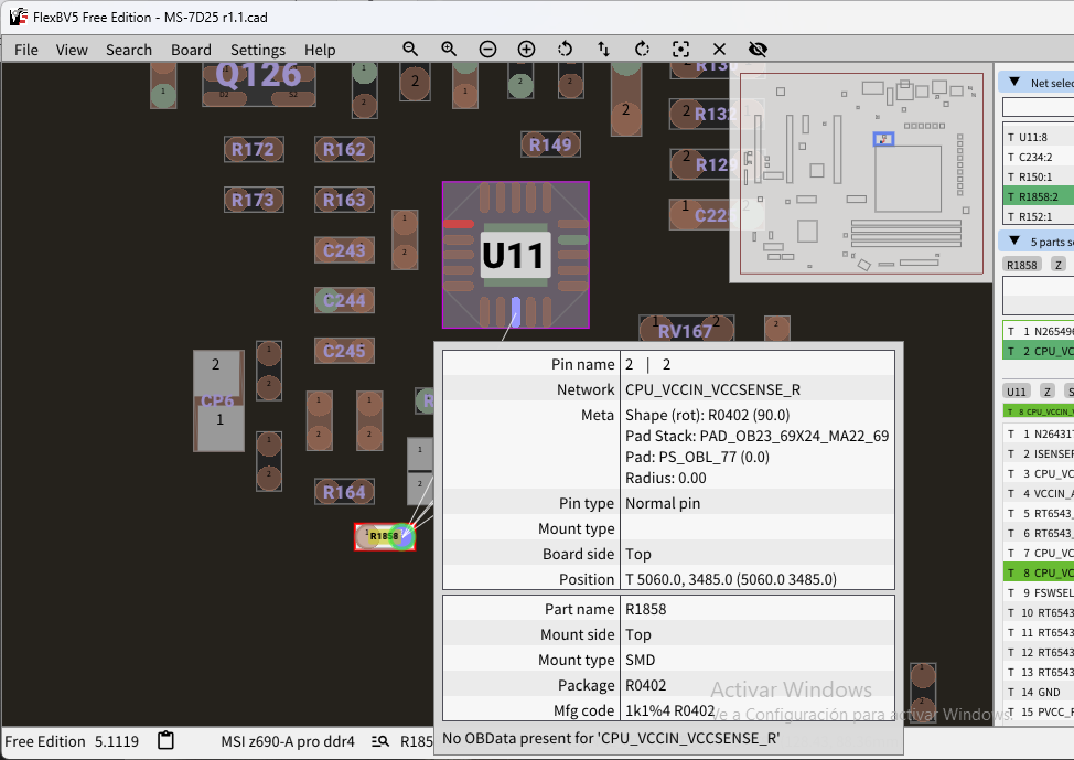

    i bought a used MSI z690-A pro ddr4 and i found that this component was missing. I got it to boot by connecting the pins with some solder but thats was temporary solution so i could check if everything is running nicely, and it does but it crashes under load (any game or program that uses more resources crashes, sometimes i get a hard reset). I have checked the boardview but im not going to sugar coat it - i can not read it yet! I did change one condensator that was clearly busted and found this missing.

    It's a 1K 1% 0402 resistor
    Use FlexBV free to open the boardview
    https://www.badcaps.net/forum/troubl...acos-and-linux
    Boardview here in post 4: https://www.badcaps.net/forum/troubl...22#post1823322
