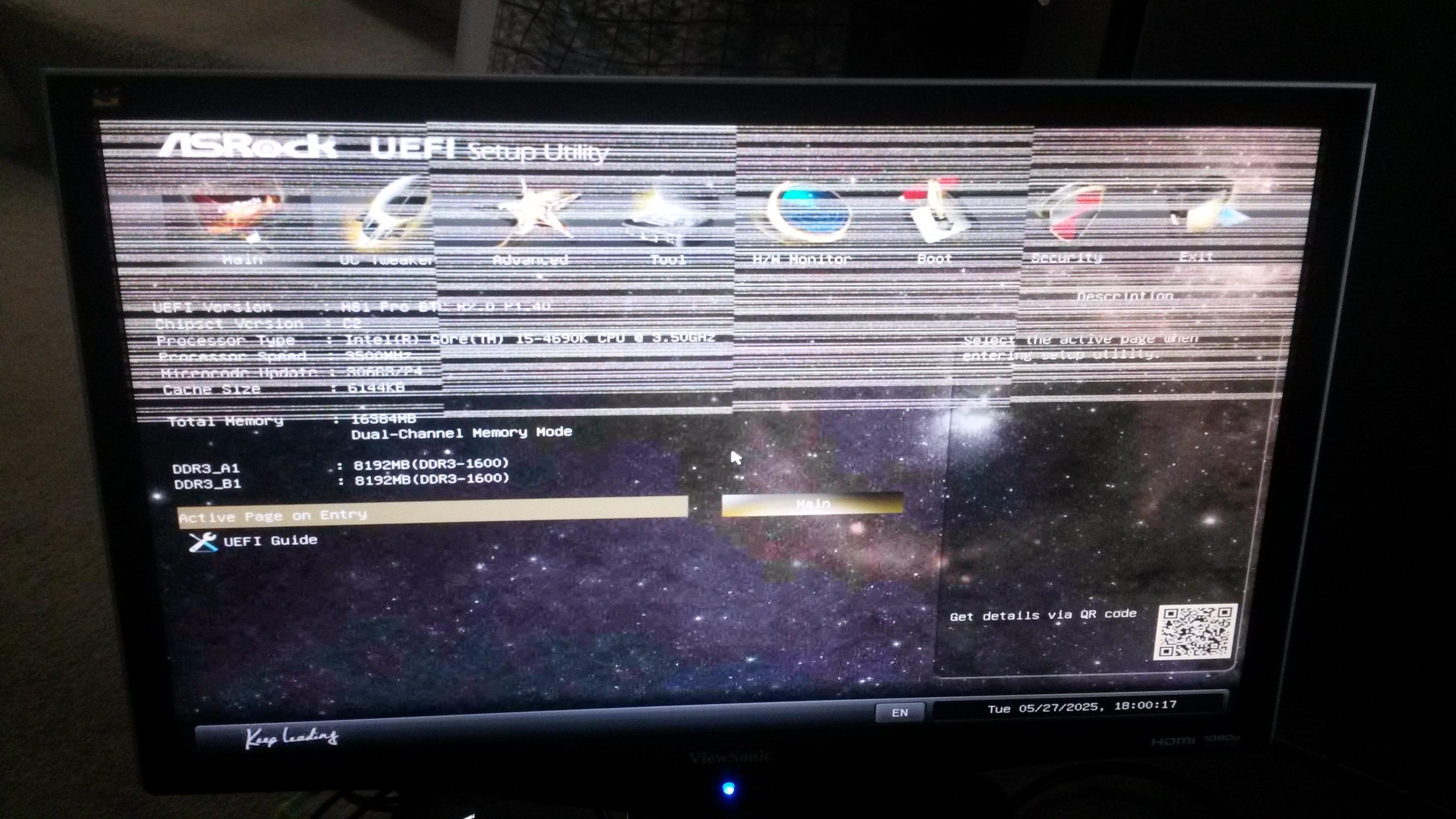

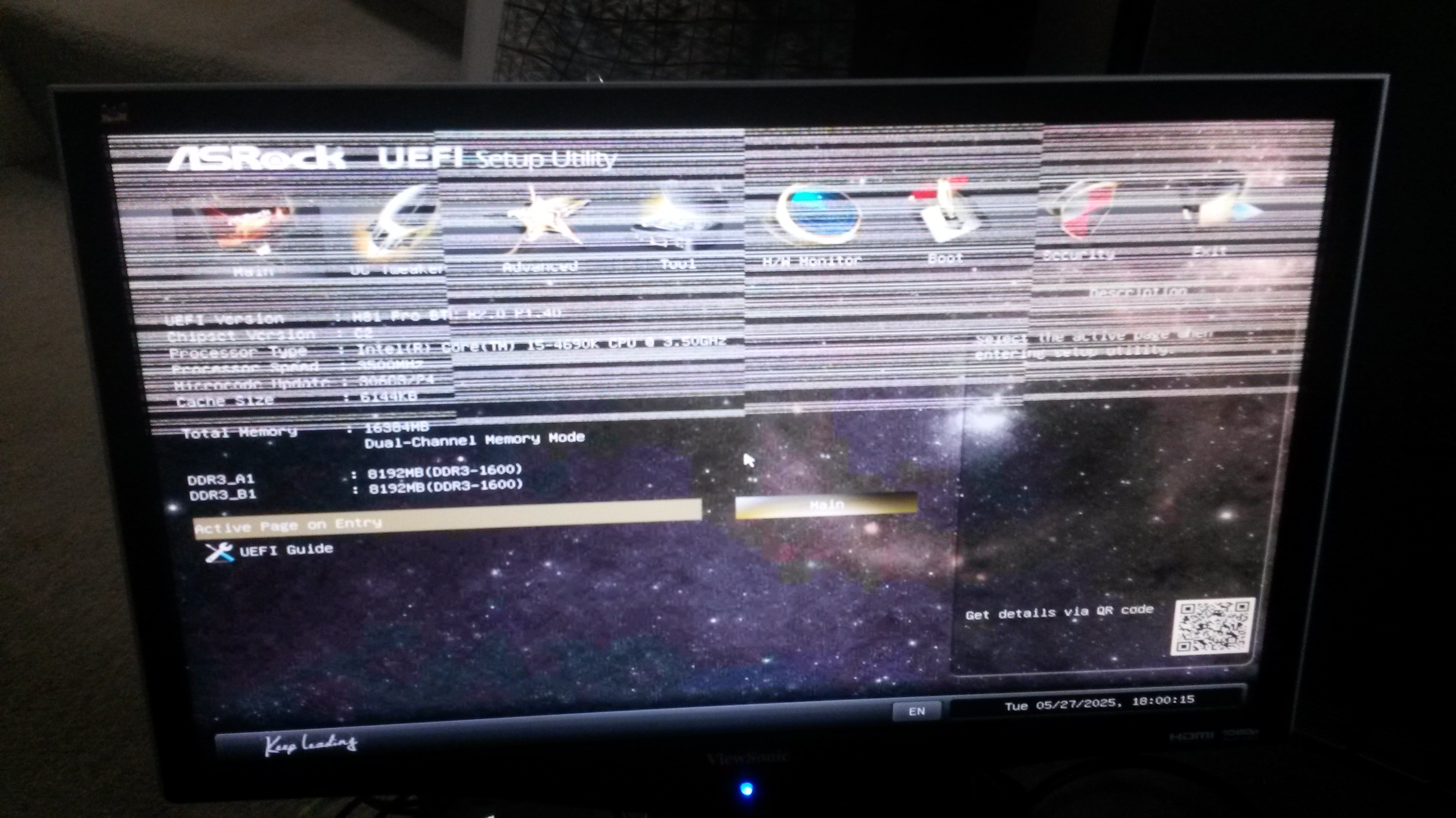

    Recently purchased this MSI GTX 970 Gaming 4G graphics card and card shows plenty of lines when booting up to bios and into Windows.
    What are your thoughts memory issue as I don't have that much experience repairing graphics cards?
    I have checked before plugging in card for shorts on the 12V power rails, PEX etc otherwise I wouldn't have plugged the card into the motherboard.
    The screen shuts down if I load the drivers on the card.
    See attached pictures. Click image for larger version
ID:	3647383 Click image for larger version
    Any thoughts with what is likely to be the issue? I suspect a faulty Samsung memory chip and if so would use MATS?
    Thank you
  • cheeky2
    • Dec 2012
    • 338
    • uk
    Ok just ran Mats on it and found two banks showing errors FBIOB0 and FBIOB1. So I will investigate further. Looks like I will be removing memory and checking the memory controllers as well!​
