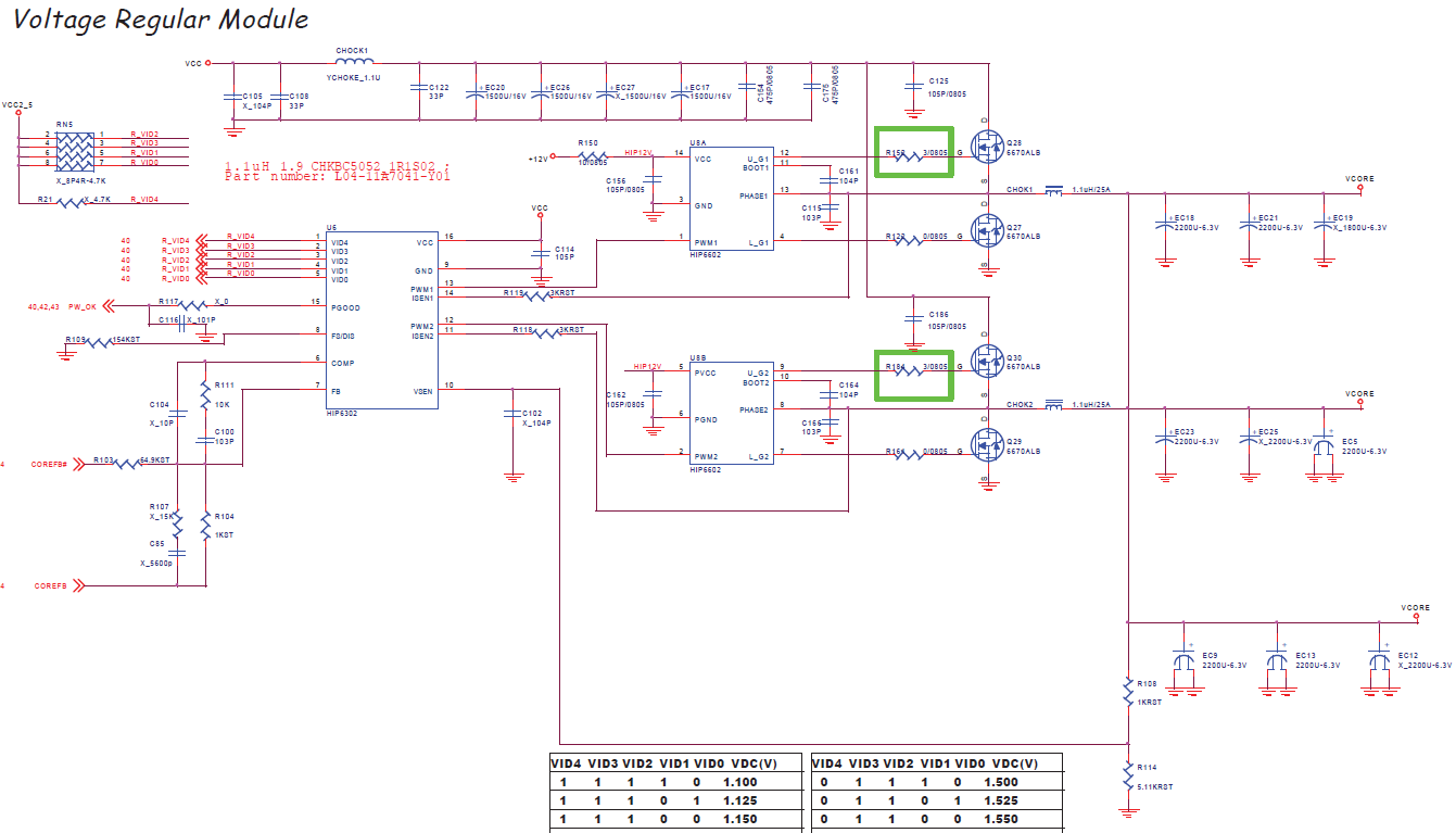

    Hi Peeps,
    Trying to resuscitate a half-dead motherboard (not booting or beeping, power switch works and CPU fan spins , but thankfully not destroying CPUs or RAM)
    A couple of the caps are slightly non-flat, and i have read they they are prone to fail.
    There is 7 of these on the motherboard, and they are all the same specs
    Here is the Original capacitor specs
    Brand :OST
    Series : RLX
    Capacitance : 2200uf
    Voltage: 6.3v
    MAX Op Temp : 105 deg Celsius
    Dimensions 10mm X 20mm
    There is another number written on the caps : 0338 - what is this? (is it 0.0338 impedance?)
    I looked up the datasheet for the OST RLX series and they state that ripple is 2500 mArms and impedance is 0.015, for this particular capacitor.
    The best that i can find is here:
    http://au.rs-online.com/web/p/alumin...itors/5260982/
    It is a panasonic, that closely matches the original
    (the OST capacitor's impedance of 0.015 is out of the range of this panasonic's, which is 0.018 - 0.054
    I'm picking that a lower impedance is not ok?
    Also have read that it is best to get a cap with the same, or higher, ripple current rating that the original.
    This panasonic is the one with the highest ripple current rating (2470mArms) - just short of the original 2500mArms
    Have i chosen the best one from au.rs-online.com,
    or should i look for a one with a higher ripple current rating, higher impedance (and a bit higher capacitance, because there is no 2200uf's that are suitable)?

                        yes, capacitance is an important factor, but you have to understand the dc-dc converters work at high frequencies and have multi-phase converters 2+1, 4+1, 6+1 etc so the ripple is very small.
                        If you work with mains power (110v or 230v and 50-60Hz) you rectify that with a bridge rectifier and you have a dc output with about 100-120 pulses of energy, so you have to smooth that wave out and you need a lot of capacitance depending on how much current you need (approximation for capacitance would be current / ( 2 x AC Frequency x Vripple)
                        But, on motherboards, you have 12v coming from the power supply which already has about 2200+ uF capacitance to smooth out the ripple. Then, right by the 12v 4 pin connector on the motherboard you have one or several 1200-3300uF 16v capacitors which again act as a bulk storage of energy for the dc-dc converter.
                        Now you have a dc-dc controller on the motherboard which works with several phases (2+1, 4+1, 6+2, 8+2 etc) ... each phase is formed of a one or several mosfets, an inductor and capacitor.
                        The controller works at high frequencies 300 kHz, 600kHz, some work even at 1Mhz and basically what they do is turn on mosfets for a brief period of time and then turn the mosfet off.. this can be thousands of times a second or more. The energy that manages to move through the mosfets goes through the inductor and then into the capacitor.
                        The controller monitors the voltage on the capacitors and adjusts dynamically the turn on and off times of each phase and that's how the voltage remains stable regardless of how much current the processor uses.
                        When there's several phases, the controller basically (for example) turns on a phase for 2 ms and keeps it for 3ms but 0.5 ms after it turns on the first phase it turns on the second phase and so on. Each phase is slightly delayed from the previous one, to increase the number of pulses of energy that go to the output.
                        So if a phase turns on 1000 times a second, in a second with 2 phases you'll have 2000 turn on and offs..
                        So think of whatever is in front of the 6.3v capacitors as a rectified AC voltage that was at thousands of Hz ... instead of just 100-120 big pulses of energy you have thousands smaller ones. So the capacitance needed to smooth those bumps is much smaller. The inductors in front of each capacitor also help a lot - inductors resist current change and for example, if the cpu suddenly pulls a lot of current, some energy from the inductors will go to the cpu until the dc-dc controller increases the turn on time.
                        can you, or someone else, briefly explain how a lower ESR justifies using a significantly lower capacitance replacement. (say, from 2200uf to 1200uf)
                        i.e. where do you draw the line - why not 600uf?
                        It doesn't necessarily justifies. The way I understand it (and I may be wrong) .. the esr is .. as the term says .. an internal resistance. You have V = I x R and P = I * I * R .. so if the capacitor has 0.01 ohm esr, and your cpu pulls 1.3v at 10A then you have a potential voltage drop of 0.1v and about 100*0.01 = 1 watt dissipated into the capacitor.
                        With lower esr you have lower voltage drop which makes it easier to make the output voltage more stable with variations in current, and the capacitors heat less and last longer time.
                        So paralleling several capacitors reduces this esr, every capacitor heats less, there's more leads and more wider traces to handle those currents etc etc etc
                        depending on how many phases and how fast the dc-dc controller is on your motherboard, that guides you in choosing the minimum capacitance.. some older intel datasheets/documents were suggesting a minimum of 1000uF capacitance or something like that, but suggested using multiple capacitors for lower esr and longer life (but don't ask me to give you those documents as I don't have them and don't even know what document would that be). Anyway, these were old documents from p4 times, newer processors have different requirements, use less power etc.
                        Also, would it be a better choice to use a polymer as a replacement for these capacitors (reliability, lifespan etc)[/QUOTE]
                        yes, it would help but for that motherboard it makes no economic sense. They're too expensive. Those Panasonic FR capacitors have 4000-10000h @ 105c so they'll last for years without any problems on such motherboard.

                                  Now back to your board. Here's a better image I took from google images:
                                  And here's the schematic of your motherboard - note that it may not be the same as your exact board, it may be a different revision, but it's close enough:
                                  http://savedonthe.net/download/561/m...v_100_sch.html
                                  PDF should also be attached below.
                                  If you go on page 39 in the PDF, you'll see the voltage regulator module. You see there voltage coming from VCC (the 4pin 12v connector) and then it goes through an inductor which is the one to the right of the 12pin connector. Then, it goes through several tiny surface mount capacitors and some capacitors that in the schematic show up as 1500uF 16v. The schematic shows 3 but your board could have only 2 x 2200uF or some other values. The capacitors I talk about should be the ones above that inductor, a bit to the right of the speaker jacks and the 4pin 12v connector.
                                  From there, the electricity goes through at least 4 of those black squares with two leads coming out of them (those are mosfets). The schematic shows two phases, each phase having two mosfets.
                                  Each phases' output goes through a choke/inductor (those coils to the right of the mosfets) and then the voltage goes out to capacitors to smooth out the voltage further.
                                  If you check the pdf datasheet, you can see that there's a LOT of capacitors on the output of the regulator - you have there one phase with 2x2200uF+1800uF, one with 3x2200uF and another one with 3x2200uF. The schematic is ideal, it's more than needed, hence why the version of your motherboard only has 3 capacitors installed out of four locations above the processor socket (in my picture) and 2 capacitors to the left of the socket (in my picture) which I believe it's not related to the power going to the cpu, it's more likely to be filtering for the chipset (hence why it's smaller at 1000uF on your board, as chipset doesn't use a lot of power)
                                  And if you're curious, the HIP6302 dc-dc controller and the two phase controllers/drivers HIP6602 (or whatever is used on your version of the motherboard) should be those tiny chips above the capacitors near the connectors, or in top right corner of the motherboard in my picture.
                                  So you have some capacitors rated for 16v at the input, near that 12v 4pin cpu power connector. Those are the bulk storage for the dc-dc converter. dc-dc converter sends pulses of power through those mosfets and you have smaller voltage on those 6.3v rated capacitors after it goes through those chokes/inductors.
                                  The 16v capacitors are needed for moments when the cpu suddenly demands lots of power, for example when it goes from 10w idle to 60w load in a game. The controller has to pull more current all of the sudden, the power supply has to react to this sudden demand and ramps up in a few microseconds or milliseconds, those 16v capacitors are there to provide instant energy until everything recovers or goes up to the new demand.
                                  There's also other technical reasons why those capacitors are needed but the post is long enough already.
                                  If you want to learn more about phases and how dc-dc converters work on motherboards, these videos are VERY informative:
                                  Motherboard VRM Explanation Part1: The VRM and PWM : https://www.youtube.com/watch?v=zDxFbAhu4Bo

                                      Ok,
                                      i was hunting for position C23 and couldn't find it on the board (maybe it's not there since this is rev 2.0?)
                                      And while i was doing that, i noticed an unusual component, then i realized that it was not an unusual component, but rather a burned-out small capacitor)
                                      1. What could have caused this?
                                      i don't see how a partially-shorted 16v cap could cause this - it's not like that would increase the current from the PSU,
                                      so it seems like this is the result of a suspect PSU, not blowing it's fuse when it should.
                                      2. In such an instance, do those tiny caps explode before the big caps?
                                      3. What is the function of these tiny caps that are in parallel with the 16v electrolytic caps, and how necessary are they?
                                      4. Does 475P/0805 mean 475 pF, and what does 0805 represent?
                                      5. Is it possible to solder a new cap on (with tweezers and an electron microscope)?
                                      After cleaning up the burned area and the disintegrated cap,
                                      i turned the board over and tested (+ve to +ve, -ve to -ve) across all the three 12v caps, and got 2/3 FSD on ohms x1
                                      Then tested across the seven 6.3V caps, and got FSD on all of them
                                      On both tests, the needle did not drop back - indicating current flow through all of them
                                      (Had some 470uf lying around and tested on of them, the needle went up and down quite quickly, so the meter seems good)
                                      Looking at the circuit diagram for the 6.3v caps, if one is shorted, and i measure across another good one, then the multimeter current will be going from one side of the cap, through the motherboard earth, through the faulty cap, along the +ve rail to the other side of the good cap (after the cap has charged).
                                      So, it seems that, in this instance, in-line testing can not identify which cap it is, they will have to be removed, one at a time, until the fault disappears.

                                        C154, that ceramic capacitor could have just shorted by itself and burnt out. Or was stressed due to the faulty electrolytic capacitors not filtering the supply properly and shorted out.
                                        470pF sounds right to me. 0805 indicates the size.
                                        Installing a new one would be easy, following this method: https://www.youtube.com/watch?v=qs7rSM731gk
                                        Suggest you practice on an old board first though. But it's actually quite easy once you get the hang of it. And make sure you have good flux.
