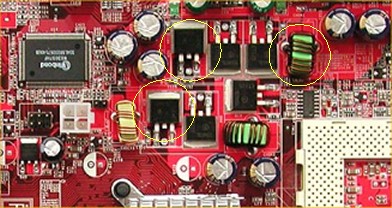

    upon further inspection in the daylight, the motherboard now has a pit in it, and the left pad that the cap was soldered to, is no longer there
    (have put a better photo on that webpage link)
    that vid only applies if there is two pads already there.
    i get a continuity between those two metal (they look white on the photo) bits on the left, and the motherboard earth at the metal circles around the board mounting holes
    also, i'm now going to remove the 16v and test each of them with the analogue multimeter.

      The pad will have burned up along with the capacitor then. If you can see the track or via that it went to, you can solder the good end normally then solder the other end with a thin piece of wire. Tricky but should be doable.
      Since you have a few parts in parallel you should be easily able to find a common connection to wire to, nearby.

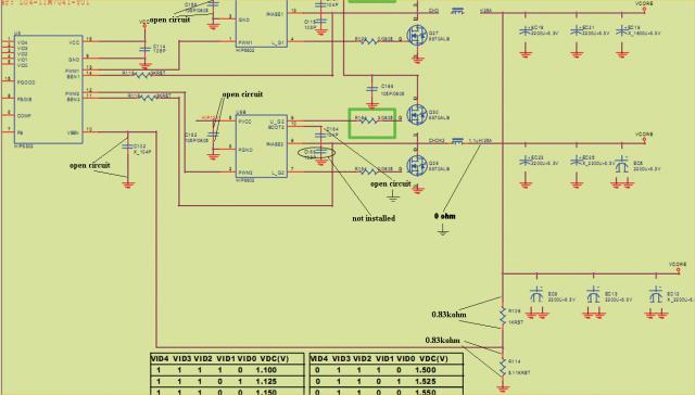

        Now as you figured out, the schematic is for KT6 Delta (codename MS-6590) but there were several revisions so you have to pay attention and follow the traces to see if those part numbers match with what you have on the board.
        This being said, that tiny capacitor does look blown up and you did good by desoldering and cleaning that area.
        There's only two terminals there, one thick large pad because there's lots of current there and on the other side you may have what looks to be two traces but basically they both go in the same place.

          i note the two phases on the same mosfet (the two separate drawings on the schematic caught me out for bit)
          will be revisiting those first two vids for a recap-itulation.
          before i do, just quicky...
          1. The "HIP6302 dc-dc converter", that you mentioned, is the PWM?
          And the "phase controllers HIP6602" is one component containing two drivers/doublers.
          So, looking at the schematic, the current is coming in, getting smoothed by the capacitors, then going into the drivers, and then into the PWM!
          But the dude in the video says that current hits the phase controller, and then goes to the drivers/doublers.
          2. So is the reason why the current goes to the drivers first - because this is for the feedback loop?

            HIP6302 :
            Microprocessor CORE Voltage Regulator Multi-Phase Buck PWM Controller
            The HIP6302 multi-phase PWM control IC together with its companion gate drivers, the HIP6601, HIP6602 or HIP6603 and Intersil MOSFETs provides a precision voltage regulation system for advanced microprocessors.
            Don't look at the board and think it's layed out exactly as in the schematic. 12v doesn't have to go into the controller, come out and go somewhere else, they're not in "chain" - the controller 6302 and the drivers 6602 can be somewhere further away from the mosfets and capacitors and some tiny traces can send 12v to them to power them up and other tiny traces can go to the mosfets and drivers and so on.

                I don't see how it's so hard to understand. We're talking about two different things.
                The thick, heavy current flow goes like this :
                12v > input inductor > input capacitors > mosfets > output inductor > output capacitors
                The mosfets are like on/off switches that have to be turned on or off by something. No matter what state the mosfets are in, you still have 12v after the input capacitors.
                So after the input capacitors, a bit of 12v is taken to power up the controller and drivers which then turn on or off the mosfets and monitor the output voltage and adjust how fast the mosfets are turned on or off to maintain the voltage where desired.
                The heavy current, the amps on 12v, don't go through these controller+drivers side, for example in theory they could be powered separately from a 9v battery if you'd want to... they just take power to work from the same 12v because it was convenient, already there close to the chips.
                So you also have
                12v > input inductor > input capacitors > controller (and )
                12v > input inductor > input capacitors > driver(s)
                and then you have signals like this:
                controller ----> drivers ----> mosfets (on/off)
                At any time, there's 12v at the input of the mosfets, controller and driver but without signal from the drivers, there's no output voltage on the mosfets, they're switches after all controlled by the drivers.
                So I'm talking about how current flows from input to output looking at the controller/driver as something auxiliary, as a sort of "management" circuitry, a "gatekeeper", which just controls the flow.
                He's arranging the components in the order of importance, not in the order the components are physically connected on the board. He's basically saying:
                First is 12v, inductors and capacitors because nothing works without it.
                Next is the controller and the phase drivers because mosfets depend on them to work, without them nothing moves further in the circuit.
                Next he puts the mosfets because those let the current flow through them, if they're dead or don't turn on or off, current doesn't flow further.
                Next is the output inductor which smooths the current pulses and the output capacitors which further smooth things out.

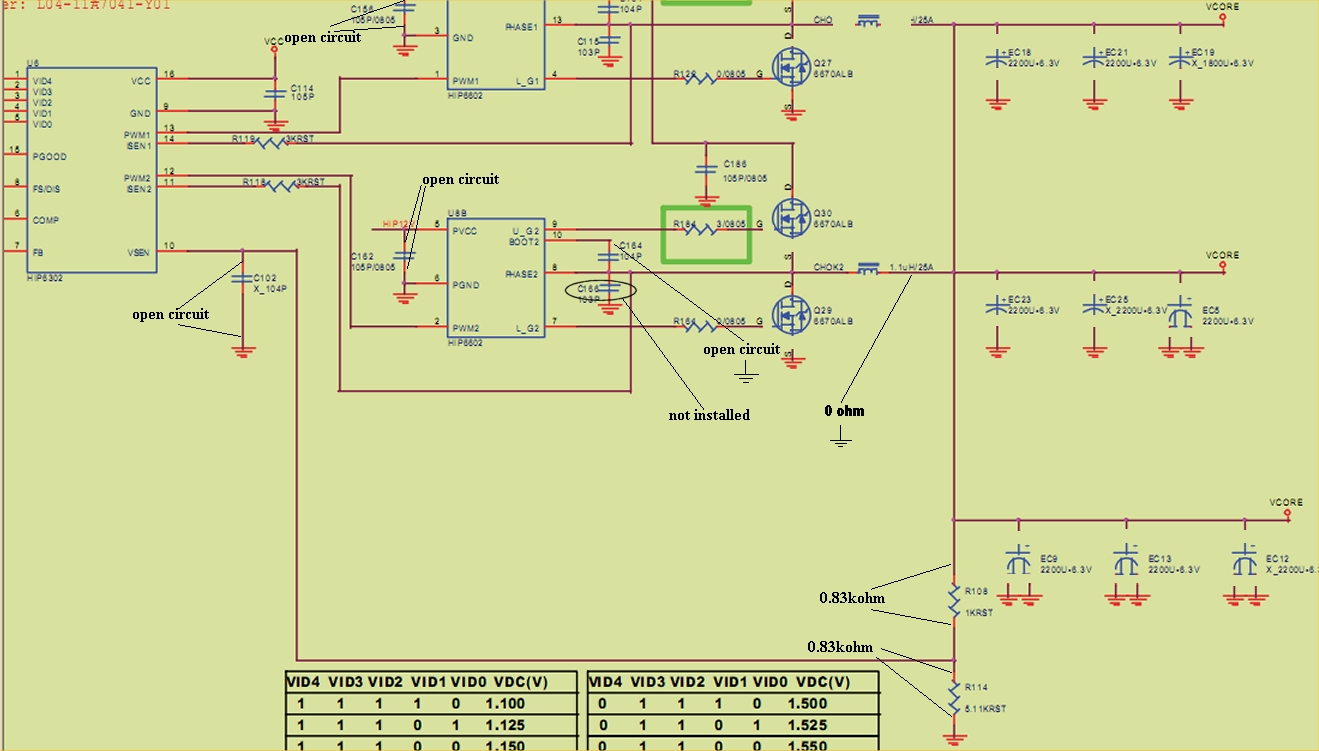

                  1. "after the input capacitors", the tee off that feeds the controller is not shown on the schematic. Is this the "VCC" terminal 16 on the PWM (HIP6302)?
                  2. i see that terminals 13 and 8 (Phase 1 & Phase 2) on the driver (HIP6602), go straight to VCORE, what is the function of this path? - It looks like they tweak the thick heavy current that suppies the CPU.
                  I'm not too keen on desoldering the mosfets if it's not absolutely necessary.
                  So, i powered up the motherboard (with known good ram and CPU),
                  then checked voltage at mosfets Q28 and Q30 - the Drain shows 12.2v and the Source shows 1.62V - which looks like the right voltage to power-up the CPU
                  3. (BTW, what is the function of the other two mosfets (Q27, Q29)? - when they are switched on, they look like they create a path to earth)
                  Seeing 1.26V on the Source of Q28 and 30, rules out the possibility that these mosfets are shorted between Drain and Sink
                  So seeing that the voltage was correct at the source of both mosfets (which seems to indicate that the PWM is doing that part of it job correctly),
                  i then tested both sides of both of the chokes, and got 1.62V there.
                  4. i also note that there is another path to the VCORE terminal, that comes from the PWM terminal (VSEN) - what does that do - is it a sensor?
                  Anyway, what would be the next logical step after this testing?

                    "Seeing 1.26V on the Source of Q28 and 30, rules out the possibility that these [other two mosfets] are shorted between Drain and Sink".
                    There are 2 ceramic caps before the choke, a 1uf and 0.3uf.
                    then after the choke, are the elecrolytics (the bulk capacitors?).
                    then, after that, there 2 more ceramic caps, which are 4.7uf (475P)

                          There is a contact to ground ("0 ohm", in the picture below), that i'm thinking should not be present.
                          At the bottom of this post is a diagram of the current situation.
                          i have erased the parts of the circuit that are disconnected (at the fets) and where components have being removed (the 6v caps and the choke)
                          Can someone please confirm that the problem has to be a faulty HIP6602 driver earthing when it shouldn't,
                          (downloaded the diagram of the driver, and note a couple of spots where it could possibly short circuit)
                          or back beyond the driver, towards the PWM,
                          or a fault into the vcore terminal (on the right side of the diagram).
                          Should i remove the choke to prove which way the fault is?
                          (i broke the other choke, trying to wiggle it out - so, discovered that they are reasonably easy to break)
                          (had to post this jpg inline, because the gif that i attached got re-sized too small)
                          Last edited by socketa; 07-01-2014, 11:06 PM. Reason: gif got resized too small, but jpeg got through OK

                            Driver could be shorted, or something that rail is powering. What is the DC resistance of the choke itself? You may be able to find which side of the choke the short is on by measuring both sides of the choke with respect to ground, and the side with the lower reading will be the side with the short (since the other side will be measuring with the choke in series with the short)
                            Depends on the choke resistance and the sensitivity of your meter, though.
                            -David VanHorn

                              Re: Replacing OST caps on Microstar KT6 Delta motherboard
                              no difference in readings
                              can't see how a choke such as this would introduce any noticeable DC resistance - pretty thick copper wire.
                              did post a good inline picture but it vanished, and there is only a 30kb one when the thumbnail is clicked on - which is way too small

                                Yeah I didn't think it was likely to, but it's one way to help narrow down where a short might be.
                                You will probably have to remove it instead then
                                This is assuming of course that your board uses the exact same schematic as that reference one you posted.

                                          Can someone please help me find a replacement output choke and a couple of mosfets since i'm getting ready to make an order for parts
                                          (reason for replacing these parts is that i broke the choke and the mosfets have diode readings of 0.034v and 0.072v, on diode test mode)
                                          i can't find any replacement choke
                                          HERE, that is 1.1uF / 25A
                                          (although there is lots of toroidal inductors that look like it)
                                          The choke is labelled on the vrm schematic as 1.1uH / 25A
                                          Both mosfets have this printed on them:
                                          D432AN
                                          FDB
                                          6670AL
                                          i think that it is a fairchild mosfet
                                          So, would it be OK to use THIS,
                                          as, in the component description, there is a note saying that this is a replacement for it.
