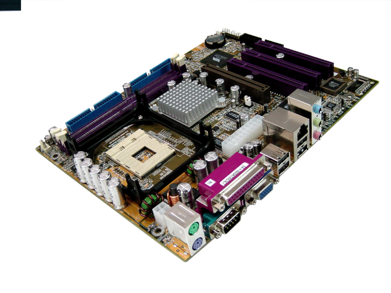

    I recently purchased this motherboard as a replacement for a friends emachine that died. My question is even though the board is very stable and passed all of the burn in tests I noticed that the temperature of the board seemed to be a little high, about 102 degrees f., and seemed to stay there even when I opened the case and set it over the AC vent. I have placed an extra fan in the case, even tried reversing it but the board always reports about 100f. I was wondering if this is a problem that I should be concerned about, and if replacing the heat sink on the northbridge would help? The cpu temp is fine and I also replaced the PSU with a 300 watt Sparkle.

    There is probably nothing wrong at all. Where are you reading the system temperature from?
    If it is from the motherboard reading then it is most likely quite off. The thermistors (or are they diodes?) on the motherboard vary in accuracy, especially when measuring the CPU temperature. What motherboard manufactures do is try to correct the reading a bit by performing a mathematical calculation on the reading. This should give a reading closer to the actual temperature, however sometimes it is still quite off.
    Usually a BIOS update fixes these kinds of small issues. That is if the thermistor is working properly and the reading is very off because of a bad adjustment of the temperature by the BIOS.

      Thanks for the reply, the reading is from the motherboard. I kind of thought that it was ok after researching it, but I wasnt sure. I will make sure that I have the most recent bios for the board.

        abit had a problem a while back where the CPU temp was listed 10oC higher than actual and a bios update fixed it.
