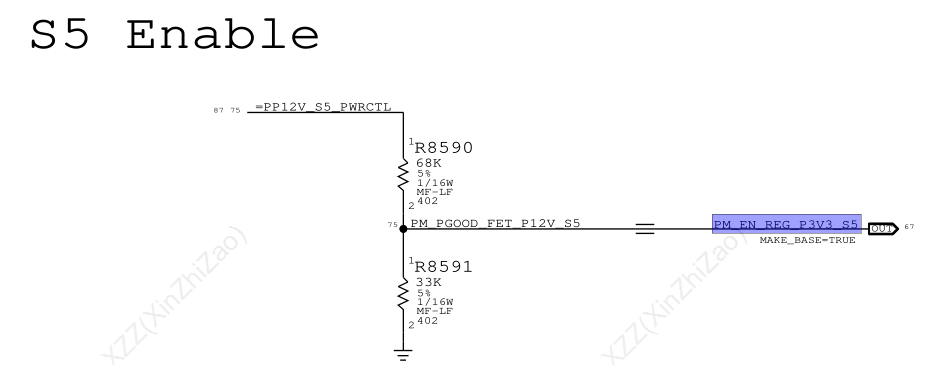

    If you have NO leds enabled on this model, then you are missing PP3V3_S5 to drive the first LED which should be enabled once you plug in the power supply. 'It is plugged in' LED.
    Remove all power. Measure the resistance to ground of PP3V3_S5_REG @ L7610. What is the resistance? If the resistance is low, then you have a shorted part on this rail and this is causing this power rail to turn OFF.
    If the resistance is not low, then check if this rail is being enabled or not.
    Carefully, measure the voltage to ground of PM_EN_REG_P3V3_S5 at the resistor junction shown below - this voltage is used to enable the PP3V3_S5 missing power rail.

      I plugin power supply i didn't get any voltage by PM_EN_REG_P3V3_S5

          Check voltage to ground on other side of the same resistor at R8590.

            both are 0V

              PP12V_S5_PWRCTL = PP12V_S5_FET = 0 volts.
              PP12V_S5_FET
              is created only if mosfet Q8470 (N-channel) is enabled. The gate voltage of Q8470 pin #7 is 0 volts so this mosfet remains OFF.
              Gate is 0 volts because the ENABLE pin # 2 SMC_PM_G2_EN (U8470) is at 0 volts.

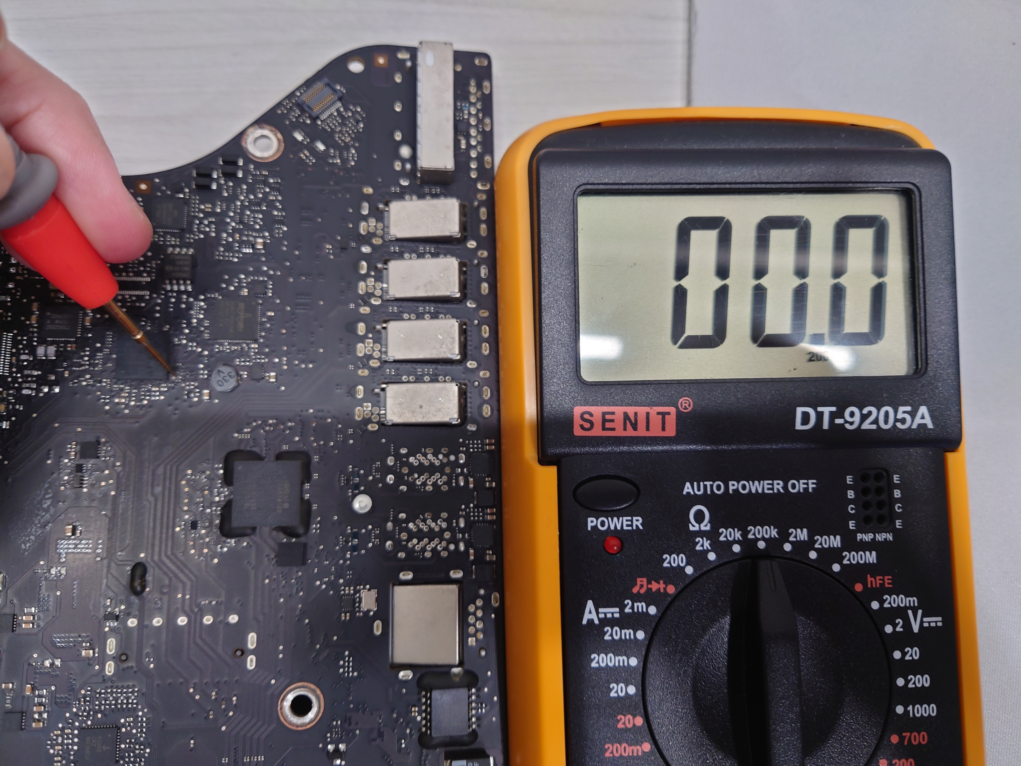

                                    bad news ,when i change new resistance it still 0 ohm , maybe i need to check u8470
                                    • mon2
                                      • Dec 2019
                                      • 14657
                                      Carefully measure the resistance of the replacement resistors while it is on your worktable. Is the resistance ~ 100k ohms when you measure across the tips of this resistor with your meter?
                                      Next, flux and remove the resistor that is onboard @ R5187. After this part is removed, measure the resistance to ground of the PCB pads @ R5187, pin #1. This is to confirm if some other part is showing this low resistance to ground.
                                      Use flux, with low air pressure and enough heat to solder or remove the part.
                                      • okianeko
                                        • Aug 2024
                                        • 14
                                        • 台灣
                                        在工作臺上是 100k 歐姆,但在板上是 0 歐姆。
