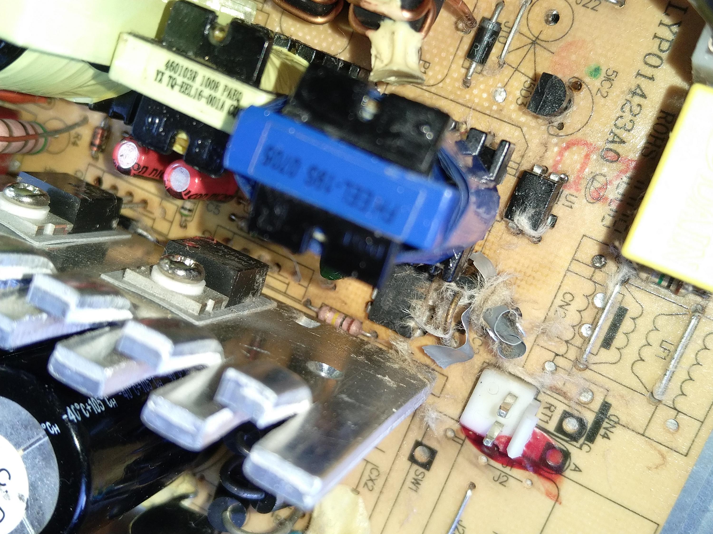

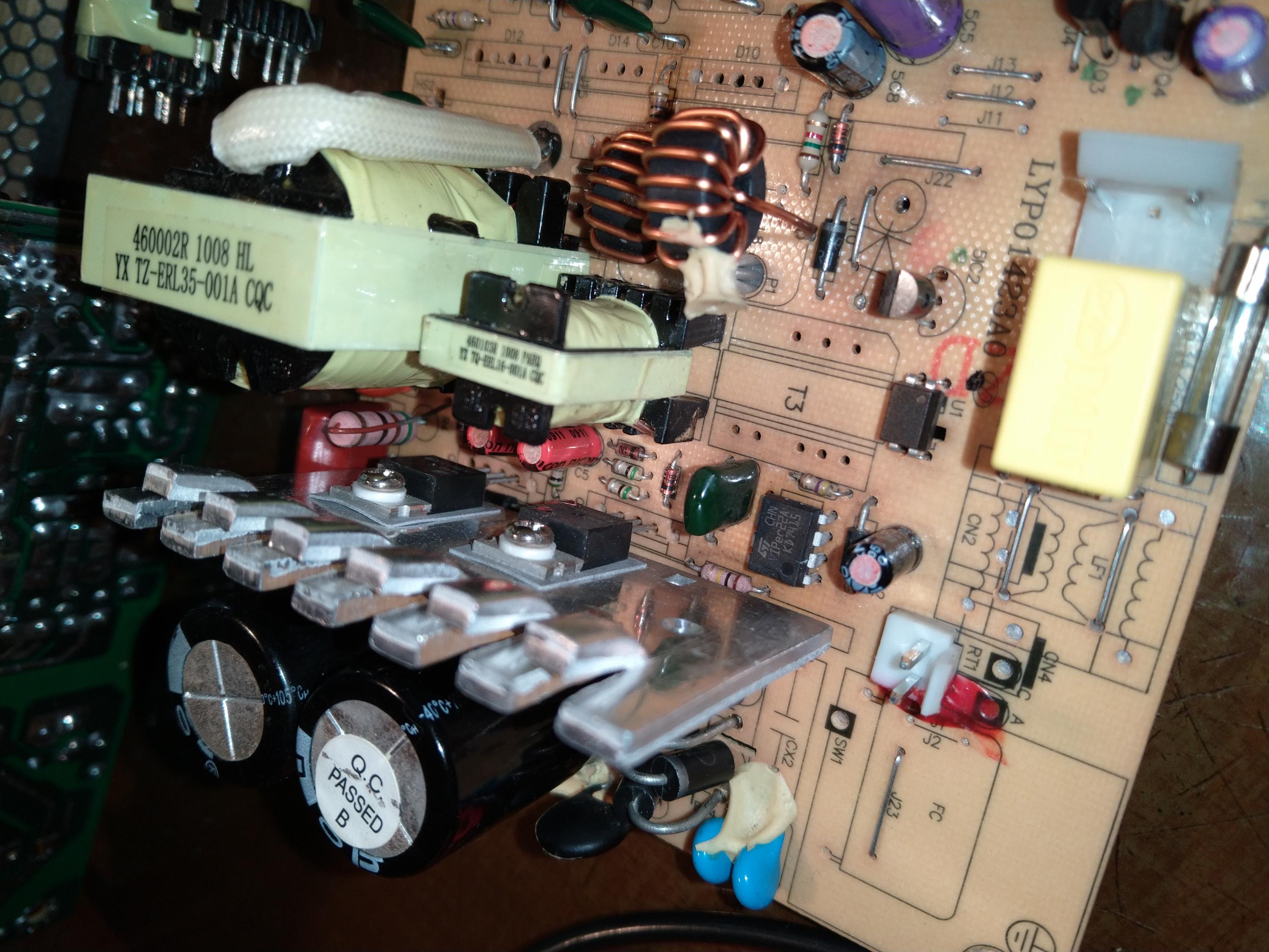

    I got ATX PSU SL-500 PSU. Images Attached.
    It has blown VIPER22A, that I replaced.
    Connected trough light bulb the bulb glows very bright indicating a short.
    I tested every component on hot side of PCB and can't find the short circuit.
    However the problem goes away removing +5VSB transformer.

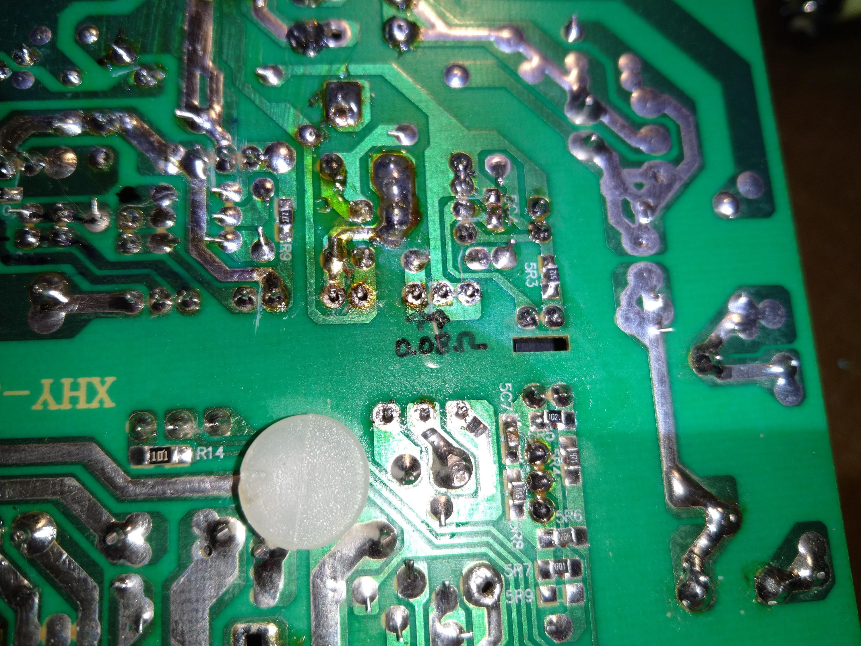

    The winding in questions of +5VSB transormer shows 0.08Ohms, is this normal?

    If you are reading 0.08Ω DC resistance on the primary winding I would say the transformer is shorted.
    A normal primary side winding resistance should be around 2Ω to 5Ω
    Secondary resistance would be normal at around 0.05Ω to 0.10Ω

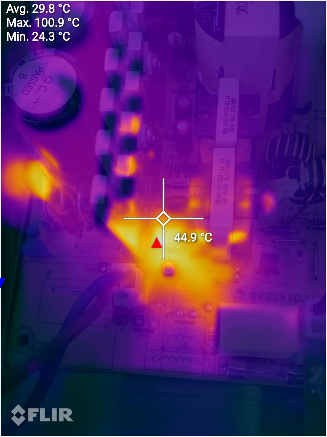

                          I could not find. The VIPER22A was overheating 100deg C.

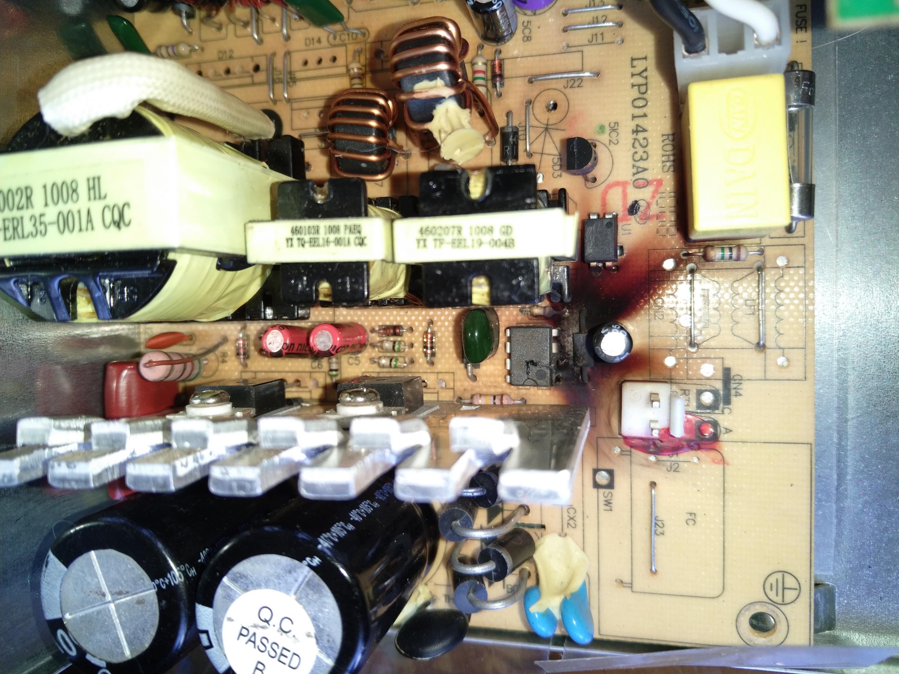

                            Afterwards I decided to see what would blow if I connected direct to mains.
                            This is what blew, magic smoke came from Viper22A, diode next to it.

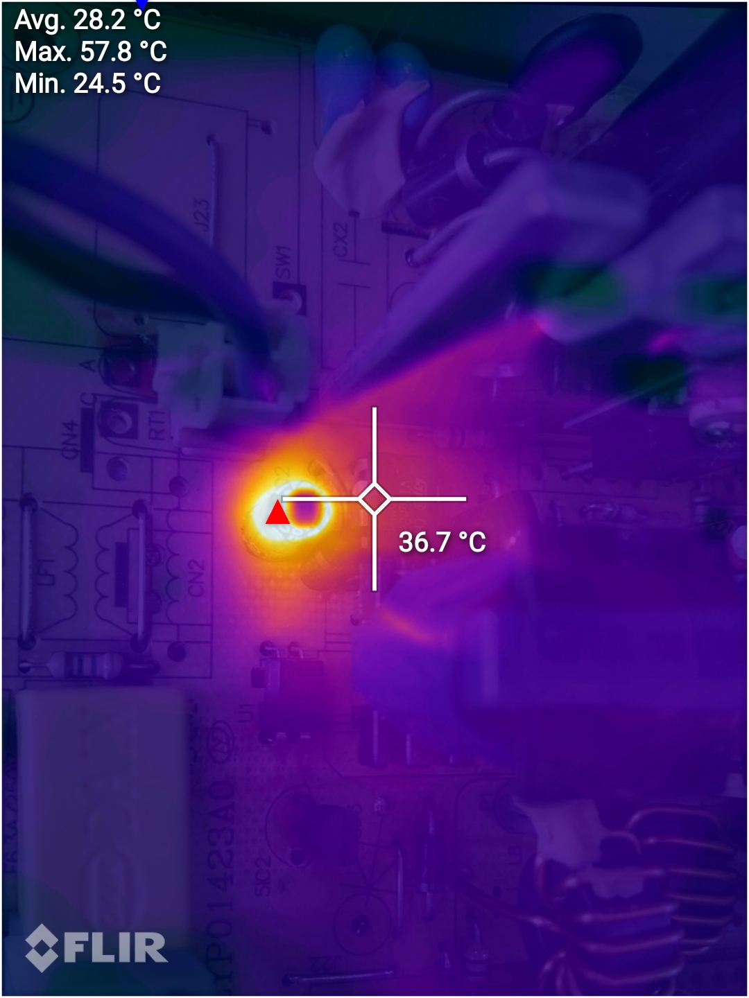

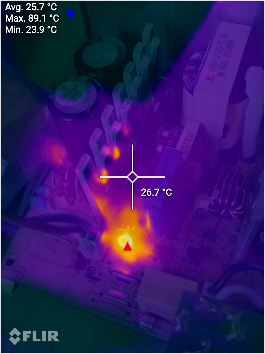

                              I changed the Viper22A and diode from another PSU. The Transformer was also changed (to blue colored one the resistances are not as close to the posted above) as the first one had 1ohm on primary after magic smoke came out from other parts.
                              But after connecting trough the light bulb the thermal camera shows overheating capacitor. Connecting to mains direct makes the cap explode with loud bang
