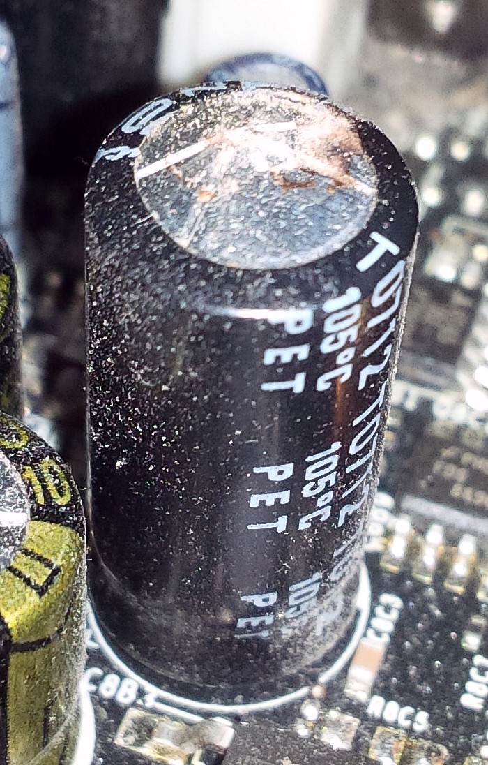

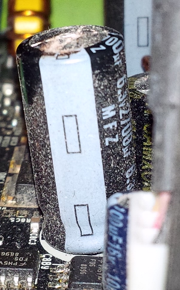

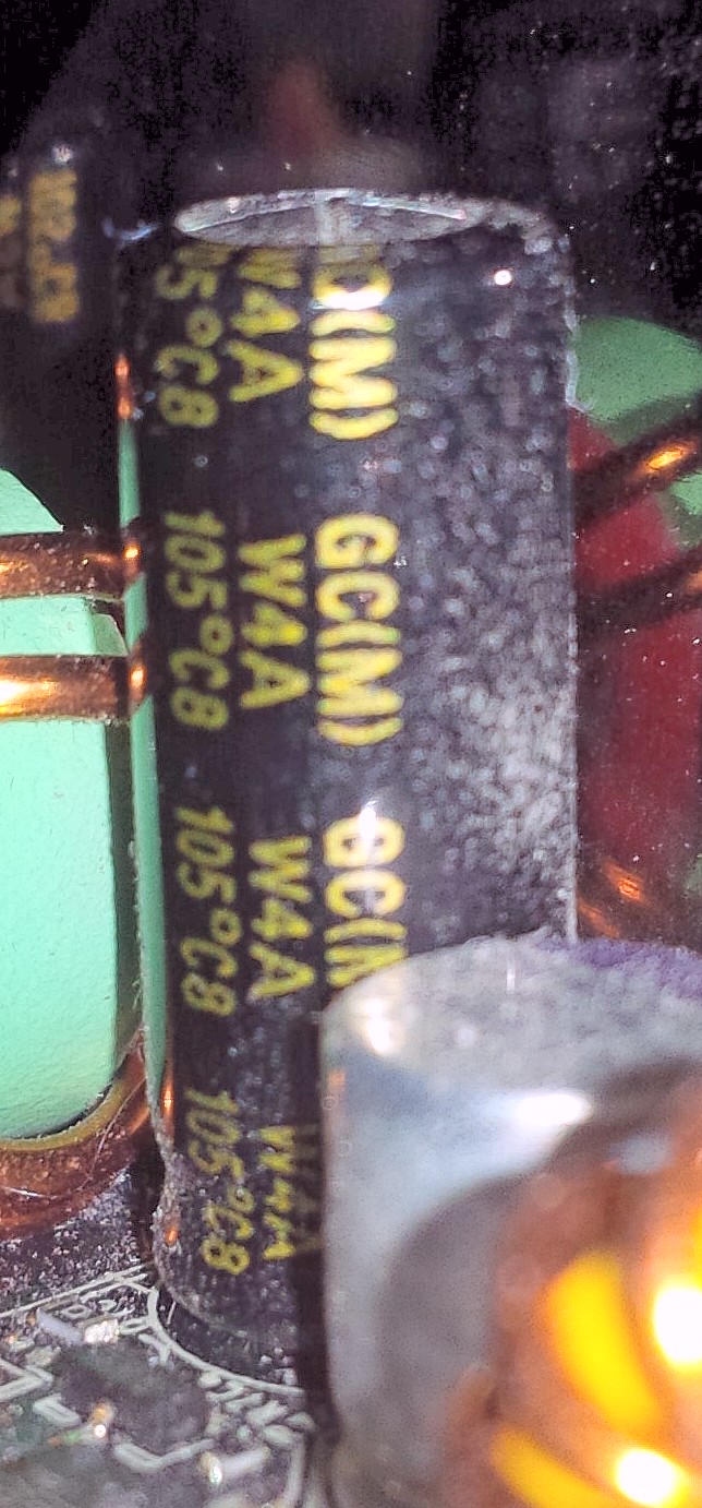

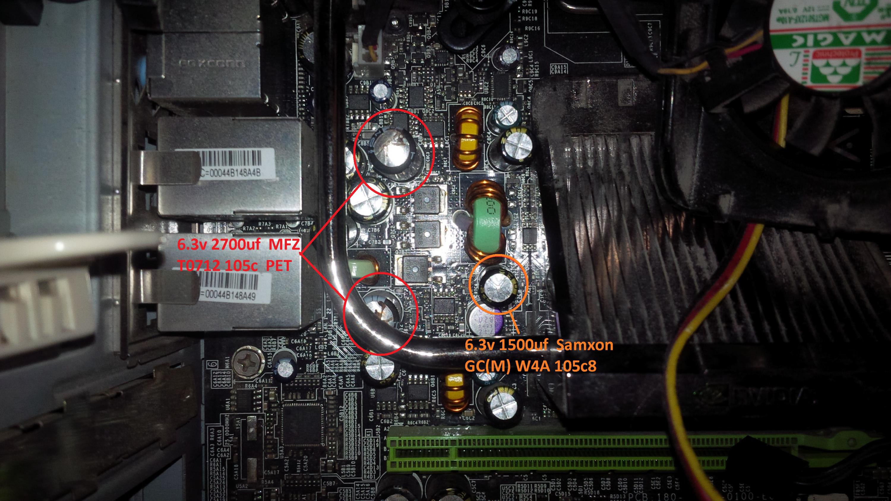

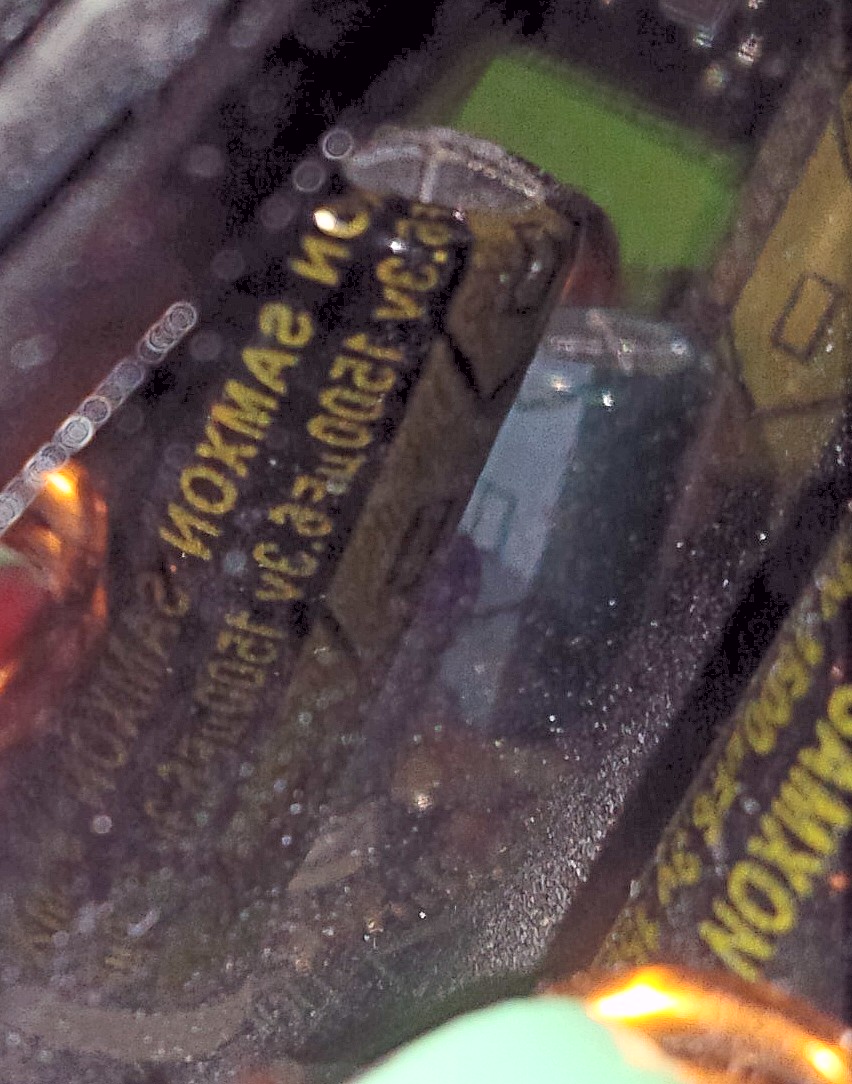

    So I was having issues with my computer lately, tested my gpu/ram, nothing. Formatted, put a fresh copy of win 8 in, still blue screening, stress tested the cpu and found core0 failing, got the cpu today, went to put it in, and found 3 blown capacitors.
    So I just need help finding replacements for them, I think I found them and just wanted assurance, thanks.
    2x blown: 6.3v 2700uf MFZ T0712 105°C PET
    1x blown: 6.3v 1500uf SAMXON GC(M) W4A 105°c8

    Ouch, something must have gone bad to kill a Rubycon like that, even if it is a 2007 cap. If it wasn't a chain reaction caused by those Samxons, check the power supply, as it could be worse in that, especially if it's the original one. I'd be expecting to see a few dead Teapo caps or similar brands in a seven year old PSU...
    If not, maybe Windows 8 really is bad enough to cause hardware to become suicidal.

        It may also be that your overclock is pushing the motherboard too far, making the MOSFETS and coils for the CPU VRM overheat, thus causing the caps to blow. If that's the case, you might have better luck if you replace those electrolytic caps with polymers. However, if the CPU VRM is running so hot that it cooks caps, you may also have to implement something to cool it down (a fan directed down on the board in the CPU VRM area would do). Hot-running MOSFETs and coils are never a good thing!
        Which leads me to this... the problem could also be caused simply be inadequate cooling on the motherboard. Many CPU coolers nowadays pull air from one side and push it out the other parallel to the board. While this does indeed allow for a better overall cooling in the PC case, it may not provide adequate cooling for some of the components on the board.

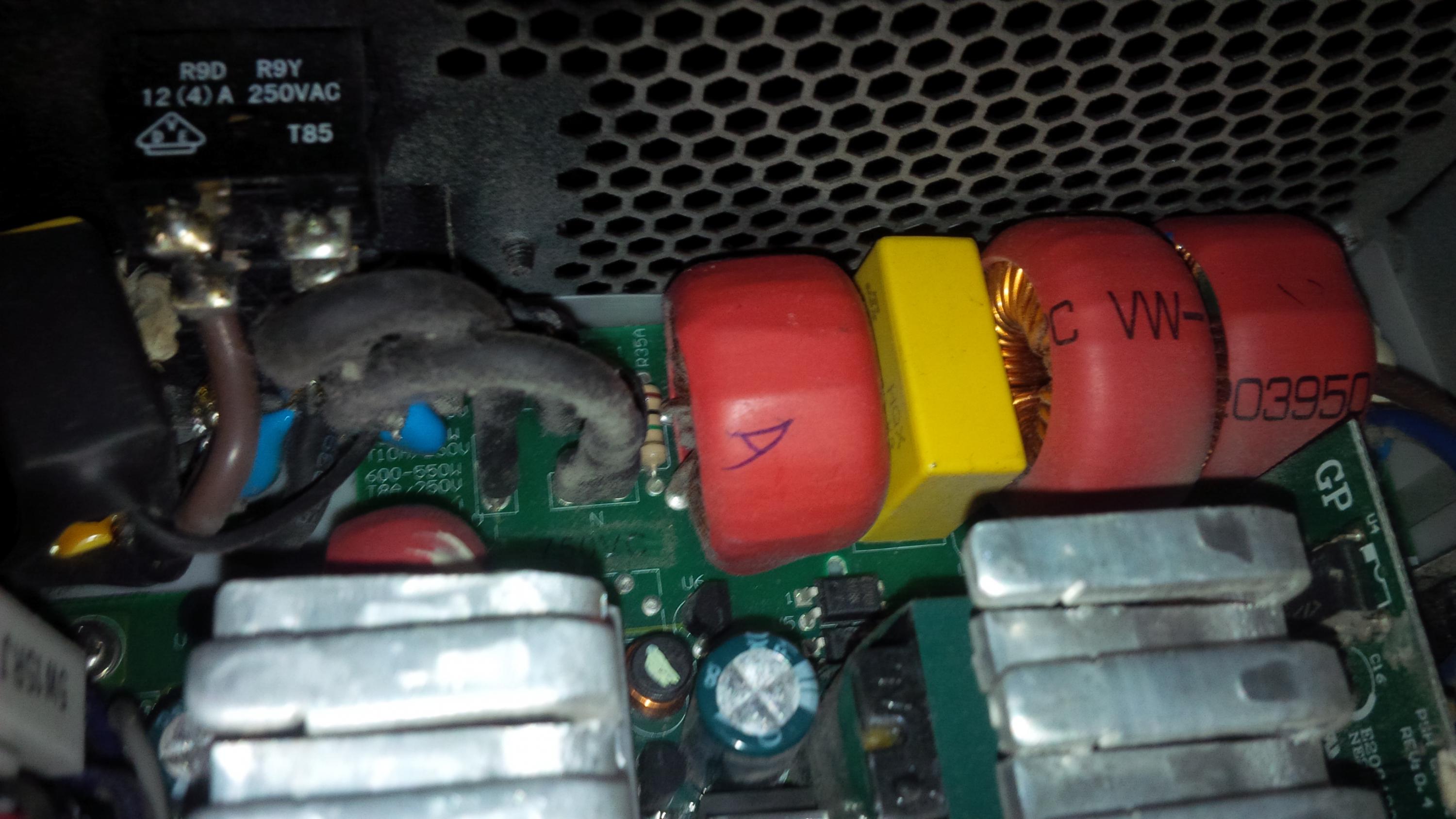

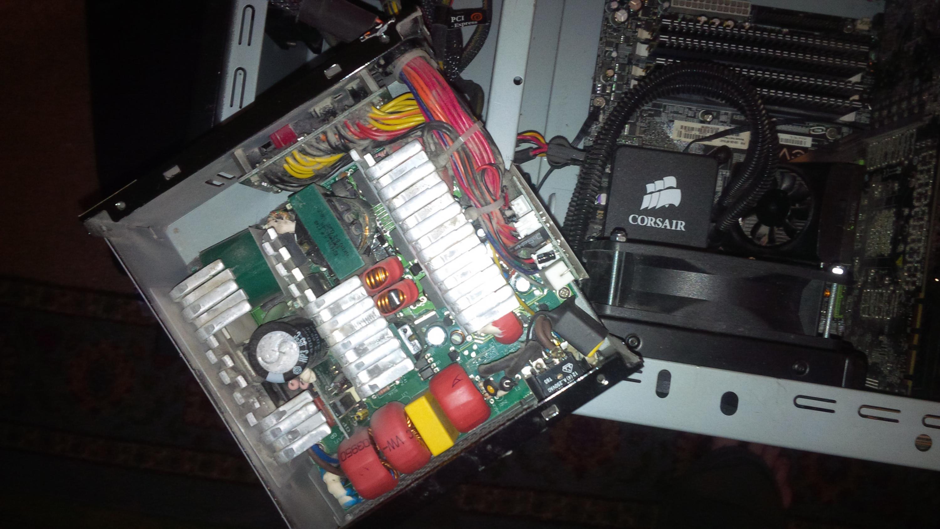

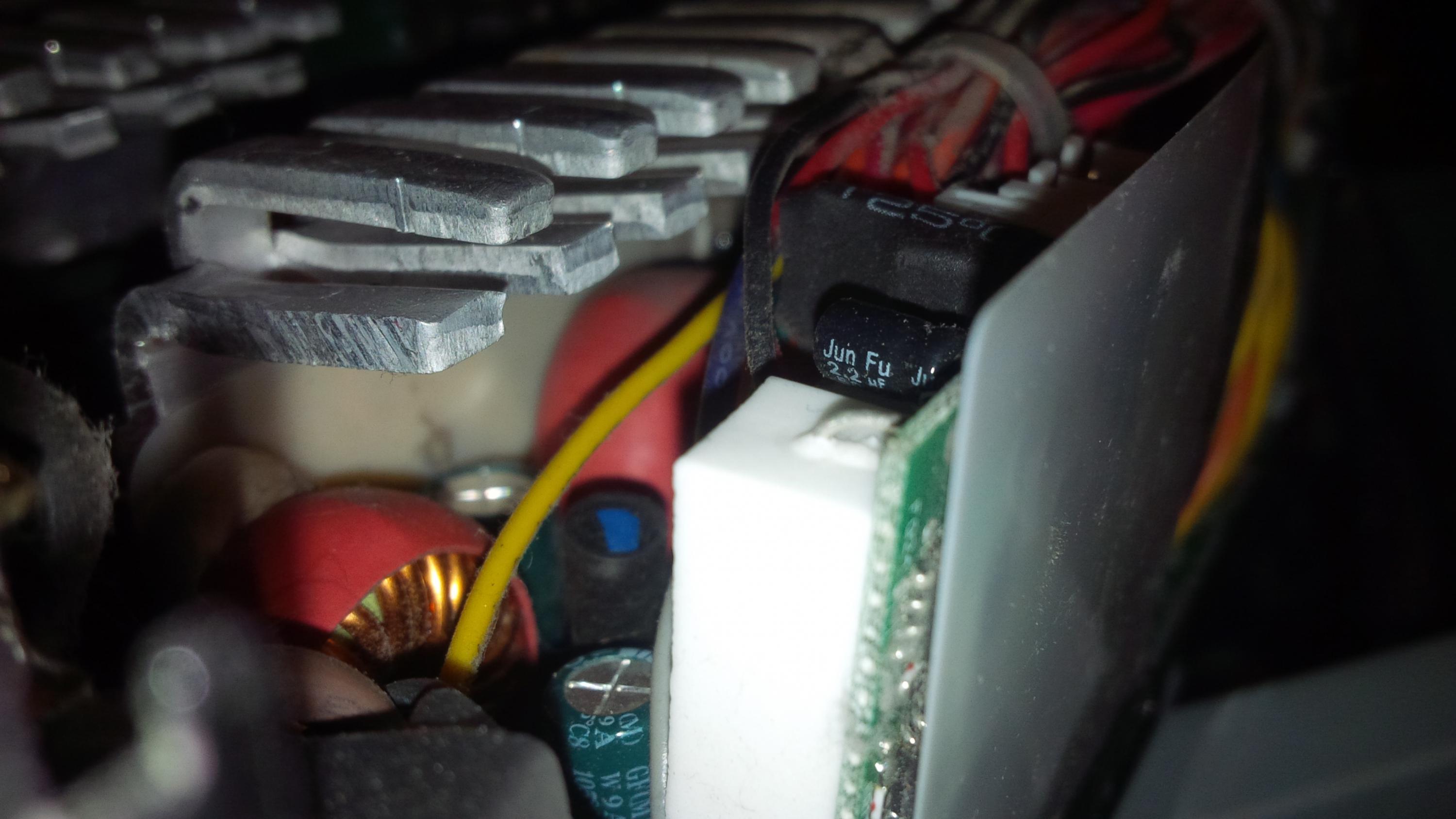

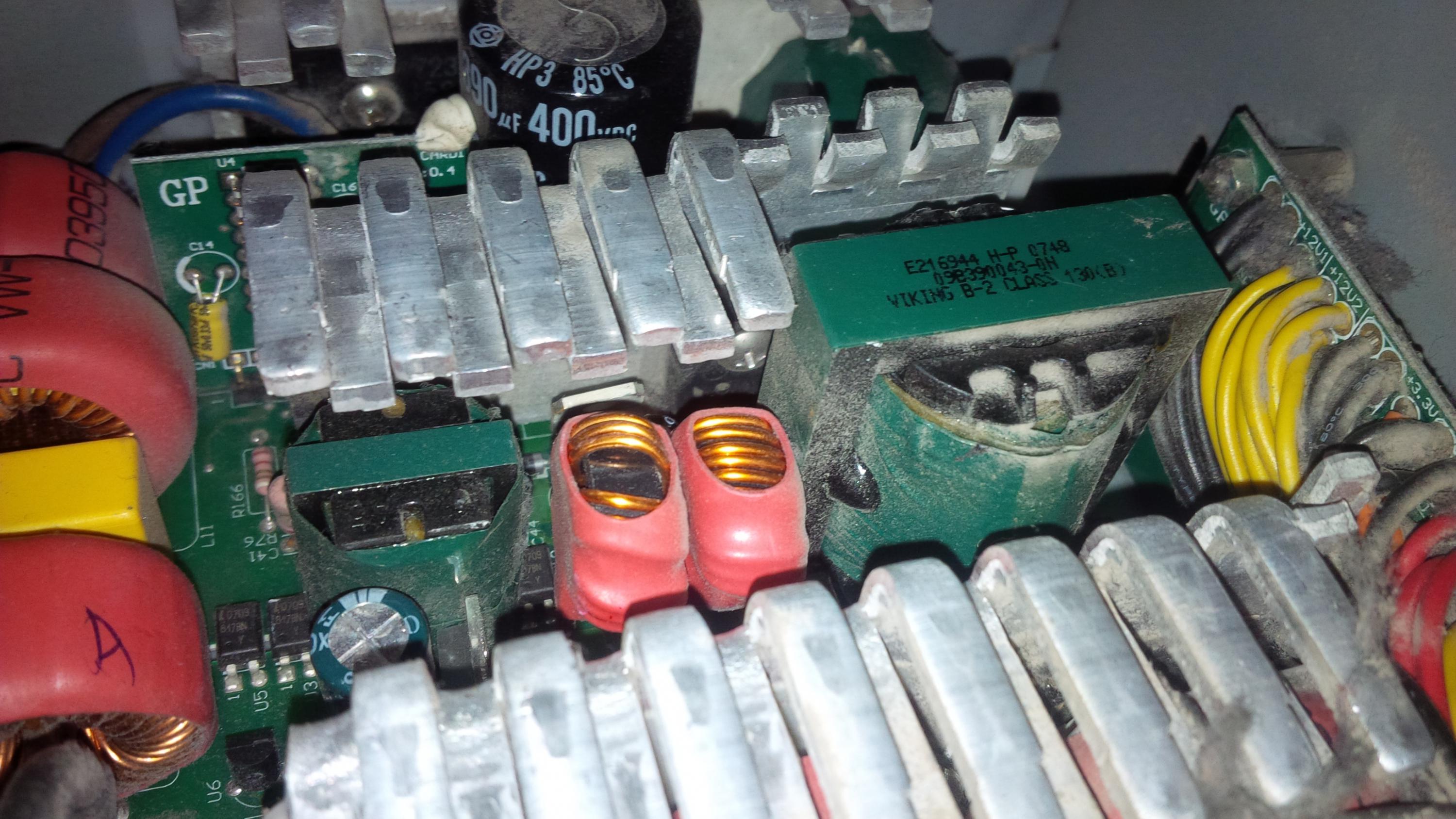

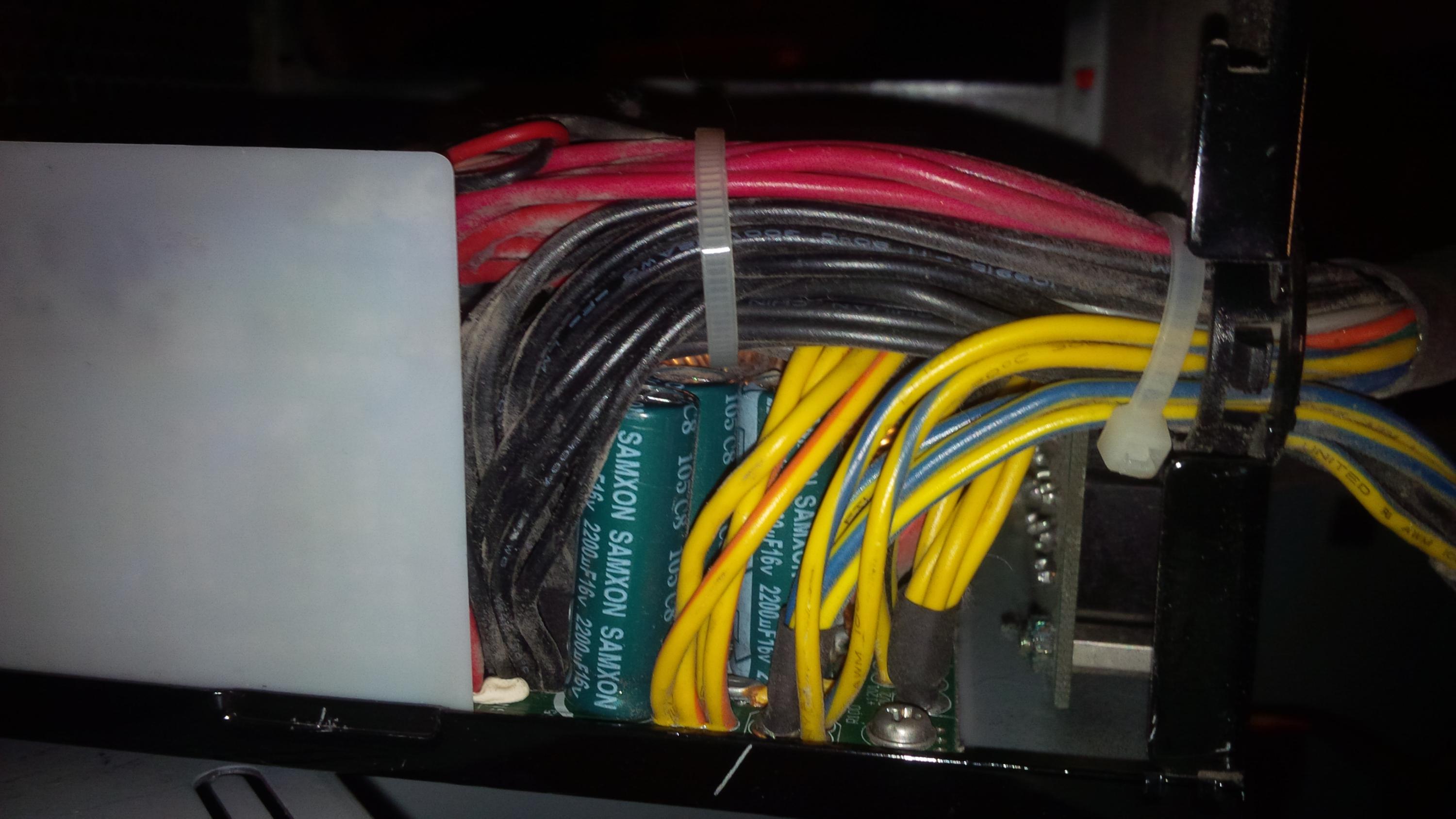

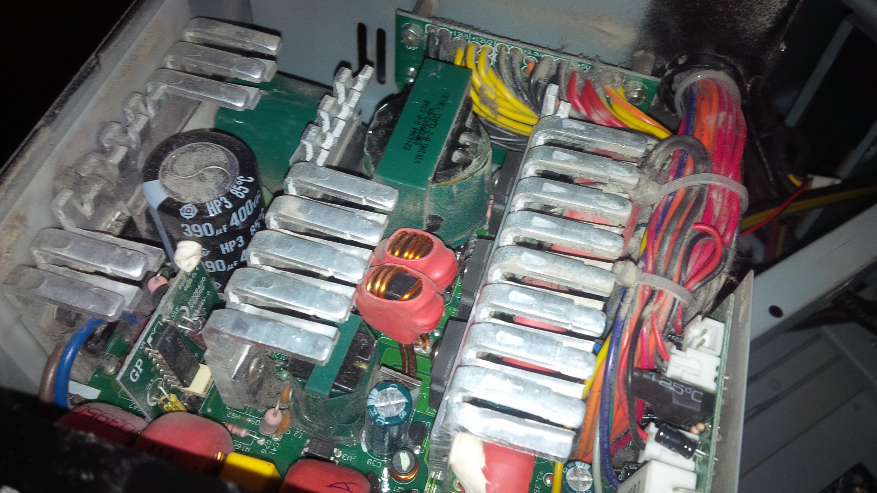

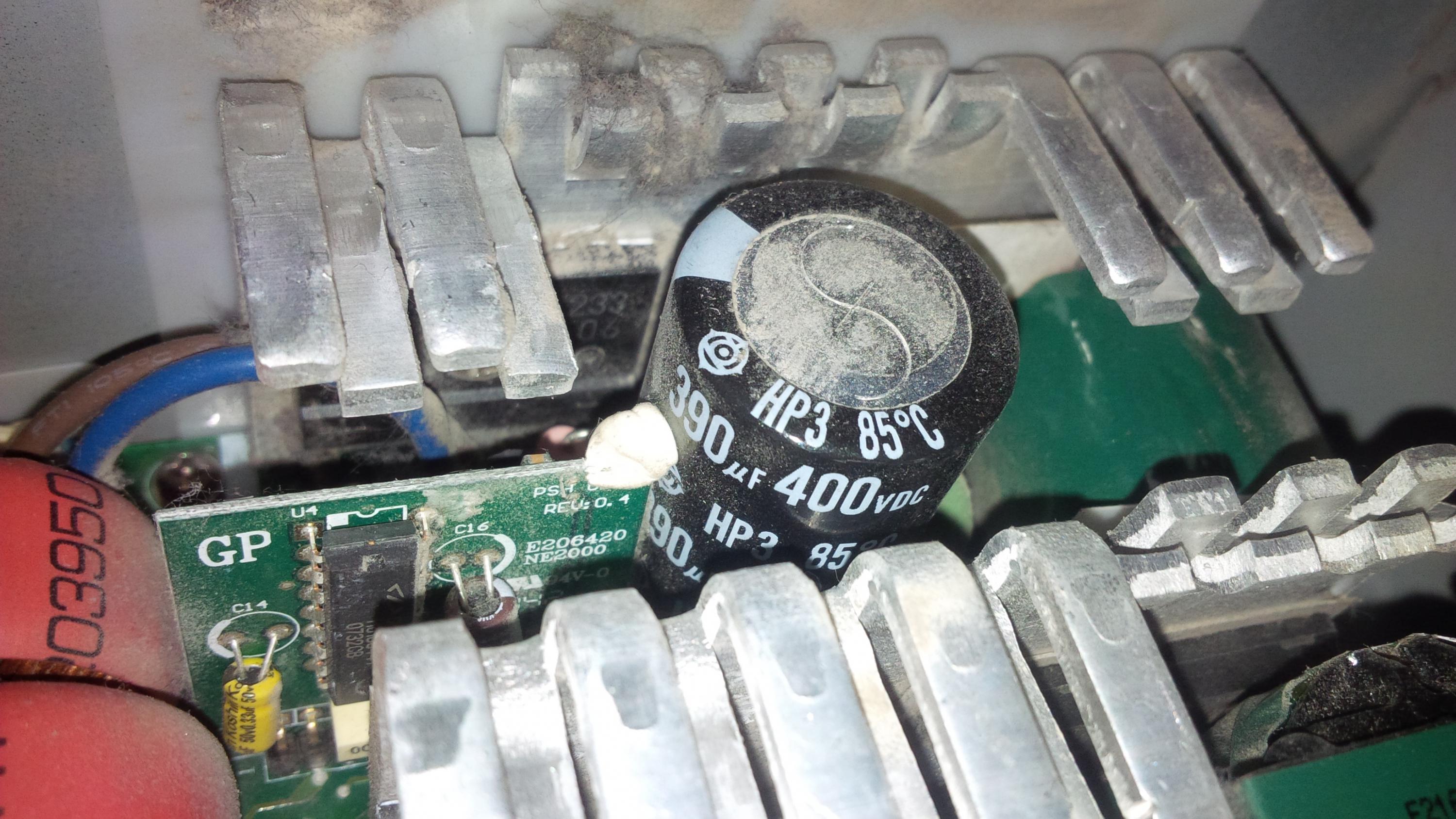

          Ok so I took apart the PSU and didn't find any problems. Here's some pics.
          Thermaltake W0106RU 700W Complies with ATX 12V 2.2 & EPS 12V version SLI Certified 80 PLUS Certified Modular Active PFC Power Supply

            I see many Samxon GF. Not a very good thing. While this may not be the cause of your problem and yours still appear to be good, just keep in mind that they do fail a lot.
            That said, I'm more inclined to think your caps probably failed because of reason 2 and 3 I gave above (or a mix in between). So try turning down that overclock a little or try adding a fan to keep the CPU VRM cool (after replacing the caps, of course).

              Keeping the cpu cool shouldn't be an issue now that I've installed a corsair h60 with in push/pull config, runs around 30c now.
              And the VRM has a built-in copper cooling radiator:
              http://images.anandtech.com/reviews/...i/evga_lrg.jpg

                Re: Need help - 3 Caps replacement for EVGA 780i SLI motherbord
                Just keep in mind that a closed loop water cooler like that removes allot of airflow that would otherwise go over the mainboard.
                On my own system I installed a fan cooling the motherboard for this reason (I have a custom built water cooler)
                Without it the motherboard VRM heatsink got too hot for my comfort zone...
                But it looks like on one of the pics you already have a fan on the VRM heatsink?
                If so you should be good, just make sure it makes good contact with the VRM's

                  If the PSU has Samxon GF, replace those capacitors too, they're horrible anyway.

                    yes as the samxons are on borrowed time.cwt does a good job of selecting crap parts.they have a near perfect track record of it!
