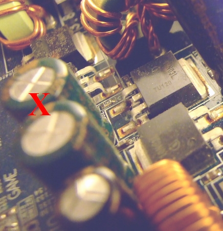

    I just went through the drill on a Gigabyte GA-7VA . Swapped out drives, memory, and a power supply before checking the caps. Believe it or not this thing was still running but would become unresponsive a couple of times a day.

    that usually what most gigabyte mobo's look like when they get here.
    (looks at stack of ga-7zx waiting for recap)
    welcome to badcaps!

        Thats part of the problem, they do run for a while with badcaps but you never know when they are going to lock up reboot or do other strange things.
        So if you don't know about the badcaps situation you tend to blame everything but the Hardware.
        This forum has probably saved a few people from sore ears and going bald prematurely.
        check the MB version by a search here but Gigabyte have used crappy caps so beware
        there a good chance its got them.

          Be thankful those 2x 1200uF caps didn't incinerate themselves. When one shows up with those burnt beyond recognition, plan on replacing FET's too.

            TC a question if you don't mine, is it these two caps you are referring too?
            (That are the 1200 uF)
            I notice they are a different brand
            cant recall what it is thought (green gold writing cover) I think they still fall in to the somewhat crap category if memory serves.
            the others are marked choyo
            Cheers

              gsc or choyo
              both junk.
              i have seen those burn up the vrm when they launch off the board and leak out the bung.

                Starfury, KC8 is correct. Replace them ASAP!

                  Thank you KC8 & TC
                  I was just after confirmation it was those 2 caps marked we were talking about.
                  (to be sure)
                  I have recapped the Gigabyte MB
                  Had blown GSC crap on it and replaced with (as willawake did) Panasonic FM, dont look pritty but works well
