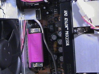

    Greetings,
    After numerous boot failures I finally checked the caps on the mobo and noticed than many had swelling and brown crust from leaking(wendell caps). I replaced all the caps that were 1000uf or larger. Also noticed that two caps in the power supply were leaking and replaced those.
    Now the computer boots(usually) but the IDE seems to be funky. With one hard drive and two CD player/writers attached cottectly it will somtimes boot and show one or none of the CD players.
    So I think I'm done playing with it. I am wondering if there are any known, still available, mobo's available from the 'dark ages' of bad capacitors that didn't have bad caps?? I have an Athlon XP CPU and PC2100 memory that runs fast enough for what I do and I'd like to just find another mobo to slap the old CPU and memory into.
    Also, as I understand the problem with the bad caps started around 2000/2001 ? but how late could these little banes have found their way into computer products??

            SY-K7V Dragon Plus! here. 9 of the 21 Wendell low ESR (black cover with gold writing) 1000uF 6.3V are noticeably bulging. With any luck, I will have replacements tomorrow.
            Symptoms:
            Started with system freezing during heavy graphics. Freezing got worse (more often and during low graphics use). Got to a point of being unable to boot. Odd errors (TRAP 00000006 Exception, No valid boot device, spontanious reboot, etc.).
            I found out about the cap problems on the net by accident (and am glad I did). I'll let you know how things go.

              Ok. I picked up my replacement parts this morning. I will be swapping out the parts after work today and will soon *crosses fingers* have a stable system again.
              Replacement Parts:
              Nichicon HE series –
              The parts are not marked as low ESR or gold writing, but they are low impedance, high reliability and should do the trick.
              UHE0J102MPT – 1000uF 6.3V, 10mm diameter x 15mm height (I forgot to check lead spacing, but these parts are a direct replacement [size and value] for all of the low ESR caps on this motherboard)
              UHE1A102MPT – 1000uF 10V, 10mm diameter x 20mm height (I could not get my hands on enough of the 6.3V parts, so I picked up a few of the 10V equivalent parts to place in non-height restricted areas.)

                  Wow! That took quite a bit longer than I expected. Some decent soldering equipment would have been a 'great' help.
                  I had a difficult time getting the holes free of solder so I went looking for my flux. I couldn't find it so I borrowed my neighbor's tinning flux for sweating pipes.
                  All of the low esr caps were swapped out so I put my computer back together and... no POST. :x
                  Wait! I swapped CPUs... I clear the BIOS and try again... Hooray! POSTing! So I hit DEL to enter BIOS and.... Black screen.... nothing.
                  Ok. Maybe I killed my video card with my previous troubleshooting. Old video card goes in and... POST! Yeah! Wait! What's that? the video is getting garbled! :evil:
                  Bloody hell! I pull the PC apart and get the microscope out to check for solder shorts. *wonders if that flux he used is of the 'non-conductive' nature* So I try to clean the flux off with saline and a toothbrush (the wife packed the isopropyl alcohol for our upcoming move) and inspect for shorts. Touch-up a few for the solder joints and try this stupid computer again.
                  Well... It's been more than an hour and she's running strong without so much as a hiccup. Let the burn in begin!

                            you need to be sure to remove ALL traces of that flux or it will eat away the traces on the board(pardon the pun)
                            it is corrosive!

                              Thank you TC for the caps.
                              I just logged in here with this Soyo machine and it's better than new now.
                              Some of the little bastards dib not want to come out, even with the "wiggle waggle" technique.
                              Hat pin was an excelent hole poker.
                              Pisser when I went to reassemble and the proc wouldn't fit, one cap was too tall, so I layed it down.
                              After recap this machine woke up and detected all sorts of hardware that was previously in it.
                              The TV card, the Dazzle, a slew of USB 2 add on ports, anyway I'm a happy customer.
