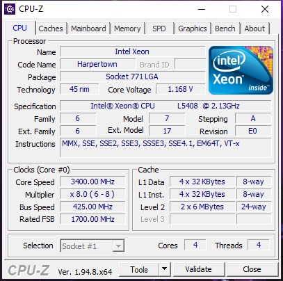

                                      C2D was not stable at all at 3.2GHz stock voltages, it's a bit less unstable at 3.3GHz with upped voltages but nevertheless still fails. I haven't tried 3.2GHz with upped voltage. 3GHz fine at stock voltages however, I think I'll keep it at this speed for now. This processor had been running idle at 55C or so on the stock heatsink on the other machine (µATX PVR+Stock HSF) where it's been running at 45C idle on the full tower case (Full ATX+Zalman HSF). Still don't get why the C2Q is at 35C regardless in the PVR or full atx with their respective HSFs. (The Zalman doesn't fit in the PVR...)
                                      Actually both this 65nm C2D and the 65nm C2Q I had a while ago were quite warm idle according to the onchip temp sensors. Don't know why. The 45nm C2Qs are much cooler at idle for whatever reason. I don't have any 45nm C2Ds.
                                      Now I really need to do something about RAM, just so I can have enough RAM in the PVR for it to be a better compute farm server...
                                      The "stock" HSF I think it's the "mid sized" Intel HSF with copper insert. There is a "huge" one that was for the P4, and there's a tiny one for the reduced power one, and that's the one in the other quad and it still maintains low temperatures until it's pushed, which is expected.

                                        iirc, i believe penryns (45nm core 2) have c1e enhanced halt support so this allows them to idle at a very low tdp. conroes (65nm core 2) dont have this, so they idle at a much higher tdp.
                                          Read my response above again.
                                          In addition to C1E state that Chaos mentioned below, I think most (or all?) the 45 nm CPUs also come with "soldered" heatspreaders on the CPU core, whereas many 65 nm chips didn't.
                                          The idle temperatures are _irrelevant_. You kneed to know if the CPU will stay cool under max (or at least very heavy) CPU load - that is, at least 5 degrees under the rated max T_case. Most Core 2 CPUs are rated for around 65-75C, so you should stay under those temperatures (check the sSpec number on your CPU and see what T_case it is rated for.) Exceeding the T_case will lead to shortened CPU life and instability.
                                          That's the one I would use only on the Core 2 Duo CPUs, despite it being used on some lower-power Core 2 Quad CPUs. In elevated room temperatures, and especially in a PC case (even if it did have good ventilation), you can expect those stock heatsinks to run the CPU near max temperature. So the "mid-sized" ones with the copper insert are only good enough for C2D, in my experience - mostly because in the summer, parts of my house will approach close to 29-30C inside. I've tried running one of my "low-power" C2Qs (a Q8200) one on of these heatsinks in the summer, and it was idling around 55-58C. As soon as I loaded a Youtube video - even on 360p or 480p (which is no feat for the C2Qs... still) - the core temperatures would spike above 60C and roam around 65C. I never even tried pushing that system with a synthetic CPU test for more than a minute, because the temperature would get to 65C after no more than 20-30 seconds and kept going up.
                                          Thus, the "oversized" Pentium 4 / Pentium D ones is what should be used with the Quads, at the very least.
                                          That's terrible. You shouldn't be using that small heatsink on any Core 2 Quad at all - it's not up to spec for it! Heck, it's barely up to spec for a 45 nm Core 2 Duo, and not so much for a 65 nm Core 2 Duo. So on a Core 2 Quad, regardless if it's a 45 nm or 65 nm, you'll be destroying that CPU eventually... unless you have freezing temperatures where the computer is located... then you might be just barely OK. And I'm not making this up - I've actually done a ton of CPU HS tests with LGA775. The small heatsinks are trash for 65 Watt CPUs. Anything higher than 40 Watts will be pushing them very hard. Actually, one of the reasons we started seeing a lot of failed 6th gen and 7th gen i5 CPUs at one of the computer places where I used to work was precisely this - Intel bundled these same "tiny" coolers with many 65W CPUs. And being that the 6th and 7th gen i5/i7 CPUs don't have soldered cores to the heatspreader, they would easily hit 80+C on the core with AIDA64 (some riding right around the T_j max.) Sure, if you never push your CPU load much past idling, it may last for a while. But most of those machines we saw with dead i5 and i7 CPUs were from budget gaming machines (some of them OEM PCs with an added GPU by the user, others built by various e-tailers or custom-built by the user... so it's not like only the CPUs from one particular builder failed), thus suggesting high CPU load killed them over time due to temperatures not being in spec. I actually witnessed one of these CPUs as it was dying - would boot fine and work fine, but occasionally the system would crash... and that's while idle. When pushed with load, it was a crash rodeo. Took us a while to find out the problem, as not a single one of us was expecting the CPU to be the problem. When we swapped the CPU and the issue disappeared, we were like :wft: . Swapped back the old one, just to confirm, and sure enough the issues re-appeared.
                                          Now granted these older Core 2 CPUs are built on much bigger lithography, so they tend to be a little more durable, IMO. But still, I think you're playing with fire (literally) by using those small heatsinks.
