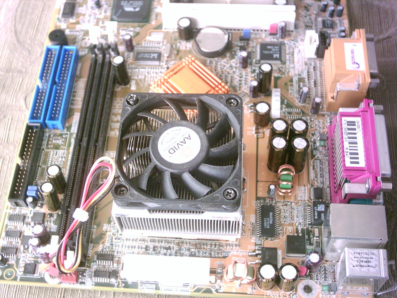

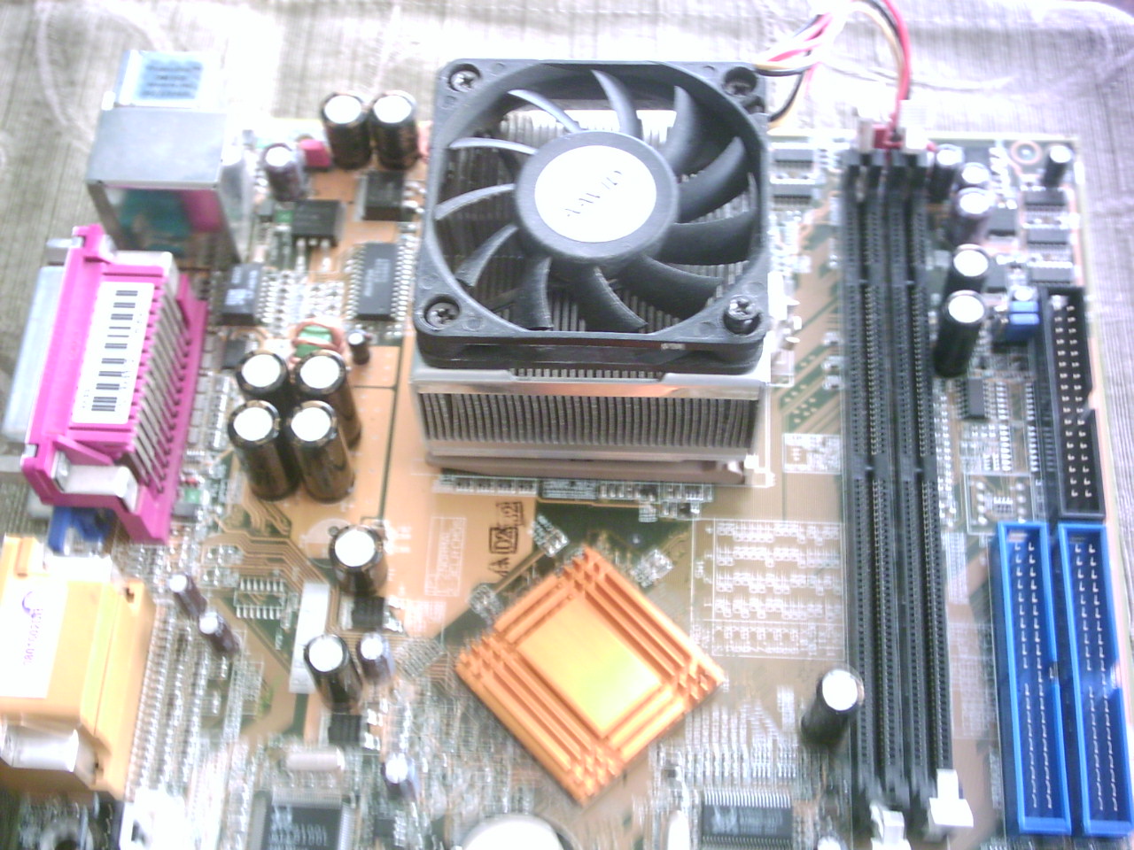

    DFI CM33-TL revsion B

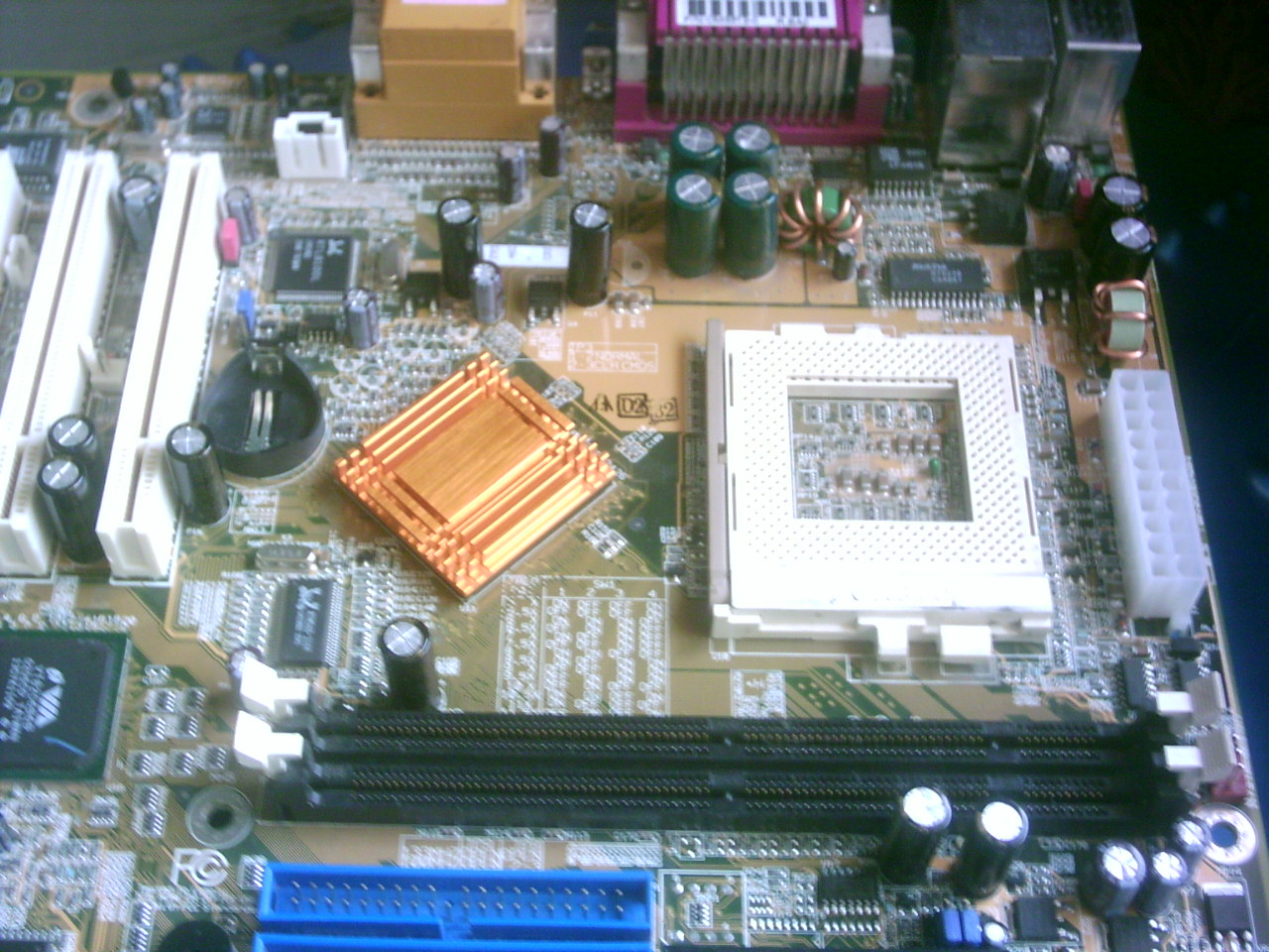

    I was fortuitous enough to be given a DFI uATX socket 370 motherboard today complete with Celeron 1.10A (100Mhz fsb) for gratis, sadly it's populated with G-Luxon & Teapo capacitors of which 2 of the G-Luxon's are visably deteriorated (see pictures below) but thankfully I've still got some SamXon's on hand just the right values, though I'm not sure about the 2700 uF's... I suppose some 3300uF's would do as alternatives

    IMHO, use 3300uF 6.3v instead of 2700uF 6.3v is not a problem if diameter is same.

      As always, thanks Big Pope, I've almost finished recapping it and wouldn't you know it? I've run out of 1000uF both 6.3v & 10v LMAO

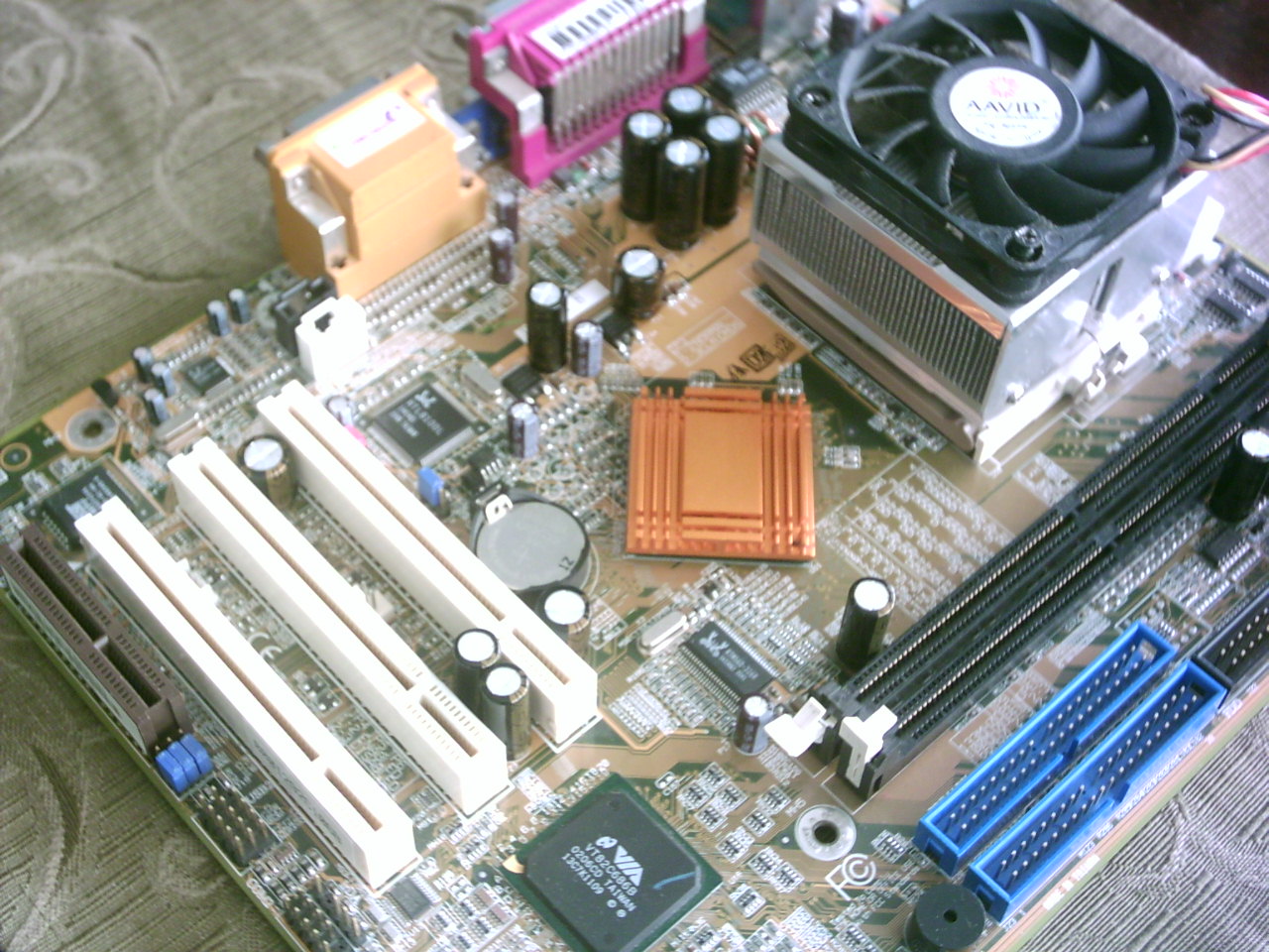

        Re: DFI CM33-TL revsion B
        Well, here's an update... I've almost finished bar the 2700uF's & remaining 1000uF (near the AGP slot)

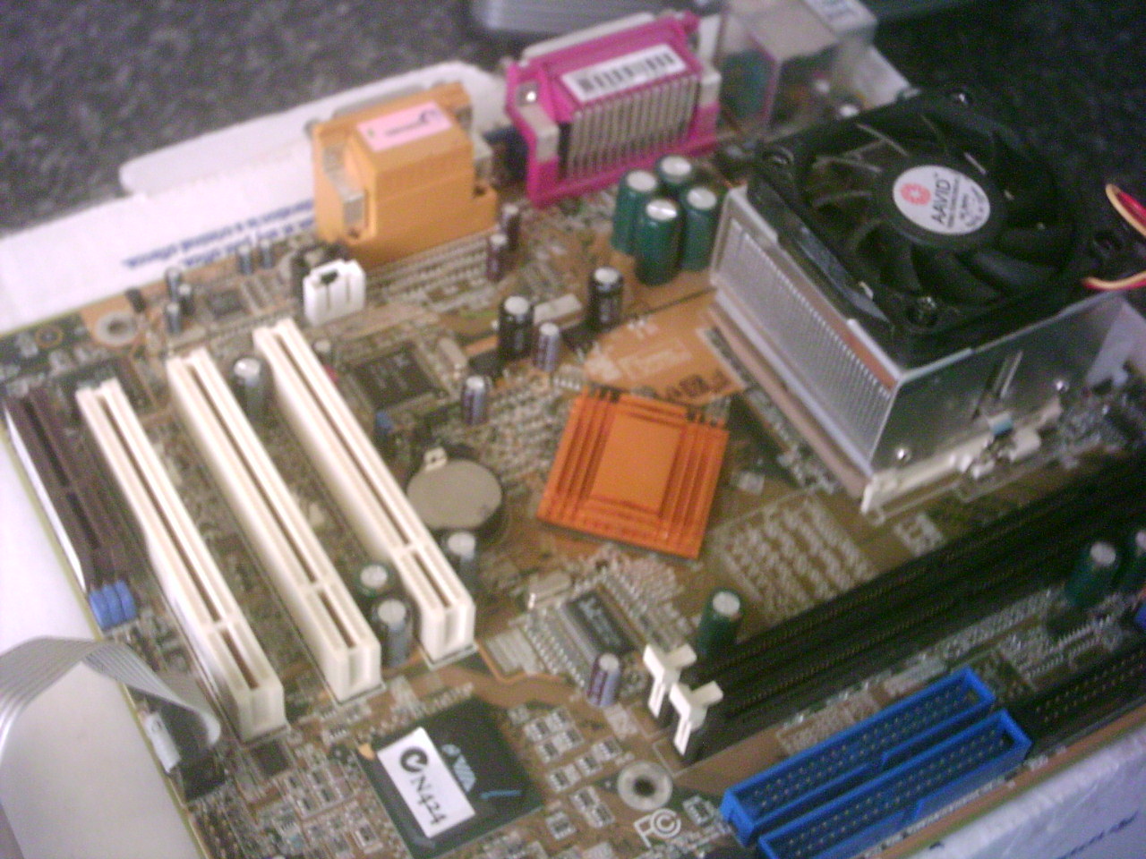

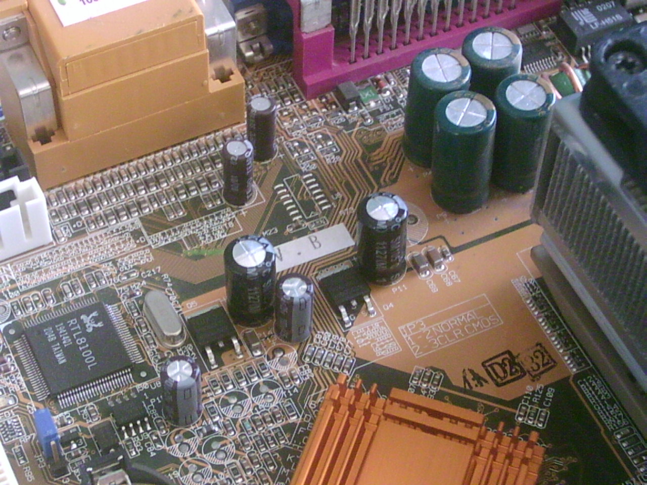

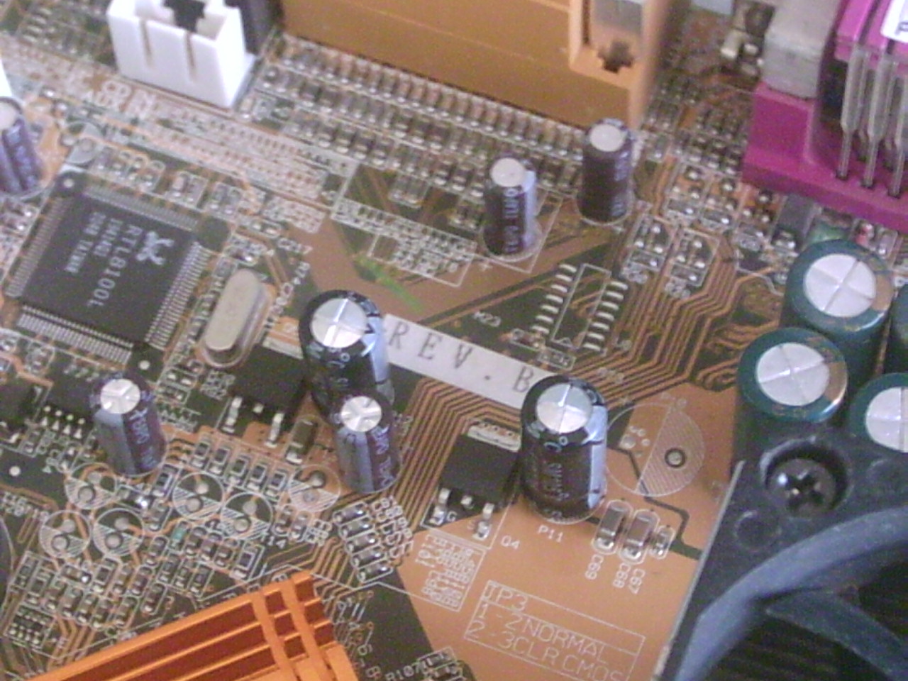

          Re: DFI CM33-TL revsion B - Completion
          Well, here we are again at the end of yet another successful recapping project, sadly I encountered one of those recapper's nightmares here with 2 capacitors coming away leaving their 'legs' insitu making life all that much harder for yours truly
          Practice makes perfect or so I'm told, hopefully such situations will prove less hair pulling in the future LMAO
          Here (below) we can see the finished product, due to my personal supply shortages I've used a wider selection of capacitors to fill this boards quota
          Components used for this project...
          2 x 1500uF 10v SamXon GD series
          3 x 1200uF 6.3v SamXon GD series
          4 x 3300uF 6.3v SamXon GC series
          6 x 1000uF 10v SamXon GC series
          I usually prefer using one supplier of capacitors, it's more asthetically pleasing IMHO
