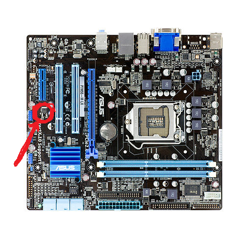

    Hi there!
    I recently got an asus P7H55-M LX mobo, with a missing mosfet.
    The one missing is at position PU203, and I can´t get a high res pic so I can´t identify it, so I´m asking if any of you have one to please tell me wich code does it have.
    To further references, I´m adding a pic with the position of the mosfet.
    Thanks in advance
    Chad.

      Re: Asus P7H55-M LX missing fet
      I have the non-LX version of that board (P7H55-M). It's slightly different, but I think I might have located the equivalent FET on it. On the board I have, it's between the two PCI-E X1 slots. It's a BCD Semiconductors AZ1085D.
        Is the board malfunctioning? What does it do?
        Different revs of the board may have certain parts removed. Are you sure there was a MOSFET there, even though soldered pads are present?
          FYI
          http://diy.yesky.com/uploadImages/20...S_DSC03113.JPG
          UTC UZ1085L
            Many many thanks to all of you!! I will buy (or recicle from scrap) this 3A ADJUSTABLE/FIXED LOW DROPOUT LINEAR REGULATOR and see how it goes... I will keep you updated.
              hi guys! how´s everyone? I have tested with two diferent 1085AD (adjustable) with no luck, fet overheat and the power led light but dim... if I try without that fet power led bright well but I think I have no power voltage as it doesn´t start.
              Does any of you have the shcematic for this mobo? or know how that 1085 should be working? no short on board, maybe a cap is bad or something.
              Any help would be really apreciated
              Thanks for reading and good luck
                check for shorts between ground and the output pad/pin - it may be a bad ceramic capacitor.
