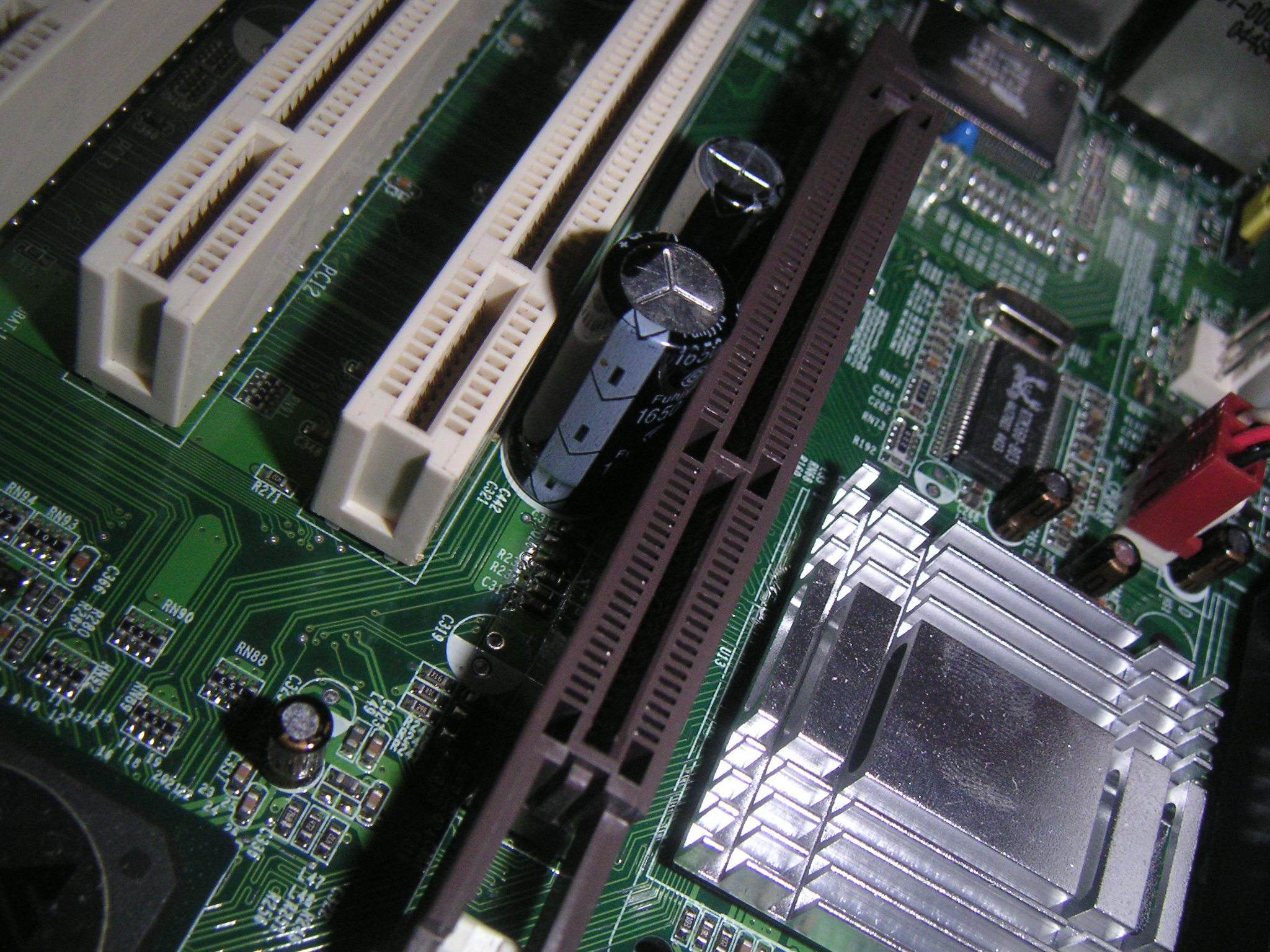

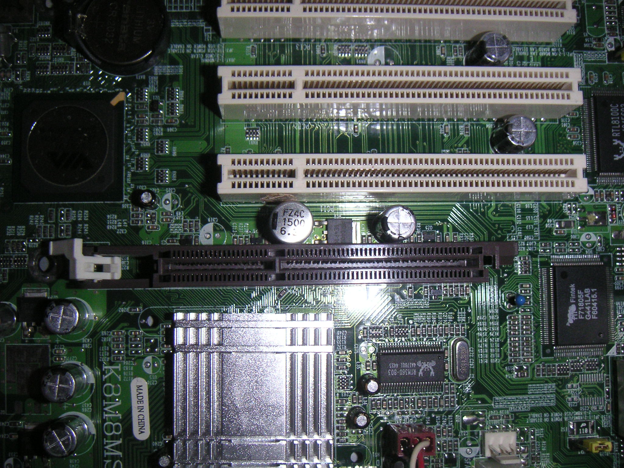

    I rescued a motherboard from the trash (no ram, CPU...)

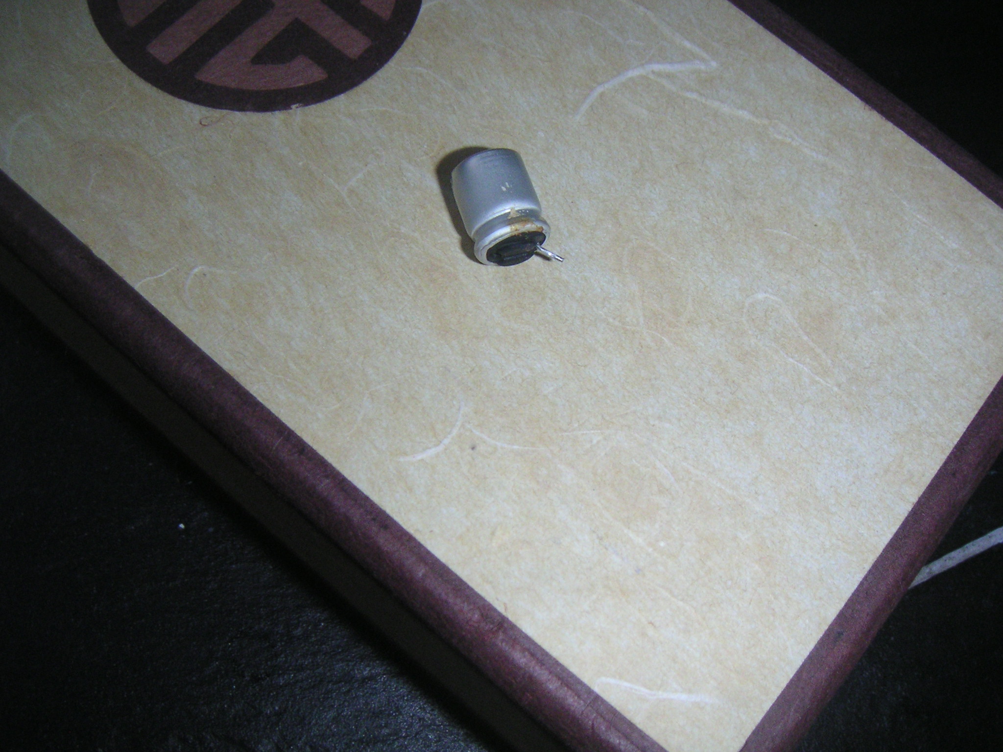

    Two caps were obviously bad ( 1500 µf 6.3V)
    I managed to remove the nasty ones, and new ones were welded back (taller but worked)
    the new ones are 1650 µf 16 V, only had those available.
    Working great now.

    That board has more crap caps.
    Those silver caps look like Sacon.

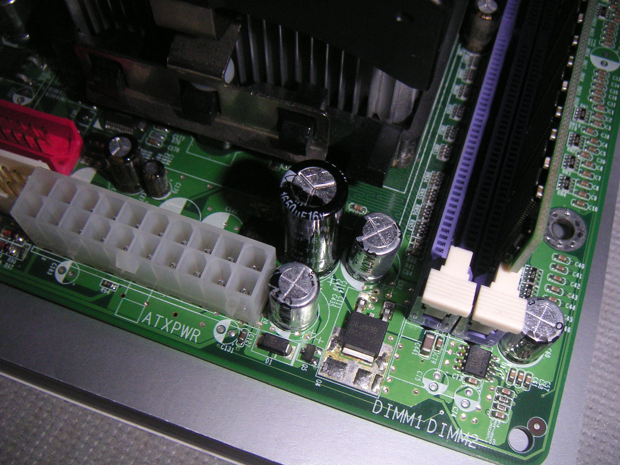

    I also see a f-ju near the ATX connector.

      Sorry to ask, but what
      a f-ju is ?
      Will have a look at those silver caps.

        Those silver caps are junk. The replacements you used aren't suitable for motherboards, and they're poor quality as well (just as bad as the originals).

          Originally posted by bibilit
          Sorry to ask, but what a f-ju is ?
          that black cap next to the ATX connector with hard to spell brand name.
          they're junk too.

            You recapped with Fuhjyyu? Noooooooooo

              Nice job saving it! But even if they weren't Fuhjyyu they wouldn't be suitable, that's a General Purpose cap (TN series). And yeah those silver caps are Sacon...

                Rule of thumb for Jetway motherboards - recap every single frickin' cap on there! Although Jetway motherboards are quite alright IMO, I really don't understand why they always use those crappy GSC/Sacon/Evercon/Gloria caps (all 4 are actually made by the same company). These caps are beyond junk!
                The new ones are 1650 µf 16 V, only had those available.
                Ah, good old Fuhjyyu's out of an Antec PSU, aren't they?
                Could tell even without seeing your pictures. Fuhjyyu is the only brand I have seen to offer capacitors rated for 1650 uF.
                Yeah, like the others said, you'll probably want to get those replaced as well. Not only are they not suitable but they aren't very good quality either. Sooner or later (likely sooner), you'll be back at recapping this motherboard. If I were you, I wouldn't delay it. I have 2 pieces of computer equipment here killed by crappy caps. Not fun to fix.
