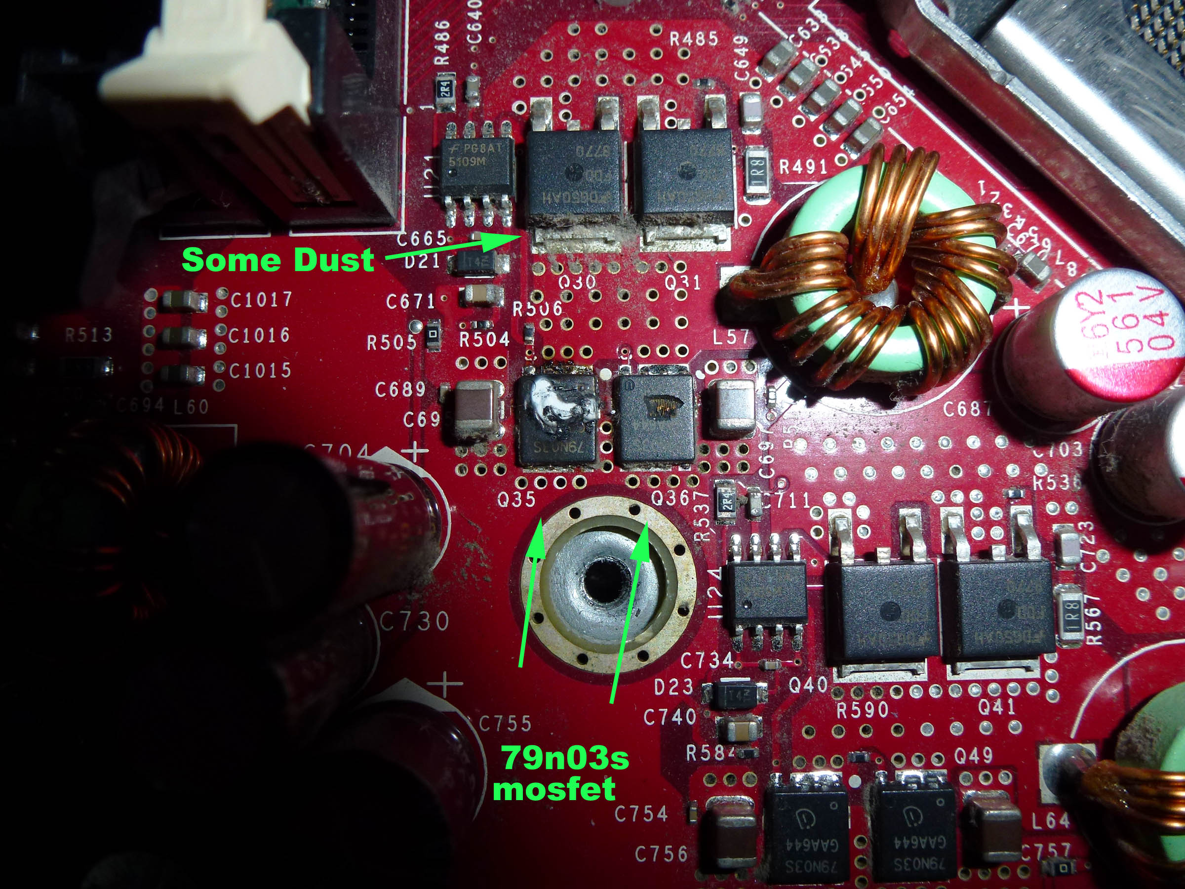

    Hopefully, I will get my photos in here. (attached)

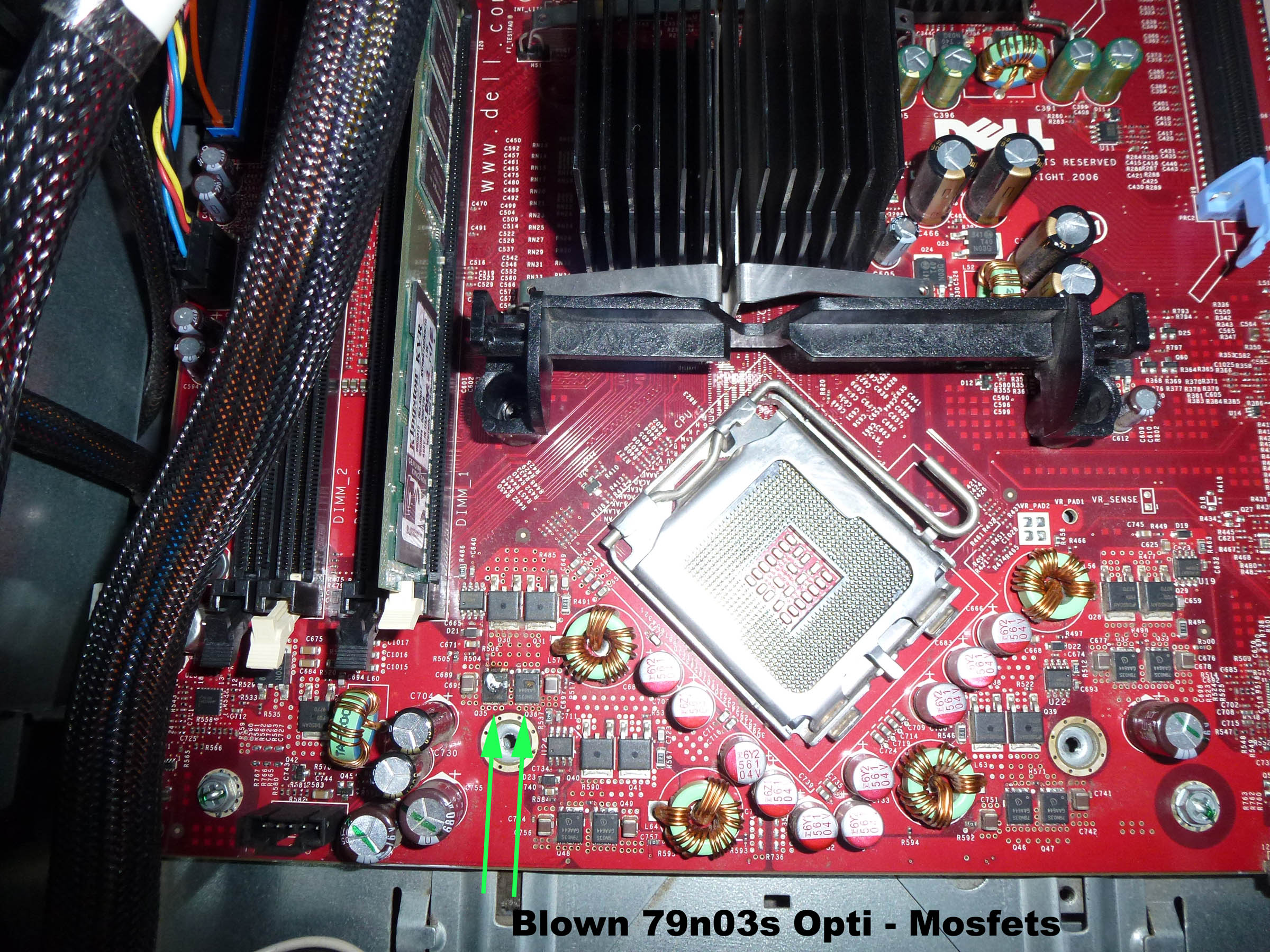

    I'd like to repair this Dell XPS 710 motherboard, that I got not working.
    I don't see any swollen caps, but these two mosfets were nuked.
    They are cheap enough, so I ordered some from Digi-key.
    My question is, am I right in assuming that these burned up from some direct short the previous owner did? They may be used as voltage regulators, but I may be way off with that idea.
    Any ideas why these burned up and what I might do to prevent the next ones doing the same?
    They are labeled as 79n03s and there are a few more pairs of them around the board. The others seem ok.
    Thanks gents.

    Those nearby UCC KZG capacitors may have had something to do with it. Either that or it could have been the PSU. You should have ordered replacement capacitors as well.

        Those two 1000uF black caps near the UCC brown caps - are they TMx or KZJ series? They should be replaced. Not just the ones near the blown FET, all KZG and KZJ. I think it's also routine to replace the small sub-100uF valued caps on these motherboards, depending on what they used. Leave the Rubycon and Sanyo caps, as well as the polymer VRM low caps alone though. Remember, if you're going to test caps, capacitance measurement is useless. You need to check their ESR and see if that's within spec.

          Yup. It's probably bad motherboard caps. Chemi-con KZG and KZJ do often fail without bulging.
          Your PSU is probably a Dell H750P-00. If so, I wouldn't worry about it. Those PSUs are built like tanks.

                    I'll save you a little time... You need a relatively expensive meter to accurately test capacitors. Save yourself time and money, just replace -ALL- KZG and KZJ on the motherboard. In my experience, KZG and KZJ will more often fail and remain fine in appearance externally than fail and show any signs.
                    Please list diameters for the caps and I will point you to the correct replacements that the owner of this site sells. You should also list the series of the small sub-100uF caps. If they're KY or KZE class, leave them alone. If they're SMx or Vx class, replace them too.

                        Yes. Don't turn it on before replacing the caps... Again, I'm reminding you of the small 6.3mm or less caps on the motherboard... One of them that is shorted can wreak havoc.

                          This motherboard's symptoms are high cpu and case fans on power up, but no other indications of life. Power led on board does light.
                          No Dell diagnostic lights are lit.
                          No heat from the cpu (with unplugged fan).
                          No heat from the chipset.
                          No video response at all (tried two cards) no onboard video on this board.
                          Are caps the typical cure for these symptoms?

                            Update, I replaced the bad caps with the ones I ordered and its working like a new pc. Thanks for all of the help guys, Y'all are the best. Thanks a million.

                                I didn't have to replace anything other than the capacitors. I brought all of them, but only replaced the 2 that were visibly bad. I then powered it up to success I'll tear it back down this weekend and change everyone of them. Thanks to the info on this site I was able to bring it back to life.

                                  Uh.... you should replace the MOSFETs.
                                  Otherwise, the other MOSFETs might be getting stressed out from the extra power they have to handle.

                                        They both appear to be BSC079N03S from Infineon
                                        I am not sure if you will be able to replace them though, because you might need special equipment. The reason is because the MOSFETs have a big metal pad underneath that is soldered to the PCB for better heat dissipation and lower resistance. Scroll down to page 8 of that datasheet to see the mechanical drawings ... the one on the right shows the underneath of the MOSFET, and you can see the pad I am talking about.
