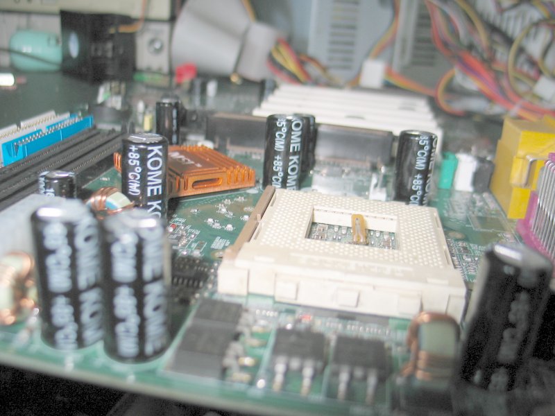

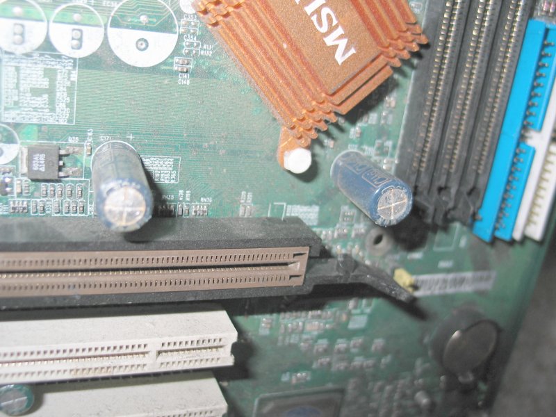

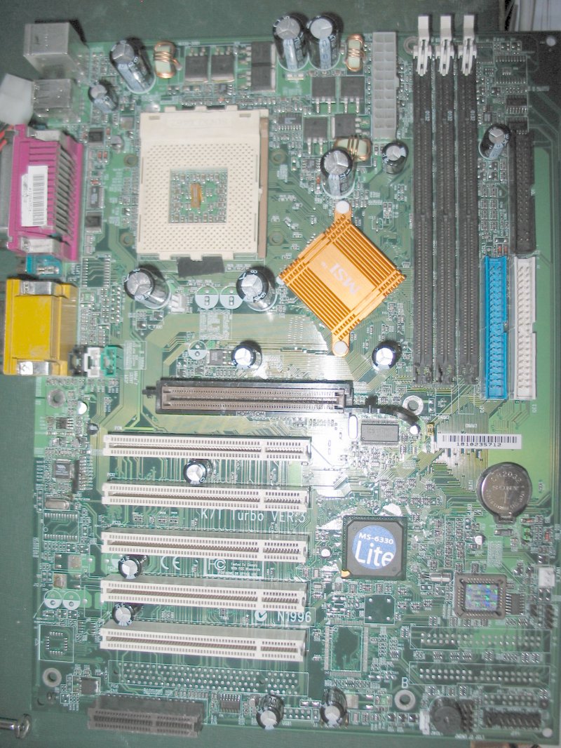

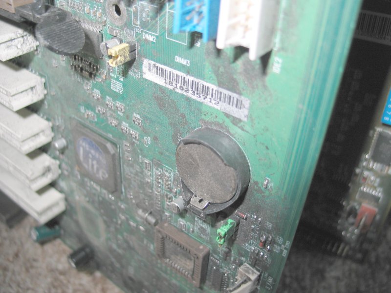

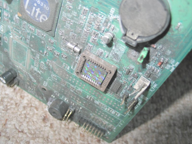

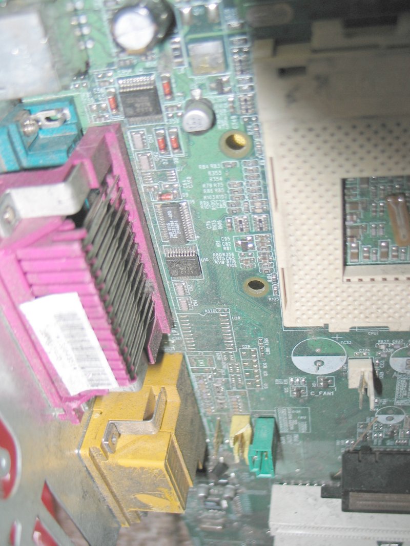

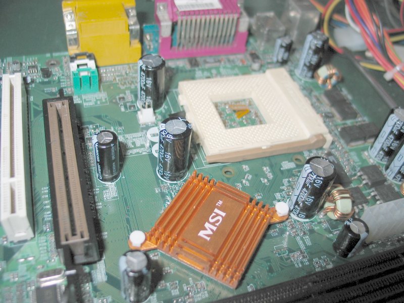

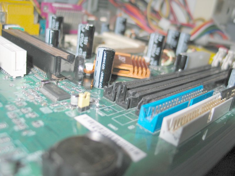

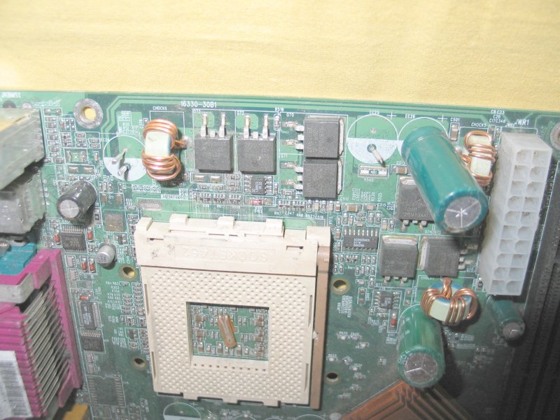

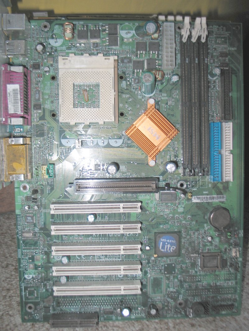

    It's in pretty bad shape - missing caps, bad caps, broken DIMM latches, dirt everywhere... I wonder if it's fixable.
    Dirt:
    More dirt:
    Bent pins:
    Bad Chhsi caps:
    Caps ripped off:
    Even more dirt and broken connectors:

        I got some bad boards, this one was in worst shape of them. After some work, it looks "a bit" better Cleaning, straightening pins, replacing broken connectors, replacing bad caps, fixing broken-off SMD components and a broken trace near CPU socket. Only the DIMM latches are still broken - replacing DIMM slots is not something I want to try now
        It seems to work, I'll test it completely later.

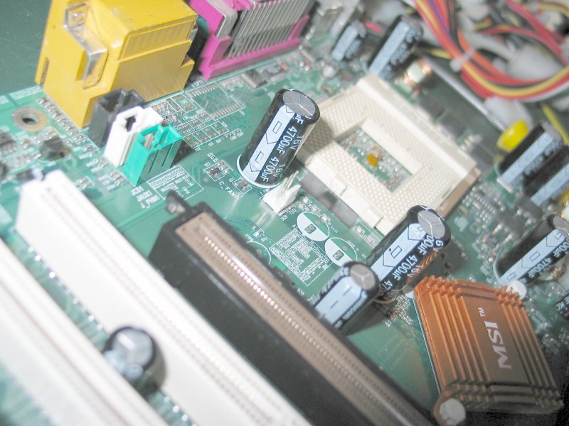

          Hi guys,
          I have a very similar board, MSI k7t turbo v.3 (on the bottom it says "limited")
          The board is red not green. It doesn't appear to have the same cap values either. The two nearest the power connector are teapo 3900 10v. I see in your pics that yours were 4700 16v.
          Someone had it before me and started to replace the other 12.5mm caps with 4700 6.3v (4 of them). He did a real hack job too.

            Re: MSI K7T Turbo v3 (MS-6330)
            I didn't know if MSI put 3900uF or 4700uF on mine. Use 4700uF if you're not sure - they're easier to get.

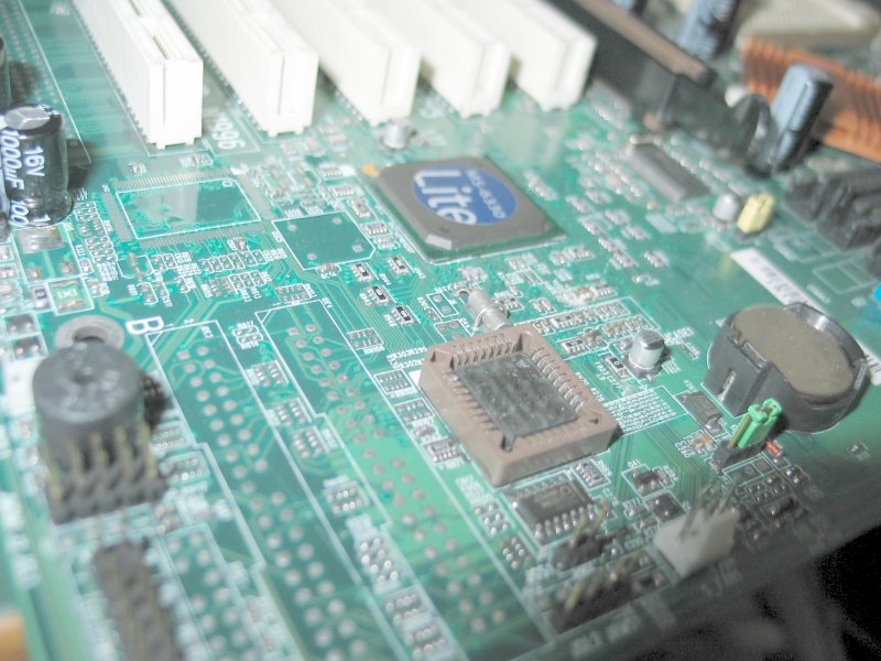

                OK so I thought I had it all figured out
                The capacitor between the floppy connector and memory banks has 3 holes??
                Unfortunately when I got the board it was missing a good # of caps including this one.
                This thread in our forum indicates that it's a 1000uf cap. However it's hole diameter is different than all the other 1000uf cap diameters. This isn't making any sense to me.
                https://www.badcaps.net/forum/showth...&highlight=k7t
                Does it matter which hole I put the lead through? I assume it does but they seem to be so close that they are connected?
                  The 3 holes and different diameter silkscreen is normal, used for options of different sized caps. The 2 holes close together on the white side are connected, you can use either one. I have a couple boards that have 2 different size 1000uf caps.

                      Check traces around the CPU socket - they can be easily damaged when installing/removing CPU heatsink.
