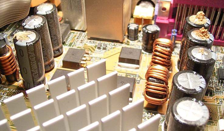

    Here's my Horror Capinet:

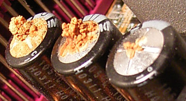

    It's the infamous Nichicon HM(M) series...
    Looks really bad, doesn't it? And I even have already removed most of the stuff some months ago, it just kept coming again.
    The weird thing is just that my system is still running stable (albeit from the usual Windows problems). It's basically running 24/7 and I haven't experienced any instability so far. No blue screens or freezes.
    Should I replace the caps nonetheless? Can they destroy the mainboard completely, or damage any other computer components, due to wrong voltages for example?

    thats got to be the worst accumulation of crud i have ever seen on a vented cap.look for ant trails near the system as i think the hills are on the caps :-)
    i would replace those asap while it still runs.might cost you the board and cpu if you let it go too long.

      Re: Asus A7N8X Deluxe - 6 bad caps, but board still stable
      Yeah, I'll do this. Better some work now, than a dead PC later.
      I'll just have to search a new home for my ants...
        buddy,
        is that a version 2.0 or a version 1.X board. These problem don't seem to occur on 2.0 boards only on 1.X boards.
          Nope, it's definitely a rev 2.0 board.
          But I was also wondering why I have these Nichicon HM(M)'s on my board anyway. Reportedly they have been mainly used in Dell, Intel and Apple boards.
          Probably I have caught some minor edition.
              Mine failed also, Nichicon HMM, I also had some smaller 1000uf caps fail above the memory slots.
                Alex,
                are all ur ost still ok? Only the nichicons failing? It seems funny because most failed nichicons were on rev. 1.06 boards. Can u tell me when u got the board? I have an A7N8X DX as well and nichicons still ok but i am doing 12 hrs per day on the machine. BTW. I got mine in Oct. 2003. U might have the newer batch of a7n8x.
                Better recap them fast. United Chemicons KZG/KZJ should be good nuff.
                  Well, those pics seems to cover the rumor that those caps have got a little too mutch elektrolyt during production.
                    Originally posted by nsx29
                    Alex,
                    Yes, it seems only the Nichicons are bad, all others are OK.
                    Got mine around June 2003. I think that's when the first rev 2.0's came out.
                      Yes, I read that, too. That's probably the case, rather than bad electrolyte.
