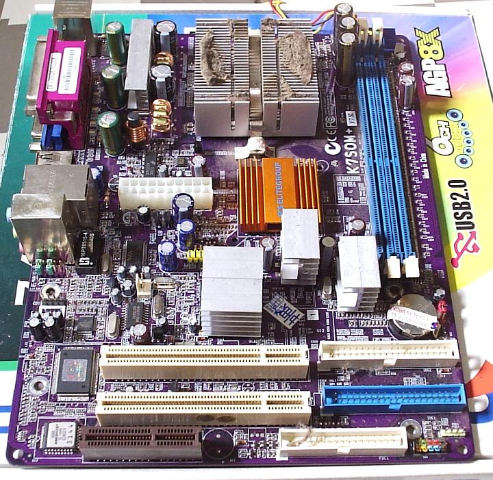

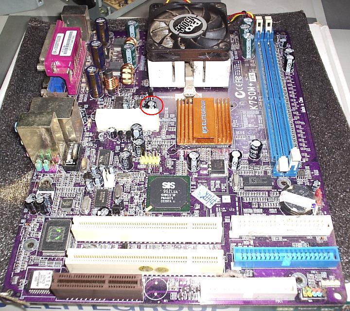

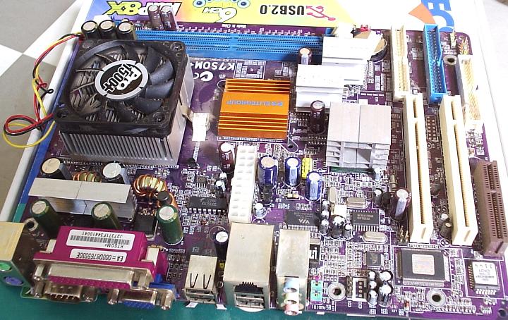

    ECS K7SOM v7.5c
    Only one badcap, although it's only a slightly bulging that my camera cant catch. Odd place for badcaps though. I've seen another version of k7som with OST caps on the vrm input and one is bulging and leaking .
    This one come with Fortron FSP300-BT packed with three Jamicon TM 4700uF and one Teapo SEK 3300uF on the secondary side. They are all fine.

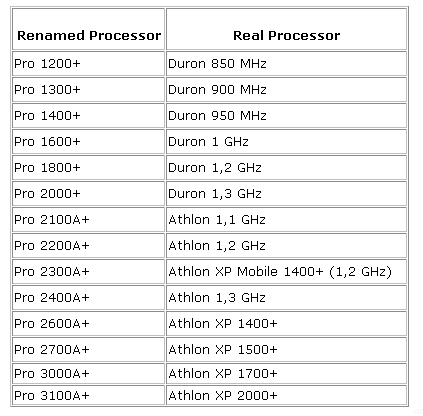

    ECS marketed it as ECS K7SOM with onboard AMD Pro 1500+. That's a misleading advertising that i fought in some Indonesian Forum. How come a Duron 850Mhz be rated as 1500+ ?
    There are also some ECS mobo with PRO (Processor Onboard) 3000+, 2600+, 2000+... you may guess what are the actual speed of those AMD proc, probably half of the rating. This way of fake rating is very succesfull and ECS become no 1 selling brand in Indonesia.
    They who aware on this is not even 1% of the population and computer magazine is just silent or only made not so deep article about it.

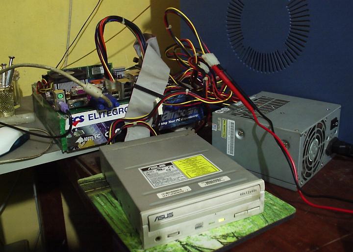

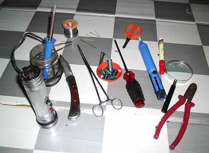

    My tools:
    Probably from all known member on this forums, i'm the one with the least tools here . Look at my soldering iron, it's a 2-year-old-still-good-cheap-$8 Goot (taiyo) 30W soldering iron, definitely a good quality stuff. The tip is another $3 japan made.
    Digital Multimeter to check the vcore and psu rails voltage after recaping:

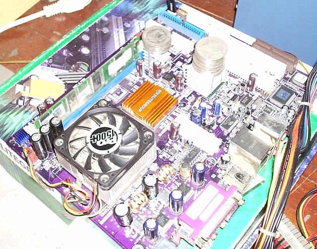

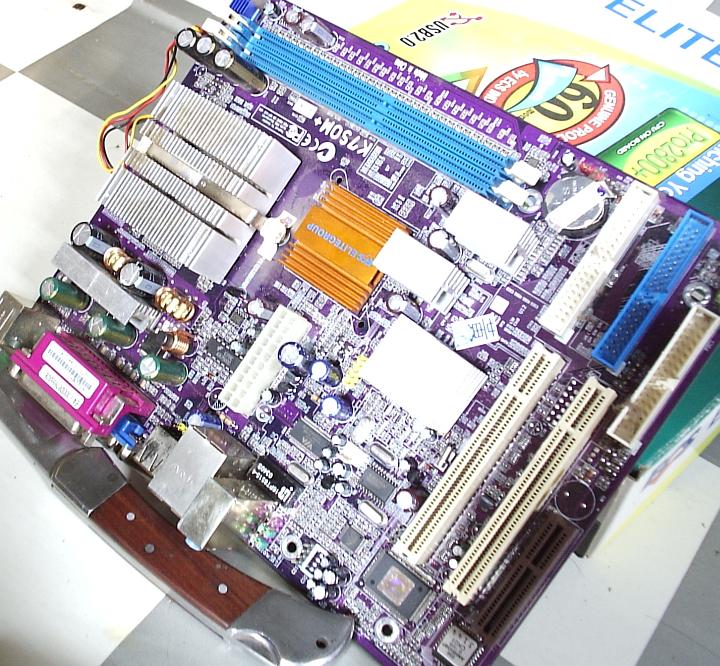

      Re: ECS K7SOM v7.5c
      Here we go..

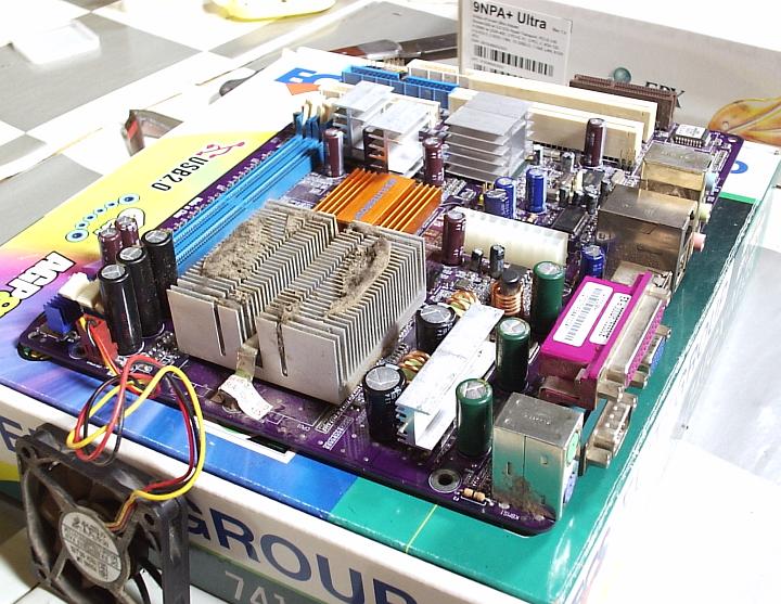

      After recaping:
      Ugly dust. Of course i dont forget to clean it after recapping done.
      Notice that i add some heatsink to the hot spots. Applying the heatsink in the process:

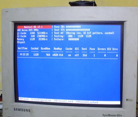

      Testing:
      Memtest no problem:
      I take the picture and post this thread in hurry, so the list of original caps and their replacment would be in my next post (probably tomorrow).

        I dont know how they get away with selling the cpu as a 1500+. There was also a duron 1000 that was sold as a 2000+. Now we sell one that has an Athlon XP Mobile 2800+ barton on it and its sold as such. There is also one available that says its a 3100+ but it is in fact a sempron 2600+.
                  Their boards also appear in hong kong martket. Many novices brought them because of low prices. Actually, they didn't save a lot when they brought the boards & CPUs separately. With the quality of K7SOM and the like, it isn't worth the money, letting alone the fake rating.
                  When their low end boards can't compete with others and there are no rooms
                  to lower their prices. They just sell them wth the so-called pro processors,fake-rated CPUs.The fake rating is certainly a breach to certain laws but it seems ppls and the media doesn't care much about it. Tell your friends,tell the public, they are not upto their specifications.

                      There are endless posts on the AMD forums regarding these things....

                          he version with the on board ram is the ECS K7SEM v.3.0M. It has support for 256 integrated sdram, and one dimm socket for sdram. I have one of these boards that will not post, acts like the bios is bad.
                          i've seen those too.
                          @ hkivan,
                          the board was so cheap, it was $60 - $65 no wonder people buy it. it run multimedia fine, also at least AOE 2 can play with it fine.
                          @ Shroomie,
                          i think they are not Spitfire based. i have strong suspicion that they are morgan with reduced multiplier, proved by SSE capability. i have heard that ecs group have buy some mediocre cpus from amd, underclock it so they could run stable, and sold them by integrating it in the mobos. btw thanks for the link.
                          the fan is so little and so loud, i hate it. i'll replace it with adda fan of the same diameter. with active cooling software such as cpuidle or cpuz it can even be more cool. hell, it can even do fanless...
                          that would be interesting to read.. *seeking

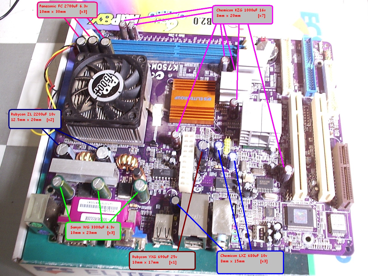

                            Re: ECS K7SOM v7.5c
                            click image for large version:

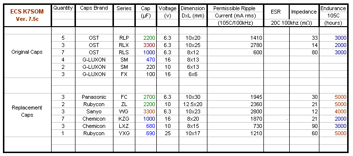

                            Caps information:
                            That panasonic FC is rare item to me i can finally stock them. It's not easy to find >2200uF caps >10v in 10mm diameter. Price is about $0,4 per piece. They are in black like FJ and FM.
