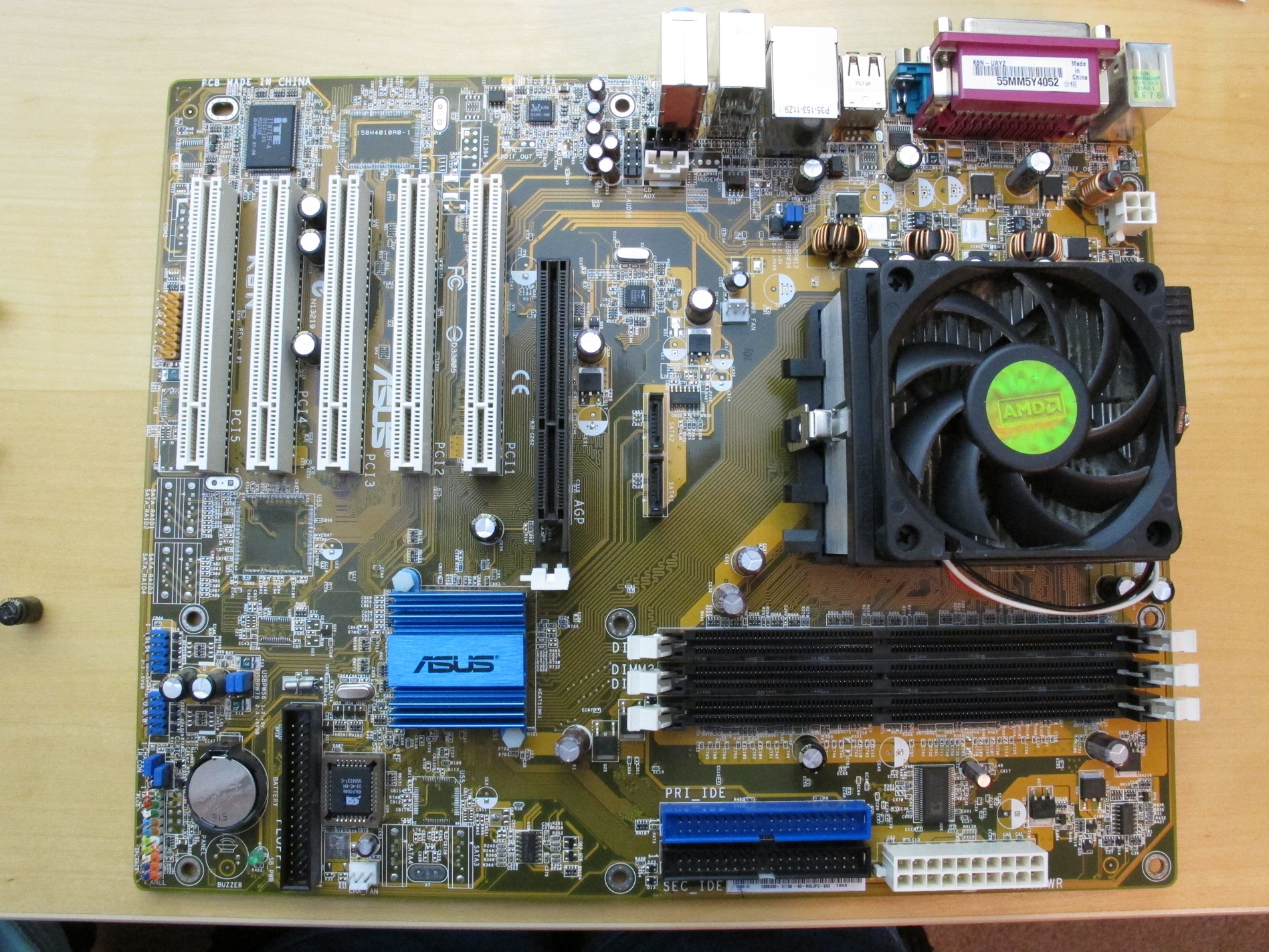

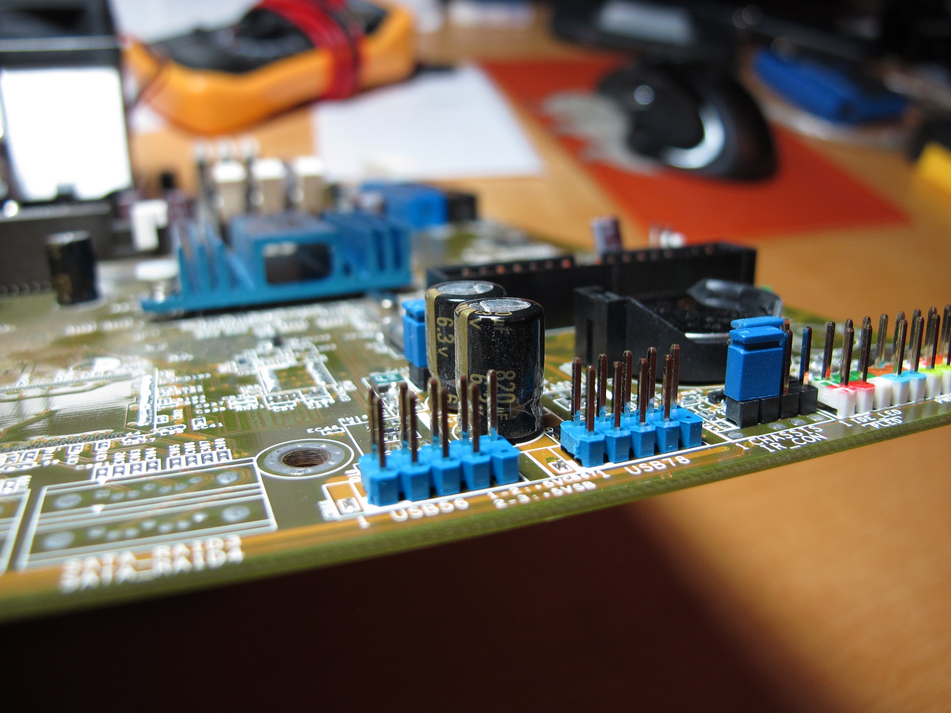

    I tried to replace some of the swollen one's and still no-post! Green light is on, fan will turn on, tried to boot with a new PSU!!

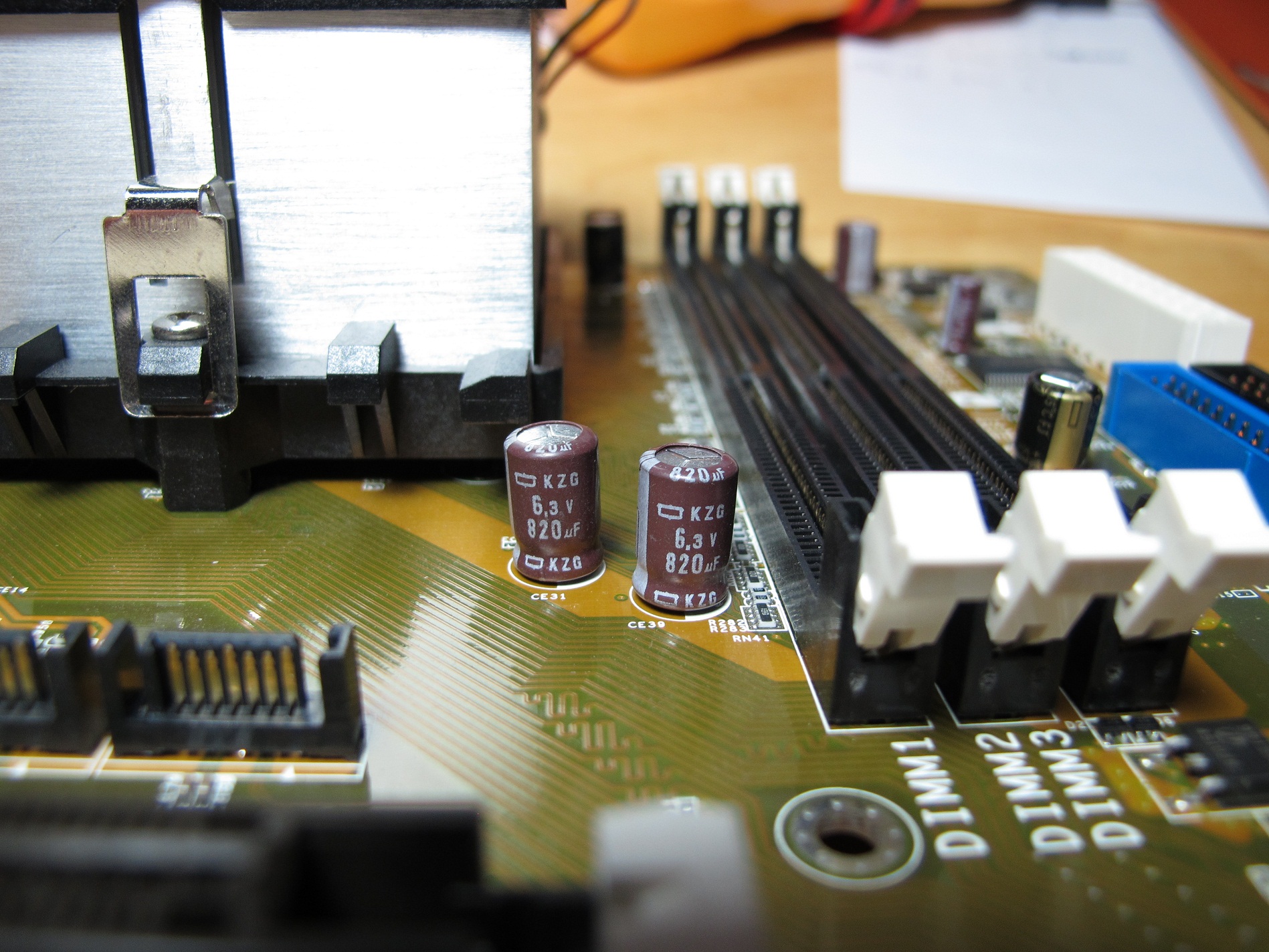

    Most of the caps on this motherboard is KZG, just realized even the new one's I replaced was KZG...
    should I replace all cap with other brands? Or will there be more bad caps on this board that is not leak or swollen but bad?
    Thanks!!

    Replace all of thre KZGs. They often fail without showing it. If the baord still won't POST, can it. ASUS are known for just dying with no obvious signs or causes.

      I hope you tried to boot with RAM installed. And I hope you paid attention to the polarity as Asus likes to use the negative sign on the silkscreen of the board for + side of capacitors, contrary to normal conventions.
      Yeah, take out those KZG capacitors.
      Disconnect the board from the PSU and maybe remove the battery for a few seconds then plug it back, to reset the bios and then try to boot it.

        Ok, just got a ESR meter! Tested all caps no problem except 1 x 100uf 16v is reading 0.29 but the rest "about 10 of them" reading are 0.7
        my question is - is the one with reading 0.29 bad? " it's located in front of the 20pin connector"

          0.29 for a 100uF sounds OK. 0.7 for the KZG sounds bad, shouldn't be more than 0.2-0.3
          But I'm not sure if the fact that you measured them in-circuit matters - as the capacitors are in parallel the measurement may be a bit incorrect.

                          I reflowed the northbridge with a heat gun and tada it post again!!
