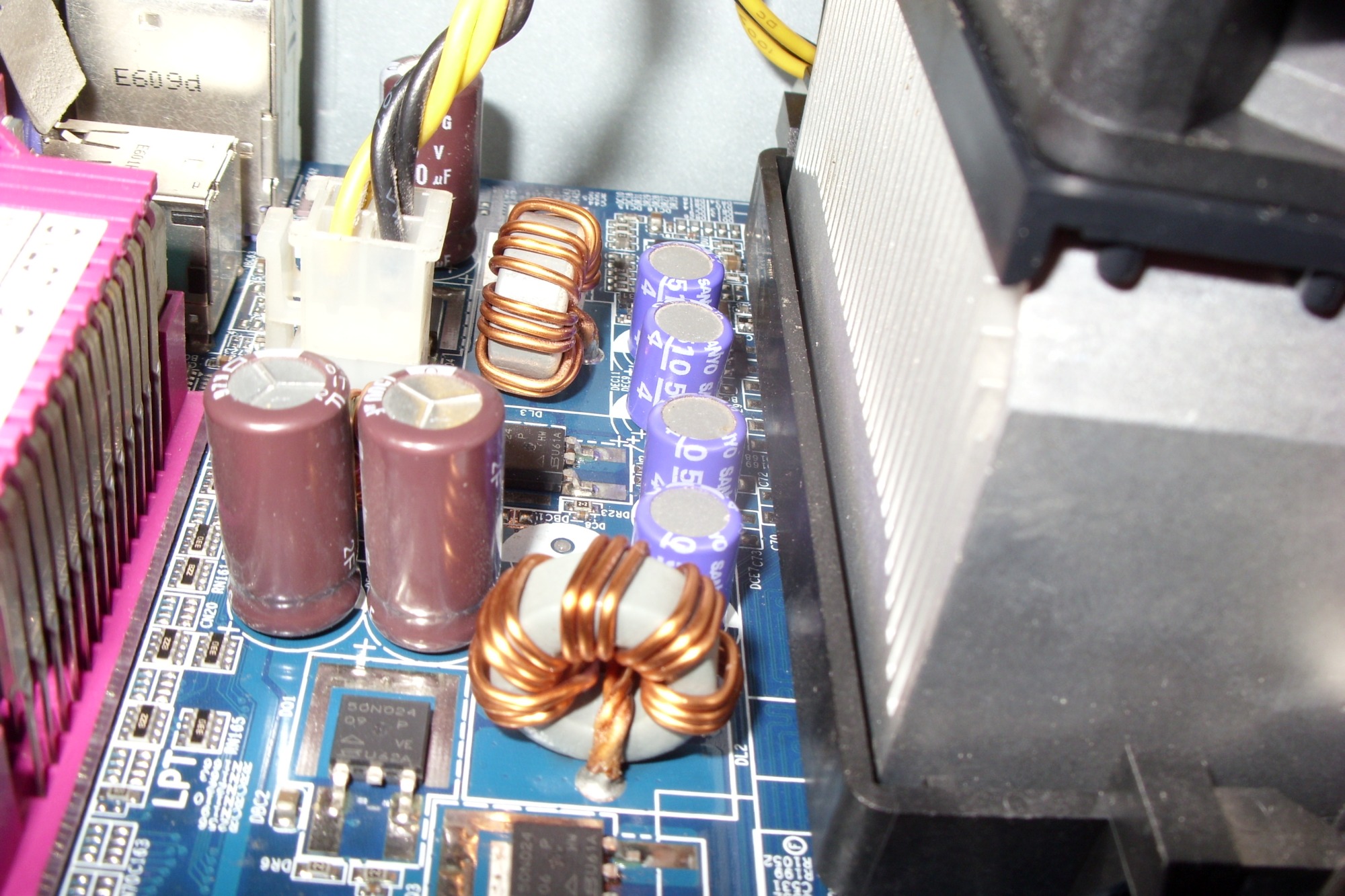

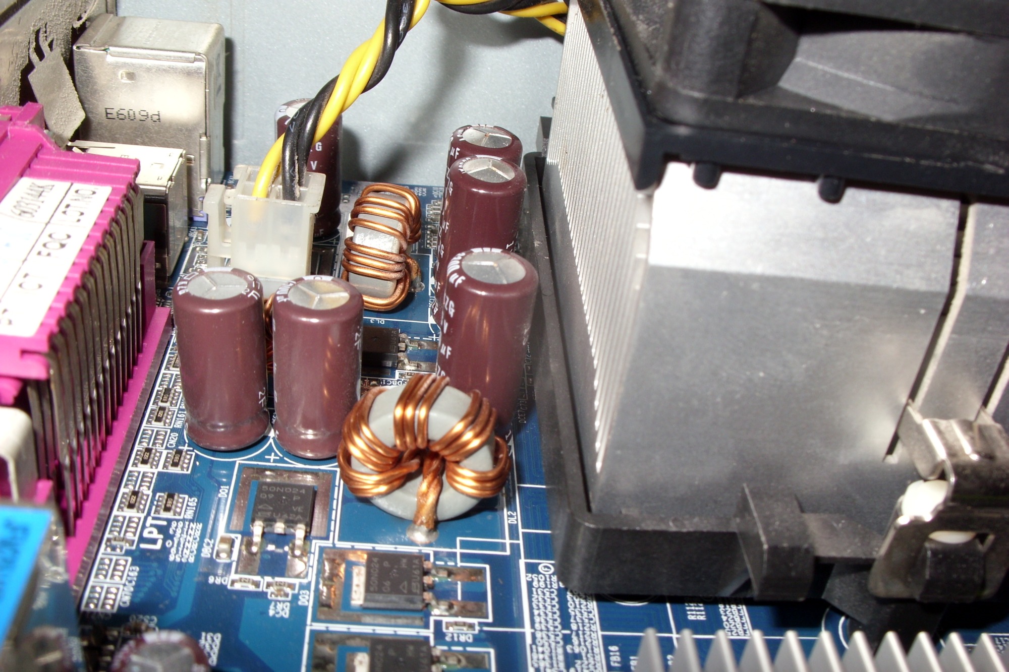

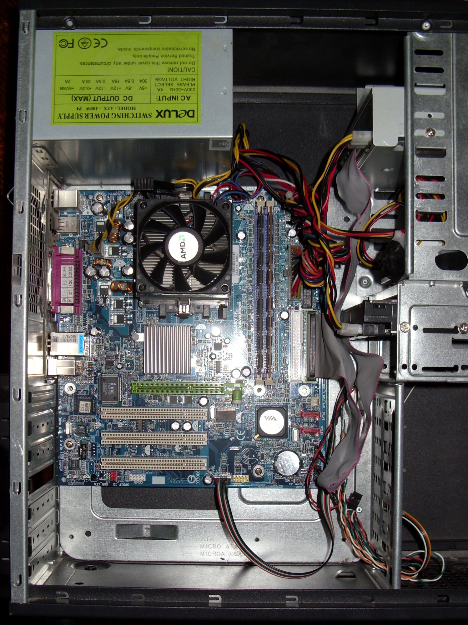

    Got this in tonight from my first floor neighbor. It stopped booting into Windows, would display random lines in text mode instead of the XP bootscreen. He thought the onboard video could be going out, but a look at the board revealed something else.

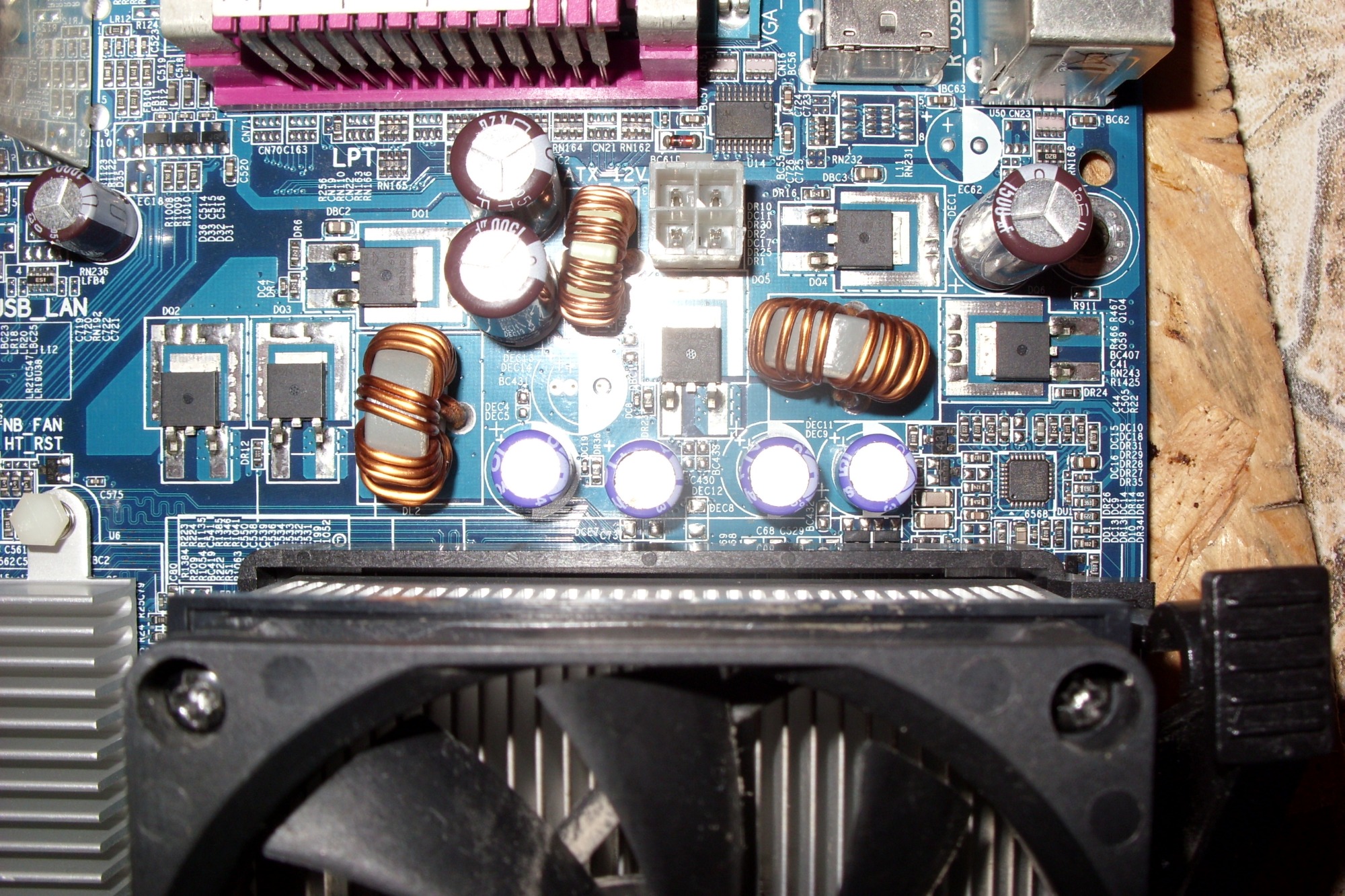

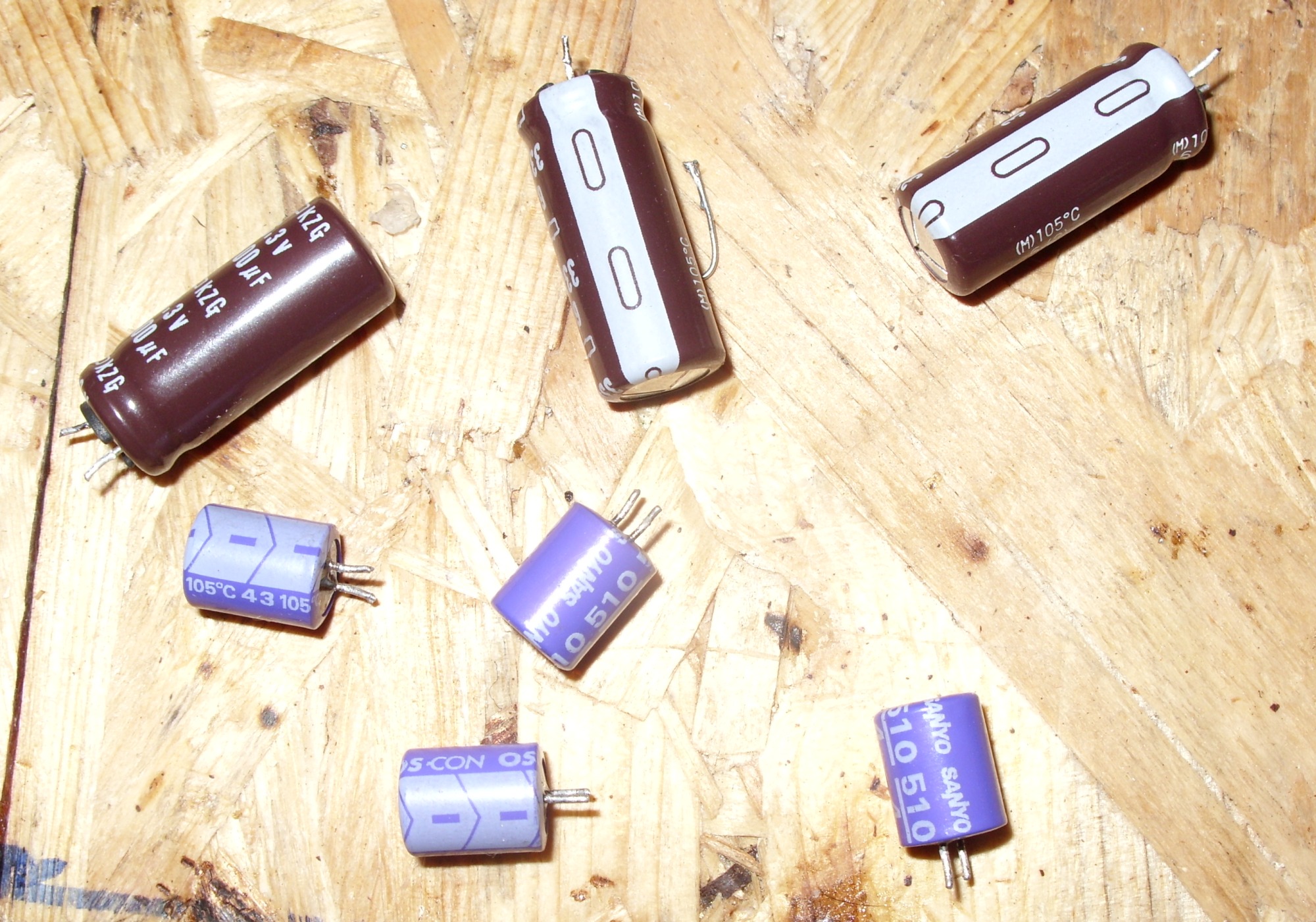

    I know this is a low-end board but that's some serious cost cutting. The VRM has all of THREE caps. All three 3300uF 6.3v KZG, all three had gone bad. 1.3 ohm, 0.74 ohm and 100 mOhm. If the third cap had gone any worse it's likely that the thing wouldn't have even POSTed anymore. It was only running a Sempron 2800+ CPU, not some power hungry dual core. And this is a well-cared for machine, i mean just look at it, there's almost no traces of dust, that's a low power CPU and the caps still failed. The whole board is KZG btw, with a couple tiny Teapos thrown in the mix, but knock on wood, the rest of them seem to be fine.
    I was out of 3300uF caps of any kind but i found something else in my cap box, take a look at the pics. Booted up first time, passed IntelBurnTest, so we can call this another successful poly mod. The OSCONs have 17mOhm ESR each, so with 4 of them i get 4.25 mOhm. The three KZGs (assuming they ever met their spec of 12mOhm) woulda been 4 mOhm. The difference is insignificant. It doesn't seem to complain about the change in capacitance either.
    You should see the insides of that joke of a power supply, but that's for another thread... Anyway, it'll probably stay in spec given the consumption of a Sempron with onboard video, so it doesn't worry me that much. It also has a partially seized fan, but i ain't fixing that for free. I'll suggest him to get another power supply, whether he takes my advice or not isn't my business.
