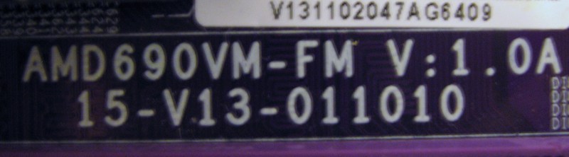

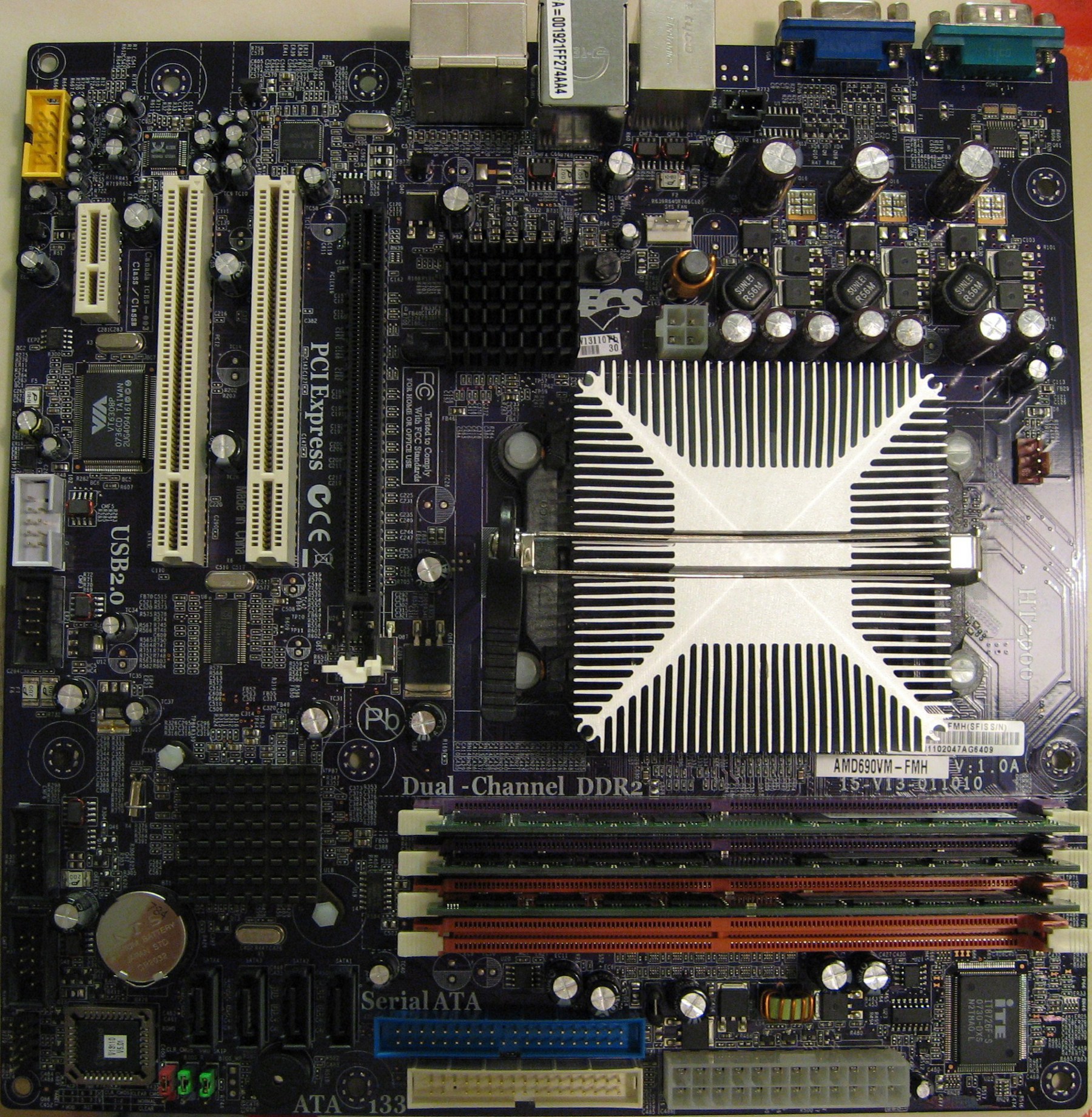

                          Re: ECS HT 2000 motherboard
                          Hello to you all.
                          I'm also a new member in this forum and I also have problems with ht2000 board.
                          Can you help me to identify this part: Sunlei R56M. The marking indicates that it probably is a resistor, but can a resistor make noise? I could swear that I heard a noise coming out of these three components. And of course, the caps around them are fried.

                              However, I'm not totally sure about my motherboard model. The only useful information that I can see is: V:1.0A 15-V13-011010 and that doesn't tell me if this is also L10? But coils would have been my next guess.
                              • c_hegge
                                • Sep 2009
                                • 5219
                                Probably an AMD690VM-FMH
                                Replace the bad caps with https://www.badcaps.net/store/produc...roducts_id=152
                                • severach
                                    ECS AMD690VM-FMH is the board model. Seems to be an OEM board for Fujitsu-Siemens computers.
                                    Kinda curious as to what's below the white "AMD690VM-FMH" sticker between the CPU and the RAM slots..
                                    • Oili
                                      • Jun 2012
                                      • 3
                                      • Finland
                                      Just the same.
