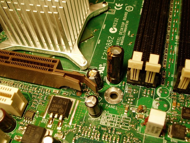

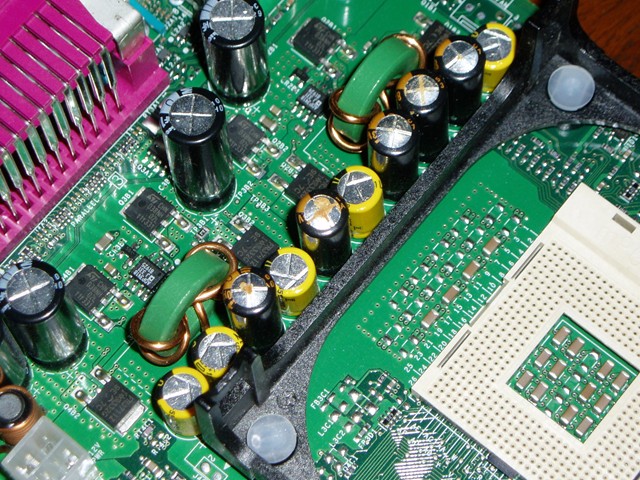

    OK here is the story behind how i recived this mobo. I've been looking for an upgraded intel motherboard for the crap D865hgvz intel board that came on this supper cheap emachine. After looking all over at specs for different motherboards I just decided to stick with an intel based board to avoid any problems. Funny enough i even caught a mention of badcaps.net forum in a review of an ECS motherboard on new egg which made me want to stay away from any other brands. I did the ebay thing and what do i pull out when the UPS guy shows up. A d865glc that smelled like my microwave after burning a bunch of popcorn. The entire row of 820uf 6.3v Nichicon HN caps along the HSF clip had blow like prepubecent pimples(i know about the problem now with Nichicon HN's ). The other two 820uf 6.3v Nichicon HN caps both show serious bulging. I also have a 470uf 10v Nichicon cap right next to the APG slot busted open almost like it had been pierced while this guy was trying to install an APG card. I dont know if that started the downward sprial of this mobo or what but I'm going to try to recap it for the simple fact that when i confronted the guy by calling him at the phone number on the ups package (that happen to be his work) he quickly refunded my money even the shipping. So i have a free dead board that I'm going to attempt my first recapping. I figure all I'm out is the couple of bucks for new caps. I'm getting some Rubycon's for the Nichicon HN 820's and a sanyo for the cap next to the apg slot. there is one other piece of the board that worries me and i have no idea what it is so I'm including a picture of it so you guys can tell me what it is and how to go about replacing it since i see a lot of flux residue around it and figure it was taken out by the surging power when this board failed. Its in the third and first pictures and is a black box with two leads on the PCB and one short stubby one in the center located right next to the agp release. Thanks for any help or advice you can give.
    i doubt it started the problem, the nichicon HN series would have failed anyway
    i cant see that
    make sure you practice on a trash board or something else before you recap a good board.

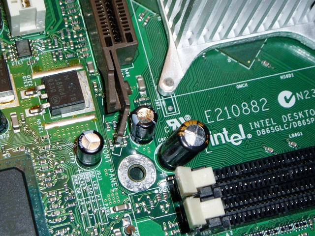

      the part I'm worried about i think is a fet its in the pictures and has:
      N TB
      18N06L
      330
      Printed on it.
      It just has all that browned flux around it so it worries me.
      Should i replace it and how do i replace it?

        looks ok, probably like that originally
          Re: Blown Caps Intel D865glc
          larger parts sometimes have flux residue around them.
          its likely ok.
          if it still posts recap and put it to use.
            Brown stuff around MOSFET leads = OK
            Brown MOSFET = probably bad (gate shorted to source-drain)
              Hmm... from what I can see in your photo, the 'brownness' appears to be only flux residue around that transistor.

                    I have been recapped 5 pieces of these series Intel i865 boards at least. All is Nichicon 820uF 6.3v are crap.
                    Although, i have stock of 820uF 6.3v. However, i don't suggest to recap with same uF and voltage for this board. So i recapped with my Samxon GC 1500uF 6.3v (8mm) instead of these Nichicon 820uF 6.3v. Now all is working excellent over than one year.

                            HN and HM made between 2001 and 2004 were defective.
                            Manufacturing error. Overfilled.
                            -> This is well known.
                            -> The series is not crap outside of the defective batches.
                            At least Nichicon made a public announcement when the problem was discovered.
                            I think you measured wrong.
                            If not they are a custom ordered size. (Not especially unusual.)
                            >> If replacing with a newer hn of the smaller size, would it pop again faster? <<
                            - It could but not for the reasons you think.
                            8mm x 20mm HN series specs are 2220 ripple and .012 ESR.
                            8mm x 11.5mm HN series specs are 1300 ripple and .021 ESR.
                            [uF and volts doesn't significantly affect those specs, can size does.]
                            If they are 8 x 2_? mm about the only way your going to get 2220 and .012 in a 8mm can is go way up in uF (as Big Pope did) or switch them to solid polymer.
                            A solid polymer is probably better.
                            Look for maybe 560 or 680 uF and an ESR .009 (or less) and the lower ESR will compensate for the slightly less uF.
                            Polymers will also have much higher ripple capacity which indirectly means they can handle more heat. (Ripple generates heat inside the caps. Caps that have higher ripple ratings can handle more internally generated heat without breaking down. As the max temp is still usually 105c this implies that solid polymer are better at dissipating internal heat.)
                            If they are 8mm x 11.5mm then Rubycon MCZ or Samxon GC are same spec replacements.
                            HN with date codes 2006 or newer should also be fine. 2005 are dates 'probably' okay but I don't use them because I don't wannabe the one that finds out otherwise.
                            Chemicon KZJ, Nichicon HZ, and Samxon GA (regarding 8x11.5mm) exceed the HN ratings. (Are better.) KZJ - a little. HZ and GA - significantly.
