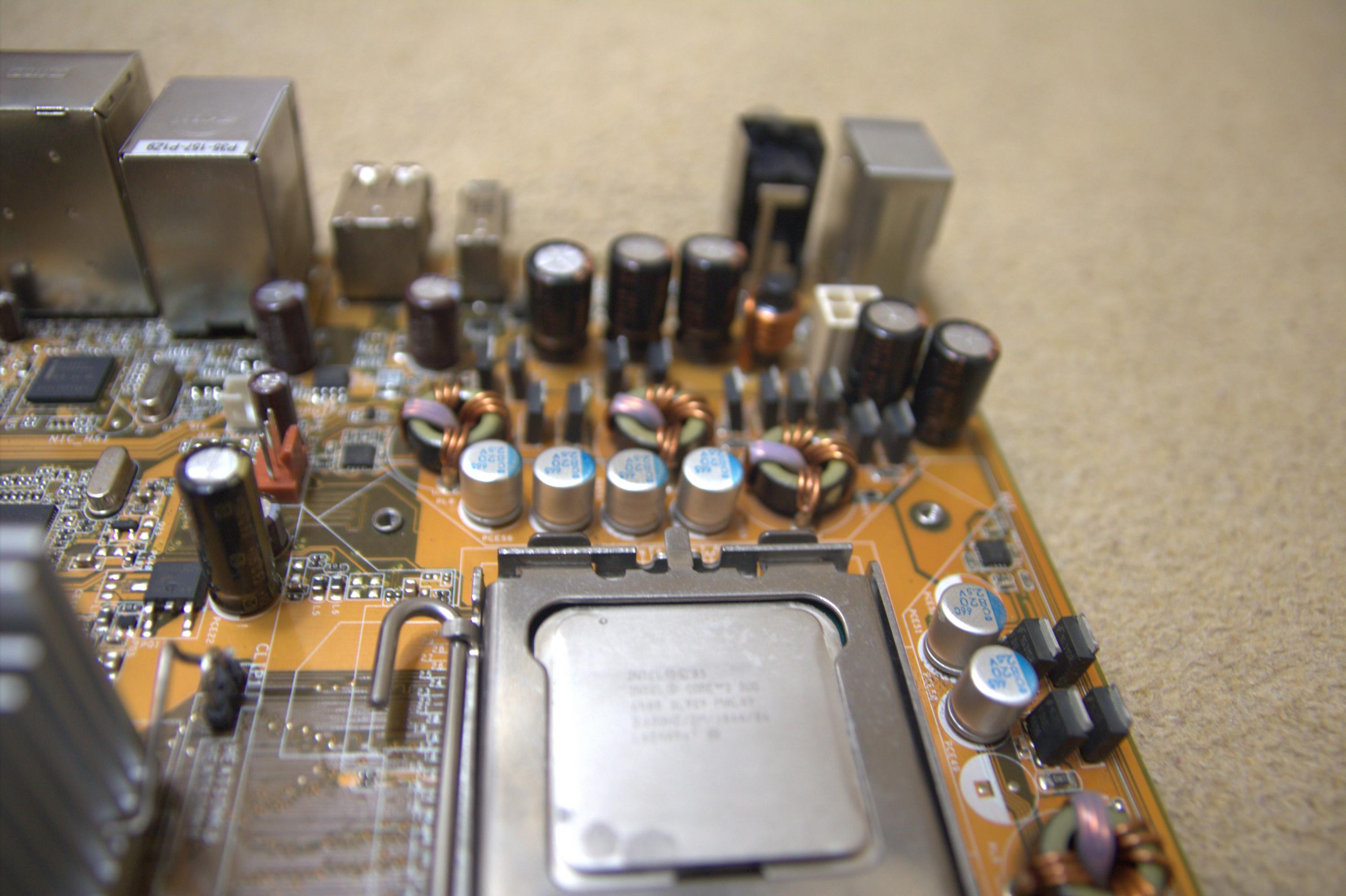

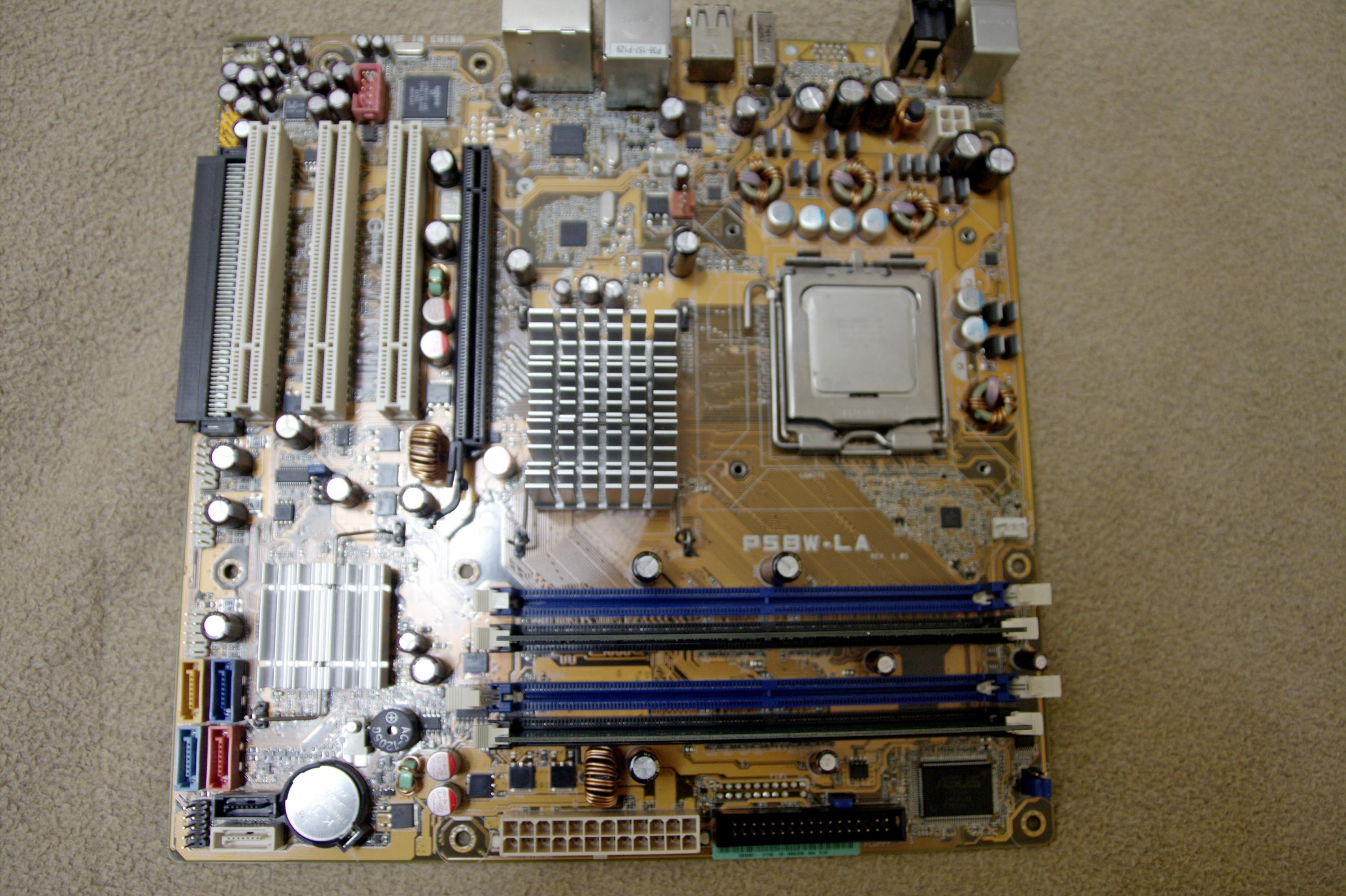

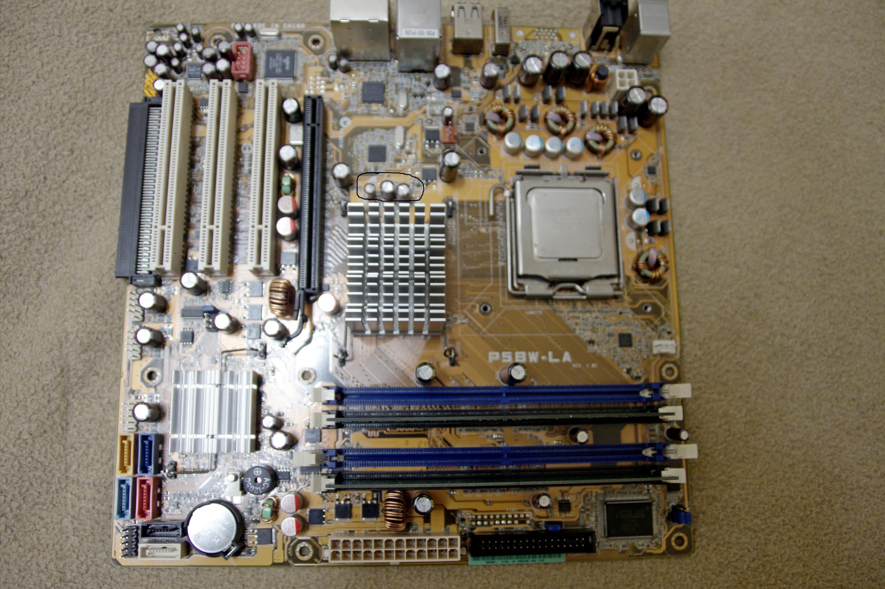

    Here is a HP PC m7000/2gb Ram/Ati video card/Pentium D processor socket 775
    This the Pc of a friend. Pc keeps turning off/on by itself for ever, he said.
    I just got it to have a look. First I cleaned it up. Such dust I have never seen, only from other's pictures. Five years since purchased and never been cleaned.
    I checked:
    -video card (replaced with one I have) OK
    -Removed all other cards - the same problem
    - removed all Ram memory- a good working motrherboard should have some beeps, this one nothing.
    - Attached my AX750 PSU - the same problem
    - cleared CMOS , no help
    - changed the Hdd, the same problem
    The only thing I have not checked is the processor, I have not any to replace it.
    This motherboard has a few aluminium capacitors, the others are KZG, I think are from 2005, no sure. I did not remove the mainboard to look closer.
    The three capacitors beside CPU, are KZG. No sign of leakage. They look perfect.
    I think one of the two are the problem; the motherboard or processor. I tend to believe, based on my previous experience with KZG caps, that is motherboard issue.
    What could it be? The KZG capacitors?

      KZG are a well known problem. They fail often and don't always bloat.
      Pretty good chance that's the only problem. [Or at least the biggest.]
      You should replace those before you spend a bunch of time on this.
      They are probably at least part of the problem and if they are they will hide any other problems.

            Re: Asus P58W-LA motherboard
            Back with the old problem.
            My friend decided to go ahead to fix his PC, his laptop was down too for a week and wants to have the PC done too.
            Before replacing the motherboard I changed the 5x KZG 1000 uF 16v with nichicon 1000uF 16v, but it does the same, when turn the pc, all fans start and after a few seconds it turns off.
            The motherboard looks OK, no signs of burn… I am thinking what else could be, maybe the chipset Intel P965 burnt? I do not know.
            The other capacitors on motherboard are:
            6x polymer 820uF 2.5v
            4x CFJ 1500uF 6.3v
            5x Polymer 471uF 6.3v
            11x KZG 820uF 6.3v
            1x CFJ 470uF 16v
            and a few KZG smaller...
            I am thinking to replace the 6x polymer 820uf 2.5 are closed on the left side of processor.
            This PC never been cleaned and run till failed, I think were high temps, there are some traces of burn underneath of the motherboard…. (the shape of the heat sink mounting metal plate at the back of motherboard)
            What do you guys think, to go ahead to change some more capacitors or throw it away.

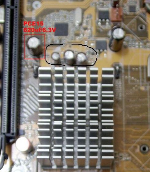

              the ones that are on the VERY left side of the CPU were replaced? They look like nichis in the picture, is this a picture of post replacement or pre replacement? Which nichicons did you replace them with?
              also, I notice a nichicon next to the northbridge, This is a 775 board probably from 04-05 within the bad nichicon manufacturing time range

                Yes, it is post replacement. I replaced the KZG 16v 1000uF 8mm with Nichicon HN 16v 1000uF 10X16mm, five of them on left side of the CPU.
                The Nichicon HN(M) 16v 1000uF 10X16mm I bought them a year ago.

                  what about this one? it looks like an original board nichicon. Remember any 01-05 HP and dell boards have a chance of bad nichicons
                  edit: nevermind, looking at the other picture I can see its a panasonic. But the 3 below are KGZ's and I think part of the northbridge VRM, you might want to consider replacing those

                    I do not know which once you are talking about. Maybe some of the 11x KZG 820uF 6.3v
                    I have lots of Nichicon HM 1000uF 6.3v, can I use them to replace some of the KZG 820uF 6.3v?
                    ....Those three you are talking about?:
                    1x 16v 100uF KMG
                    2x 16V 220uF Radial KMG
                    KMG = United Chemi-Con ?
                    I noticed that in spite of the same colour which is the same as KZG, there are smaller once as KMG...

                        As I said, everything else is OK, hardware point of you.
                        I am saying this because now I replaced it with FOXCONN 45CMX, a fellow had a few of them new, sealed, never used.
                        I got it, installed Windows 7, and everything is fine now.
                        So the motherboard is the problem. I am still trying to fix it, to change a few more capacitors, if is not going to work, I will remove the capacitors I have replaced and throw it away.
                        FOXCONN 45CMX is not that strong built as the Asus P58W-LA, but as long as is working finem it is alright.
