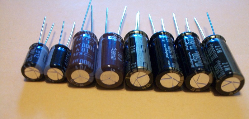

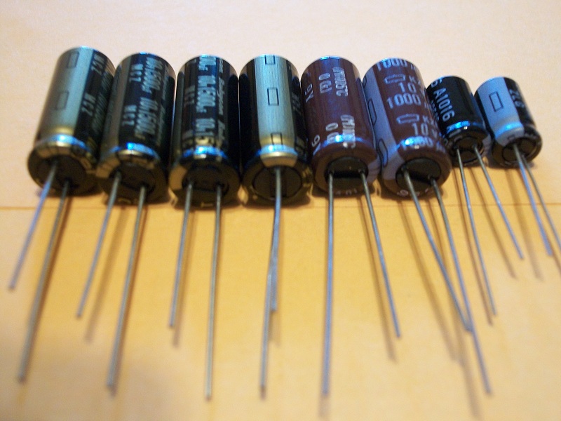

                Here are the caps delivered from thecapking.com. Will get before and after pix tomorrow, card is at work.
                Rubycon XLG 100uF@25v, united chemicon KZE 1000uF@10v, Rubycon MCZ1500uF@10v

                  Those rubies are ZLG, not XLG.
                  They should all work fine, but they may be taller than the originals, so they could stop you using the next PCI slot.

                    Re: EVGA E-GeForce AGP, blown Sacon FZs
                    Good catch on the ZLG. I have three empty slots below the agp slot so, so it'll be good.

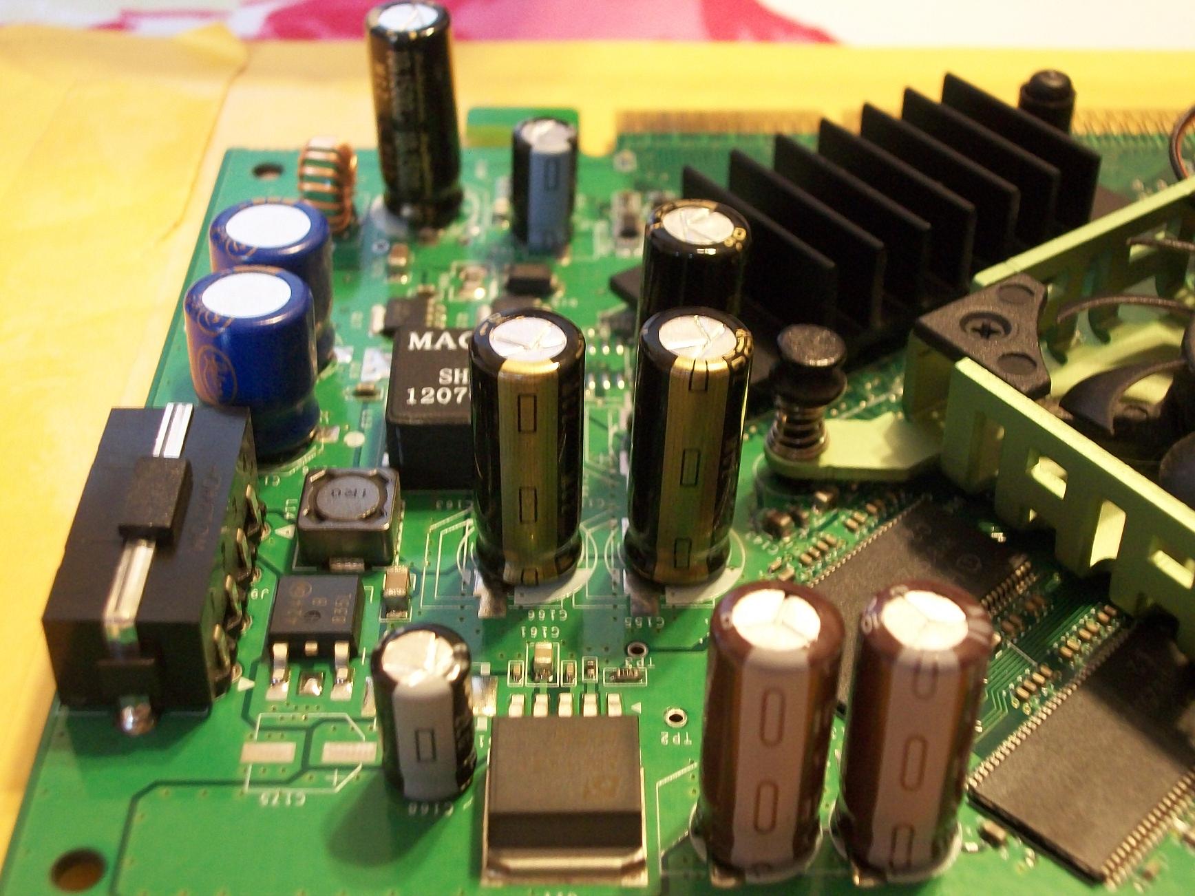

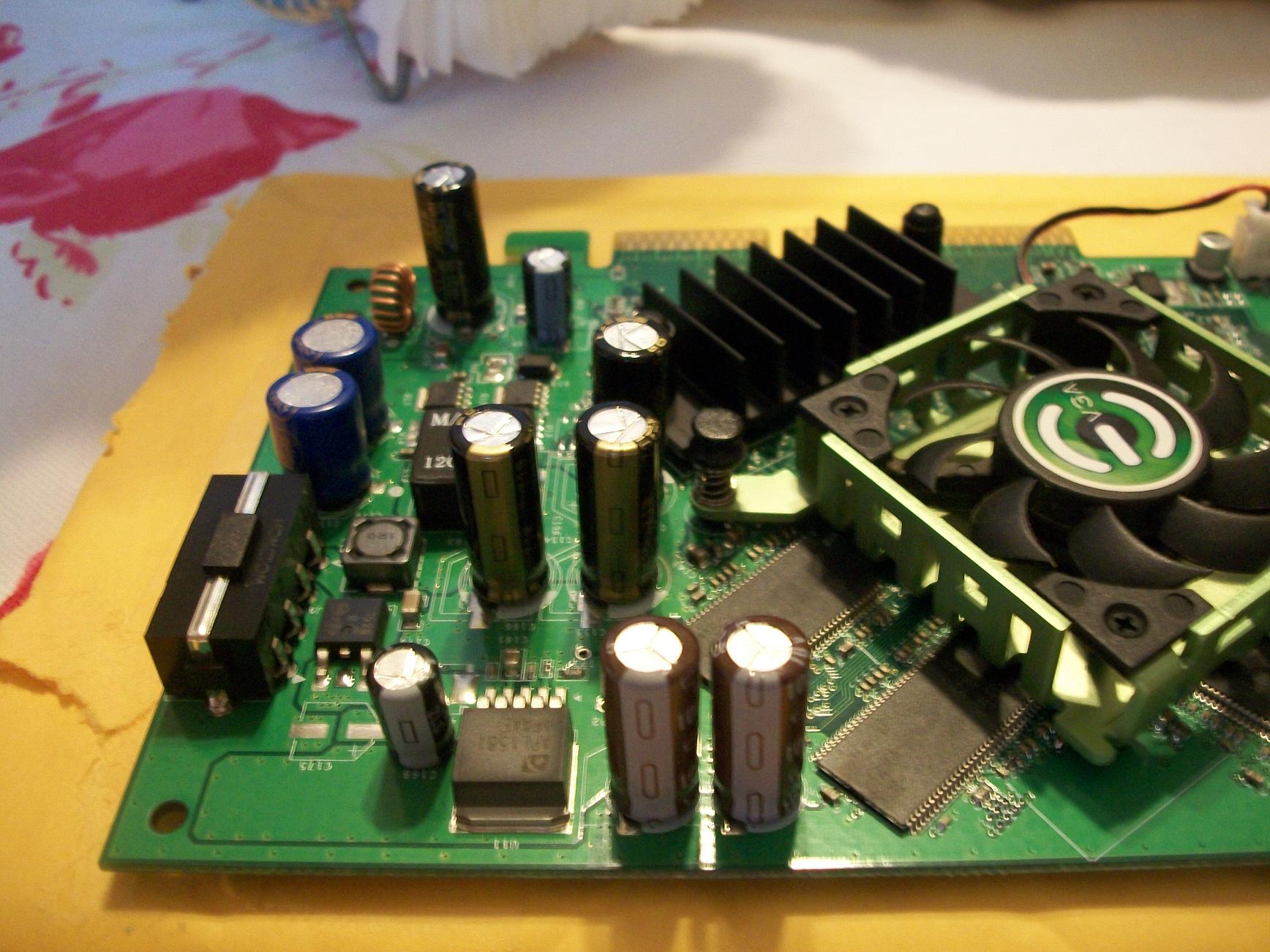

                      Recapped this morning before work and Ive just reassembled my PC. No problems as of yet. I know I didn't ask for help, but thanks for all the great information I found on the site here.
                      The two blue caps on the left are Lelon. Should I have replaced them?
                        They are polies, so they might be OK. You can replace them to be sure you won't have the card back again, but its optional.
                          I'm gonna call it good then if they'r polies. Had i known about poly modding, i might have done that. Copying my 4th DVD and been surfing the net with not even a hiccup.
