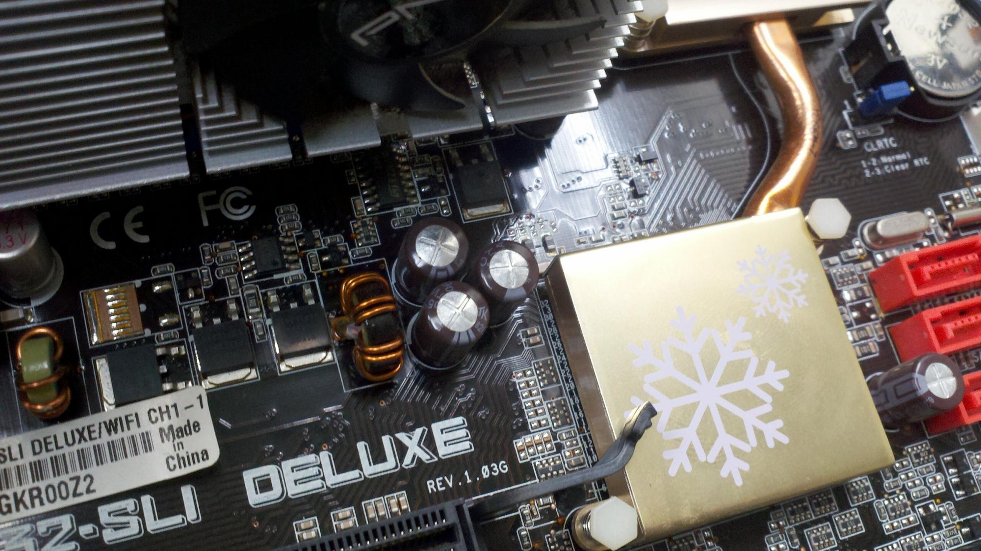

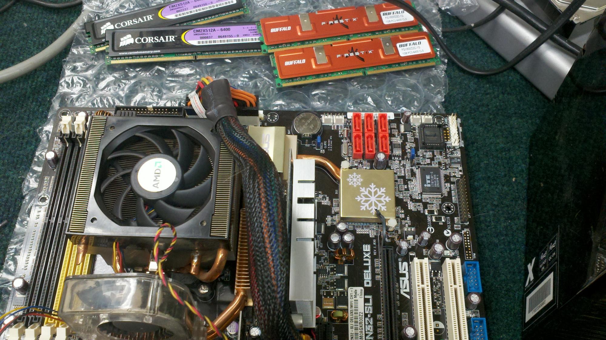

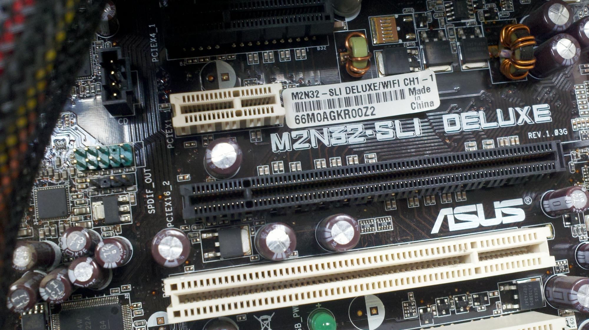

    m2n32sli deluxe blown tk caps.
    seeing a lot of these lately.
    so much for the "stack cool"design.
    lots of discolored spots too.

    Re: m2n32sli deluxe blown tk caps.
    Replacing caps that are between slots is always a pain.
      Those aren't -in- the stack cool, are they kc?
      IN the stack cool, now THAT's a PAIN!
        TK = Terrible Kapacitor. I often see them failed on ECS boards. I just recently recapped an Acer which had a few of them bloated.
          no.all the vrm outputs are sanyo sepc.
          i polyed it and its good to go now.one of my business partners is keeping it.
            i dont find that to be the case here.heat the leads and they drop out.clear holes.even with caps having precut leads like the polys i dont have any trouble inserting the new parts.and i am a "big ugly" with big hands.some spots call for the hemostats though.do as many boards as tc and i have done and you develop tricks to git er done.
              Except for the Cool Stack double board section. That's a pain to get enough heat to.
