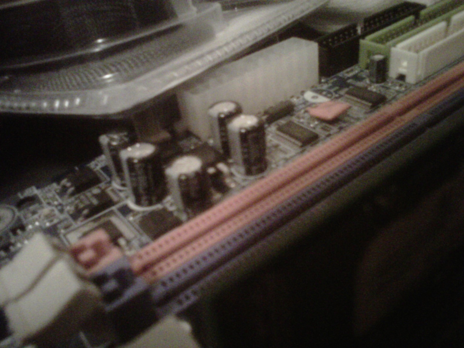

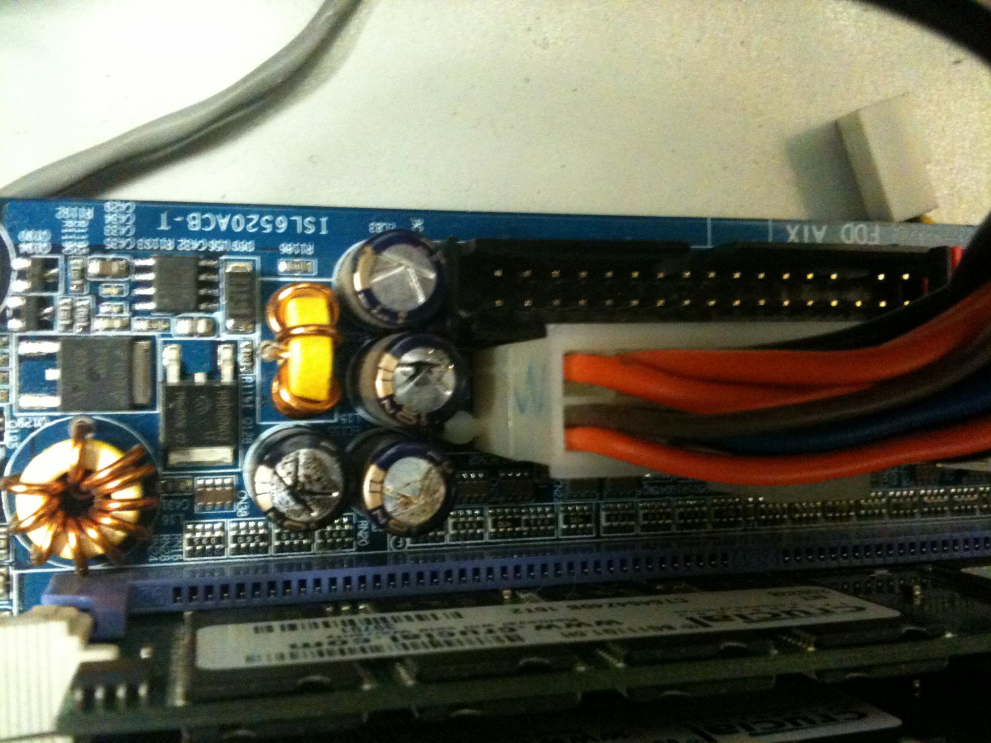

    Hello Everyone,
    I have attached an image of what I believe to be some bad caps. The motherboard will give off a sound of very fast beeps a couple of times on boot but nothing shows up on the screen, I have tried a different power supply and video card but both work fine in other systems which leaves it to the mobo, cpu or ram (pretty sure the ram and cpu are fine) alas I think its the mobo? Can anyone let me know if this sounds correct and if the image is showing bad caps have I just been lucky up to this point with it booting? cause they have beeen looking like this for awhile.
    THanks
    P.S. I just realized that I put this in the wrong thread (please move if possible) thanks

    it looks like you had a power supply that blew those, as they look baaaaad, I don't mean bloated but exploded-i'm suprised you didn't hear a pop
    yes, replace them, but it might be too late for nearby components.

      Re: Ga-8knxp
      What do you mean by nearby components? like other parts?

          Re: Ga-8knxp
          The circuitry near those capacitors is probably related to the generation of proper voltage for memory (remember, power supplies give 3.3v, 5v and 12v but memories are either about 2.5v for ddr1 or 1.5-1.8v for ddr2/ddr3) .
          If so, the motherboard probably can't power/recognize the memory modules properly and beeps.
          I would also check the capacitors near the agp slot as that uses 3.3v/1.5v so it may receive power from the same place (but unlikely, it's a bit far away) and should also check the ones near the cpu socket (but if the problem you have is due to bad 3.3v from psu, shouldn't have problems with cpu area as that uses 12v)

            Re: Ga-8knxp
            This makes sense thank you would explain exactly what is going on will have a look at the ones around the video card (maybe post picks for confirmation)

              Re: Ga-8knxp
              I've seen many blown Rubycon MBZ like this - in all my cases, it was due to excessive heat (HP/Compaq DC5000 SFF computers have poor cooling design) so I doubt the PSU is the reason why these bulged. I suggest you check your computer and make sure it has enough airflow because Rubycon caps don't go bad for no reason.
              In any case, just replace them and all should be well. For replacements, you can use Rubycon MBZ (MCZ is a slight upgrade in ESR, but they should also work) or Nichicon HM (HN is a slight upgrade but would also likely work). Not sure which series of Samxon correspond to these (most likely either GC or GD). All of these are available at the badcaps.net capacitor store.

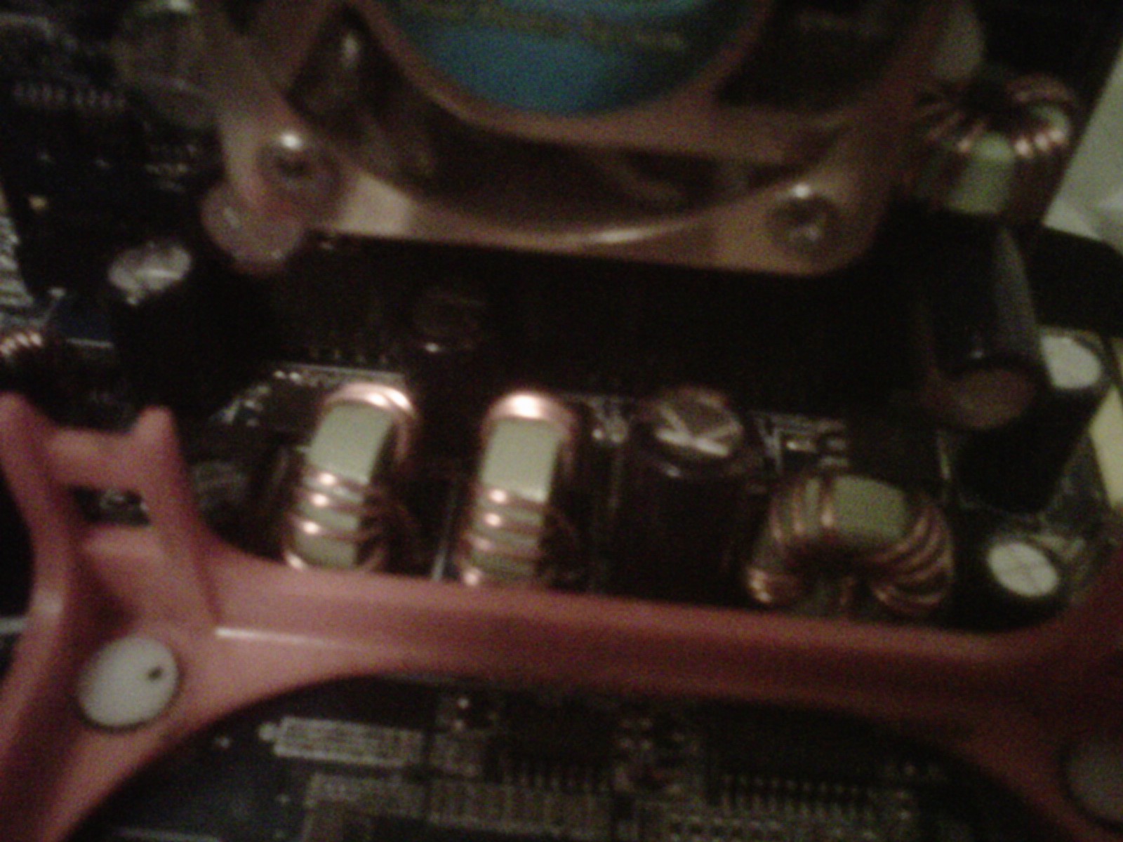

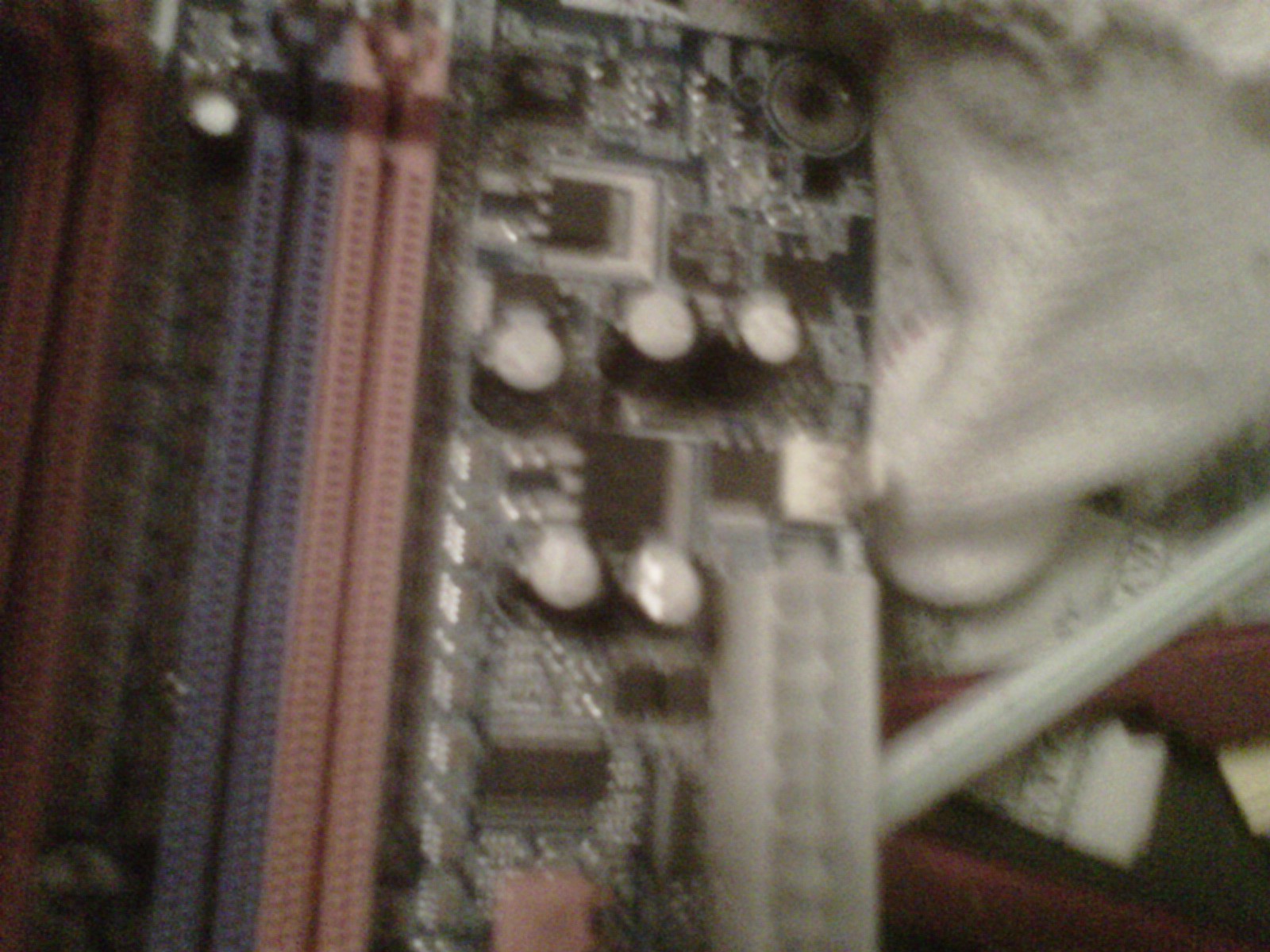

                            Re: Ga-8knxp
                            hahaha. I didn't realize, I actually have a VERY similar version of this board
                            my boss gave me a GA-SINXP1394, included the VRM board. with SAME bloated caps, but not burnt like yours. still booted though
                            first pics i've taken with my blackberry curve, kinda sucks
                            I recapped them with some rubycon yxg's
                            and replaced some main vrm caps KGZ's with MBZ's.
                            I'm probably going to end up putting a P4 3.4ht chip I found in a laptop in here (laptop with a desktop chip, I know)

                              Re: Ga-8knxp
                              all I need to do now is clean the NB fan. my boss smokes like a stack and its stuck
