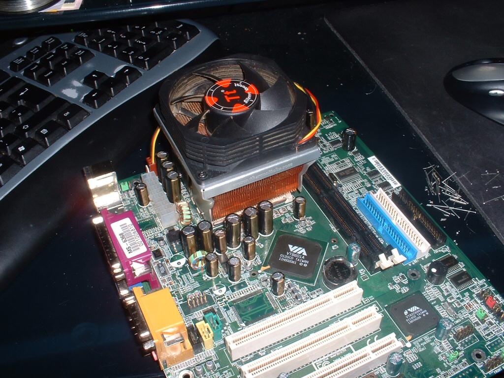

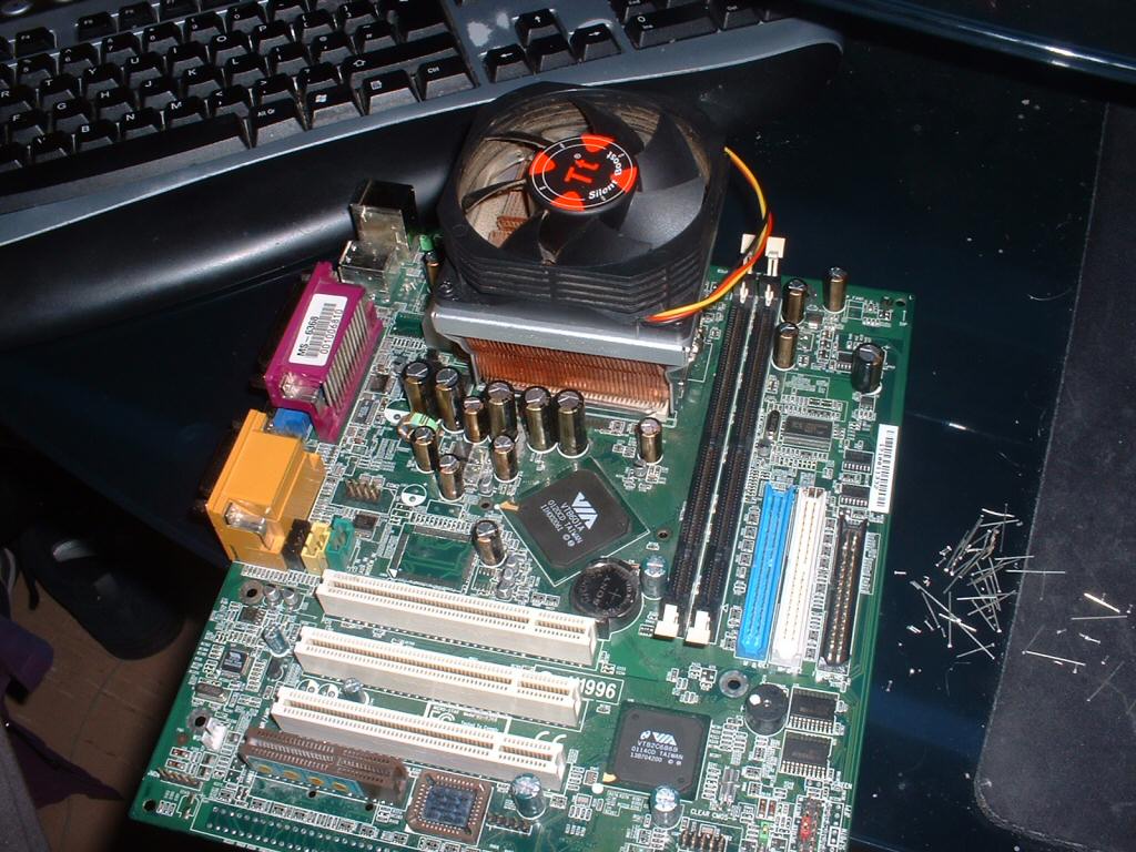

    Capacitors arrived today. They look rather sexy

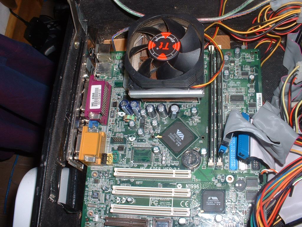

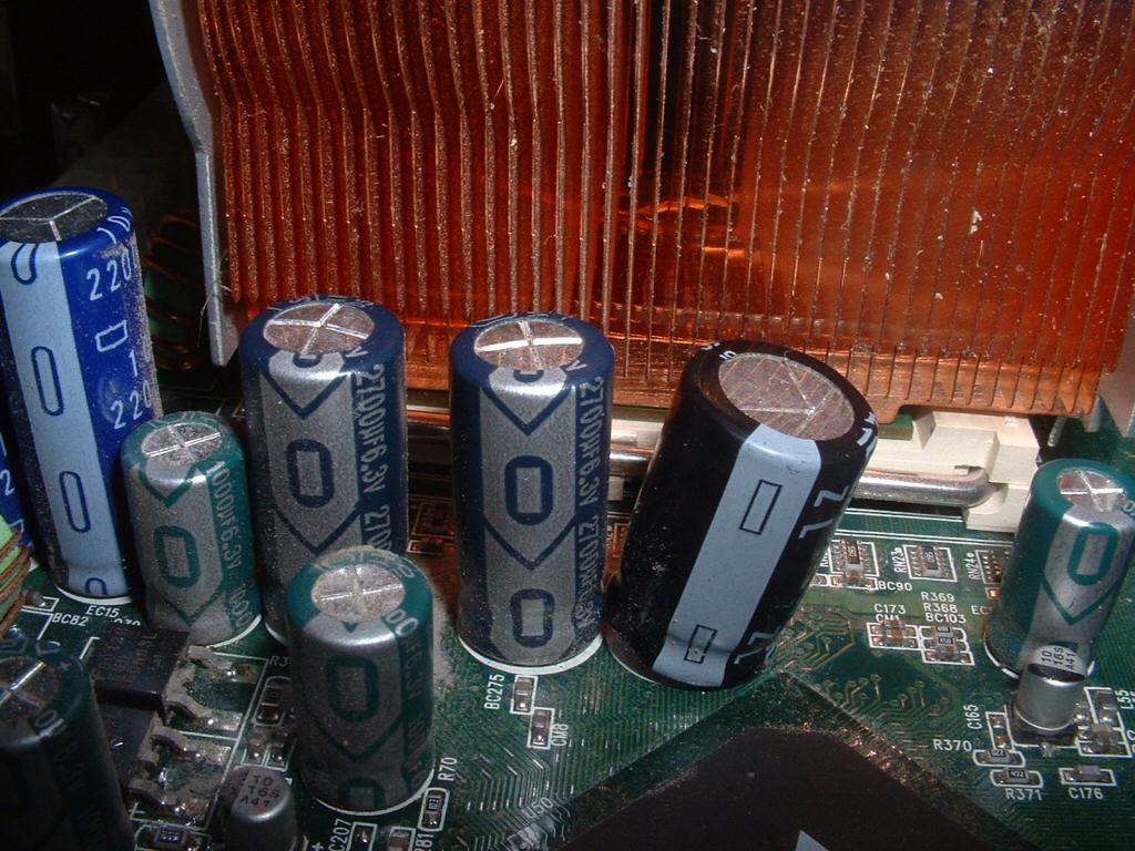

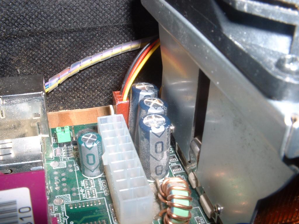

    Here's pictures of my recap jobby, as promised! Booted up fine, only time will tell if it fixes my freezing /lock up issues. Replacing a single capacitor, the big black rubycon one in the before pictures, seemed to solve the problem and it ran for a few days without issues, so.. I am guessing all is good now.
    My thanks go out to everyone here who answered my questions etc I'm very pleased!!

    I would have fixed the whole thing in one shot. I appluad your effort, but you've really just put a bandaid on it.
    The problem will probably come back again, the 2700's beside it look bulged to me...

      No, I did replace them all. Look closer at the second two pictures :P I removed the temporary big black Rubycon. The last two pictures are before pictures showing you the bulging caps that have now been replaced with shiny new Rubycon MCZ's

        yeah i was confused for a bit also
        this is the final job
        https://www.badcaps.net/forum/attach...achmentid=1783
        those MCZ are quite attractive looking. congrats on your success
