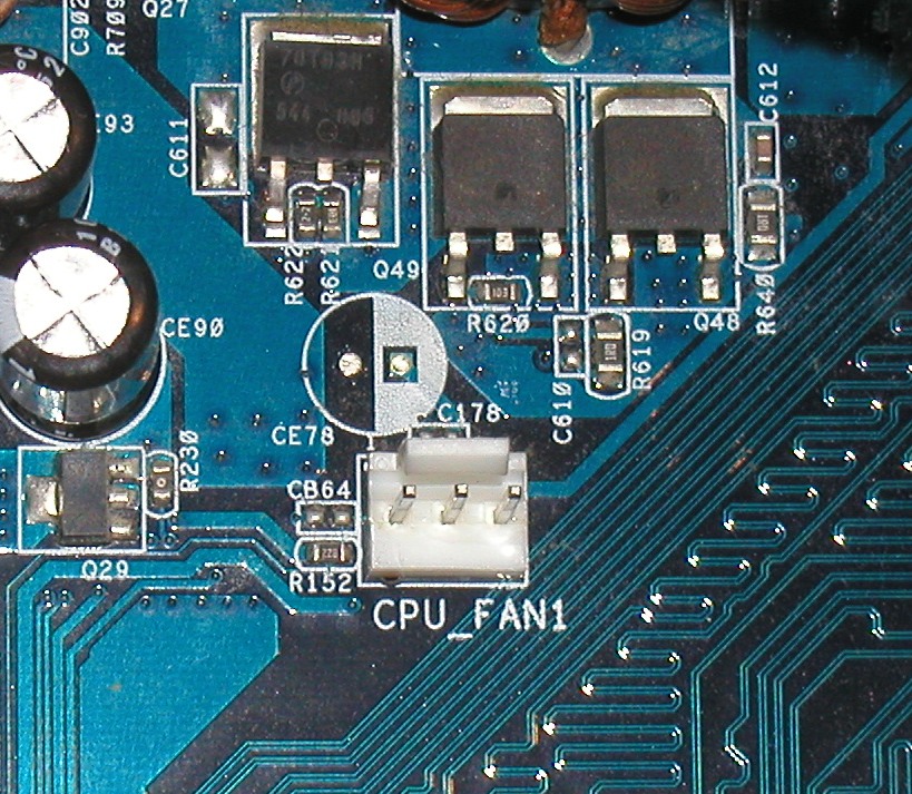

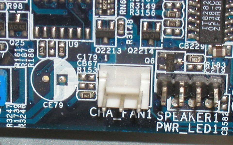

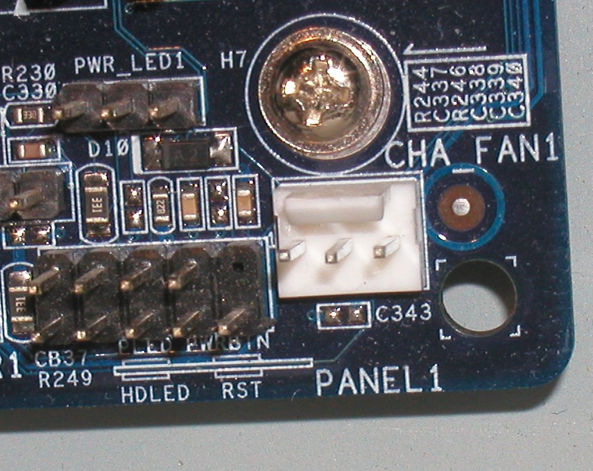

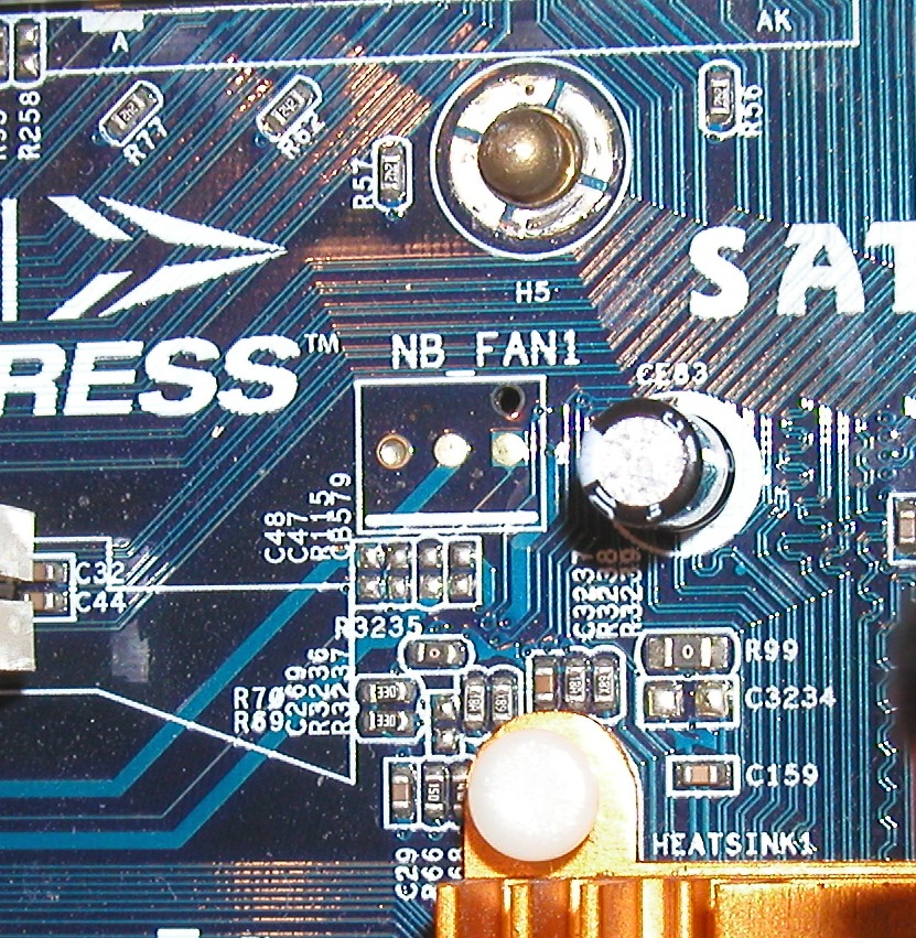

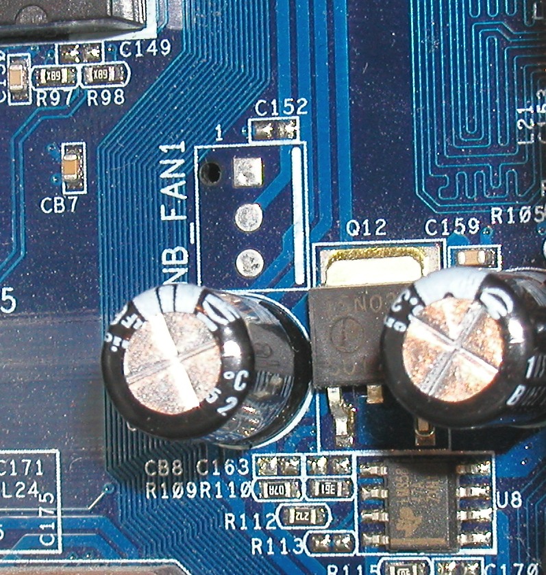

                    Concerning the fan headers and their capacitors, here are the promised pictures. I have also made pictures of the other Asrock board I have (K7VT4A Pro). I think the picture with the location of the northbridge fan shows best that a SMD cap should go to C152.
                    I am now wondering: is the 12V present at the fan header the same as 12V from the PSU, or it has gone through some filtering? And where would it be best to connect a fan, from the point of view of generated electrical noise?

                      One more comment: I would really put a fan to cool the northbridge area. gonzo0815 in his thread mentioned that the three capacitors there get very hot during the operation. There are also some power FETs soldered to the board, and on the backside one can already see a change in colour.

                        The +12v for fans comes from the 20 or 24 pin main power connector.
                        The +12v for CPU[s] comes from the auxiliary +12v connector.
                        On that board it's the usual/typical 2x2 [4-pin].
                        Servers and some higher end boards [needing more CPU power] might have more pins, more connectors or both for CPU power.
                        On some boards the two +12v supplies are connected together through the board.
                        [That's the usual case on older boards.]
                        On other boards they are completely separate.
                        [That's the usual case from about the time PSUs started having multiple +12v rails.]
