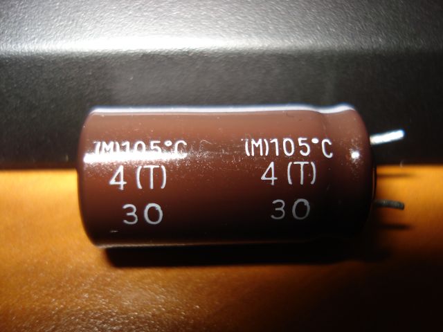

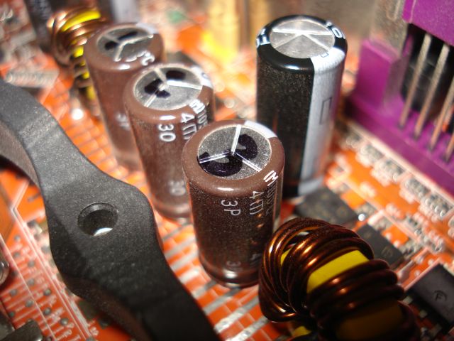

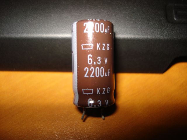

    I've got an old Abit AA8 that's acting up for no apparent reason. It's covered in mostly Rubycon caps, but there are (7) KZG caps on it. Of the (7) KZG caps, (3) are obvioulsy bad (bulging tops).
    The (3) bulging caps are like the first two photos. (They have a 3O on one side of them)...I believe that is the letter O and not the number 0.

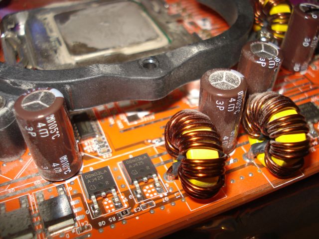

    These next two photos are of some of the others that don't show sign of being bad...they have a 3P on them.
    Some advice of what caps to use to replace them would be much appreciated.

    Replace all the KZG capacitors, even those that aren't bloating.
    Badcaps.net sells some replacements:
    https://www.badcaps.net/store/produc...products_id=62
    https://www.badcaps.net/store/produc...roducts_id=137
    Both of these capacitors exceeds the specifications of the original. If you source capacitors elsewhere, you want to make sure they have adequate ripple handing and low enough ESR. For reference, the specs for your particular KZG are:
    6.3V 2200uF
    Size: 10mm x 20mm
    Ripple: 2550 mA
    ESR: 0.013 ohms
    When selecting a replacement, you want the same or more ripple, and the same or less ESR.

                      The new HZ's came in...the KZG's came off...the new HZ's went on...the board went back in the case aaaand it posted right out of the gate! I stress tested the cpu and memory for a 12 hrs each...no problems at all. I even managed a little overclock.
                      It looks like my kiddo's gonna get a new rig (or hand-me-down rig) after all.
                      Thanks for the help, folks!!
