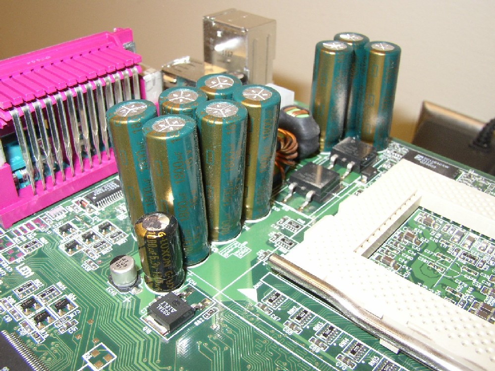

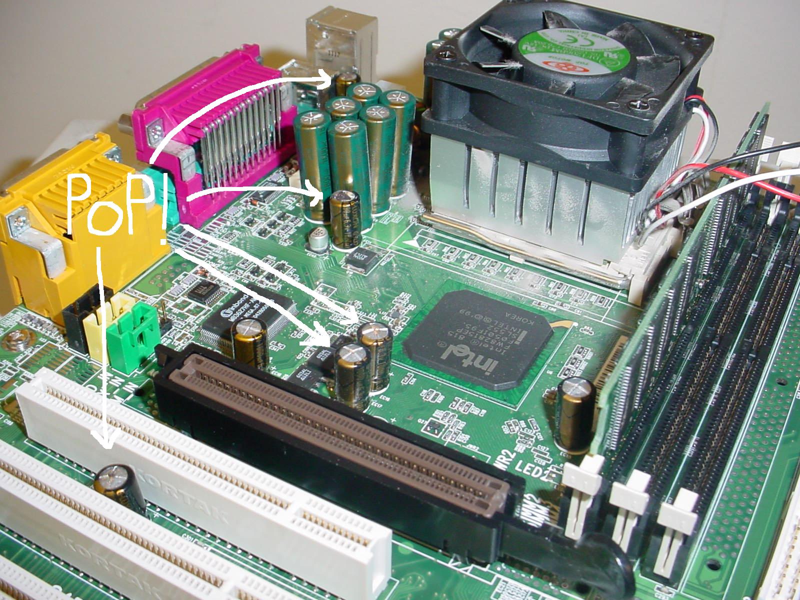

    I am very happy I found this forum! I am at a site with 100+ systems that are using the MSI MS-6337 Lite 815EP PRO VER:3 motherboards, some of which are freezing. The tech that was here before me had replaced many motherboards under warrenty, then started paying $75 bucks a board to have them replaced. (I now see that the replacement boards were never recapped, just replaced with another new board with the same bad caps) When I got here I replaced 5 motherboards in 3 months at the increased price of $85 a board, so I started to search for a reason these boards were going bad. I saw the caps had popped and figured that something was causing them to go, I never dreamed it was the caps themselves!
    Anyway, I want to take a stab at recapping the boards. The caps are:
    Chhis HK (M) 1000 uF 6.3v 8mm x 14mm (d x h)
    TEAPO SM105°C 04/01 A3 1800 uF 16v 10mm x 30mm (d x h)
    A few boards have G-Luxon 1000uF 6.3v 8mm x 14mm (d x h)
    The Chhiss and G-Luxons are the ones I see popped the most. Once in a while I see the TEAPOs with a bit of crust on top.
    I have a few questions:
    1. If I see one cap burst should I do them all?

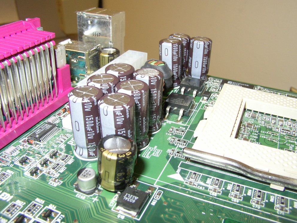

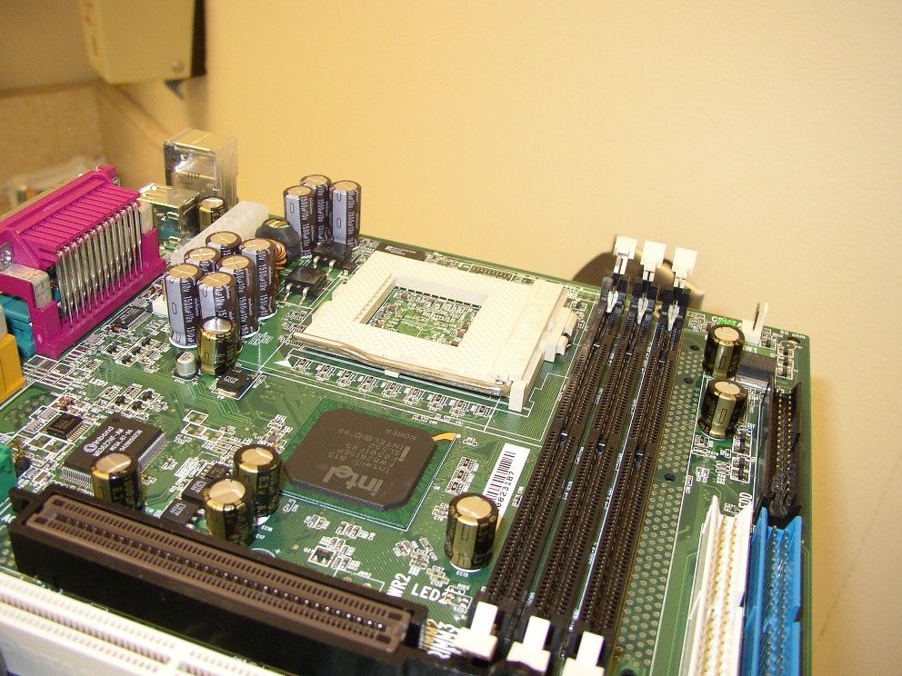

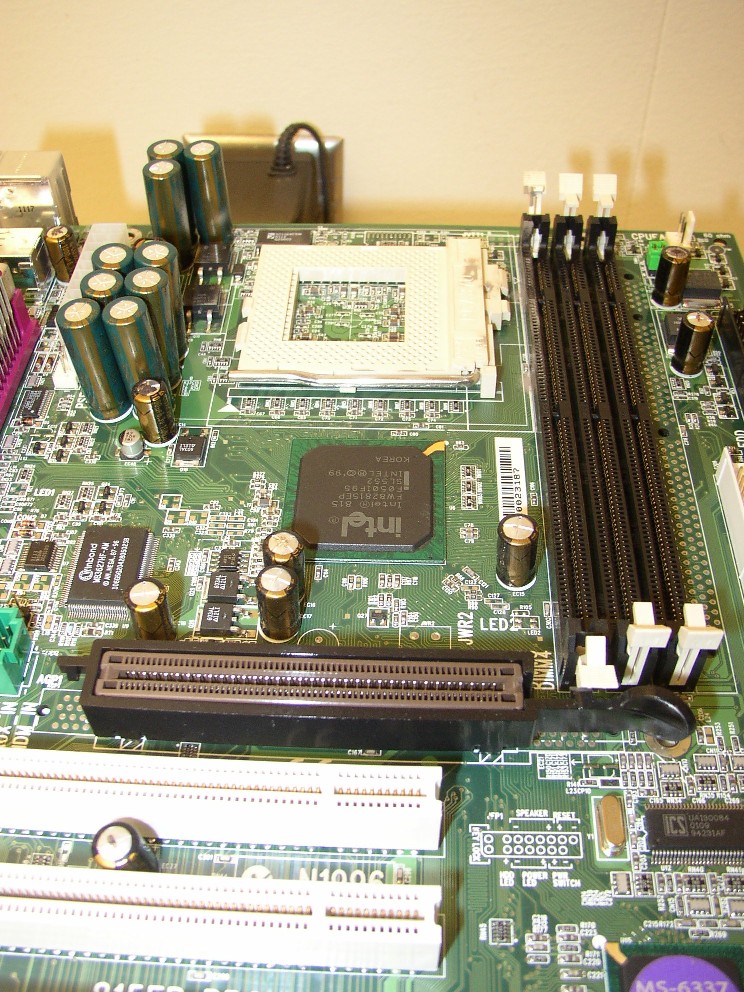

                    Thanks for all the advice! I have a Hakko 936 with the 907 ESD iron on order. I'm going with Panasonic FM 1000uF 6.3v and Nichicon PW 1500uF 10v caps. I'll post before and after pics when I'm done with my first board. Wish me luck!
                    • Holothurian
                      • Mar 2006
                      • 6
                      Re: MSI MS-6337 Lite
                      Got my first board done and it posted just fine! It took about an hour and a half, 20 minutes to remove the caps, 45 minutes to clear the holes, 15 minutes to solder the caps. Hopefully the rest will go faster. I'll probably get a real circuit board holder which should help speed things up, trying to support the board in a drawer and apply the iron to one side and the de-solder bulb on the other was quite a balancing act. I used a de-solder bulb to clear most of the holes and the needle/pick method for the ones the bulb couldn't clear, especially the positive lead of the one nearest the power supply molex. I might go with the needle method completely on the next board. Thanks to everyone for your tips!
                      One down, twelve to go.
