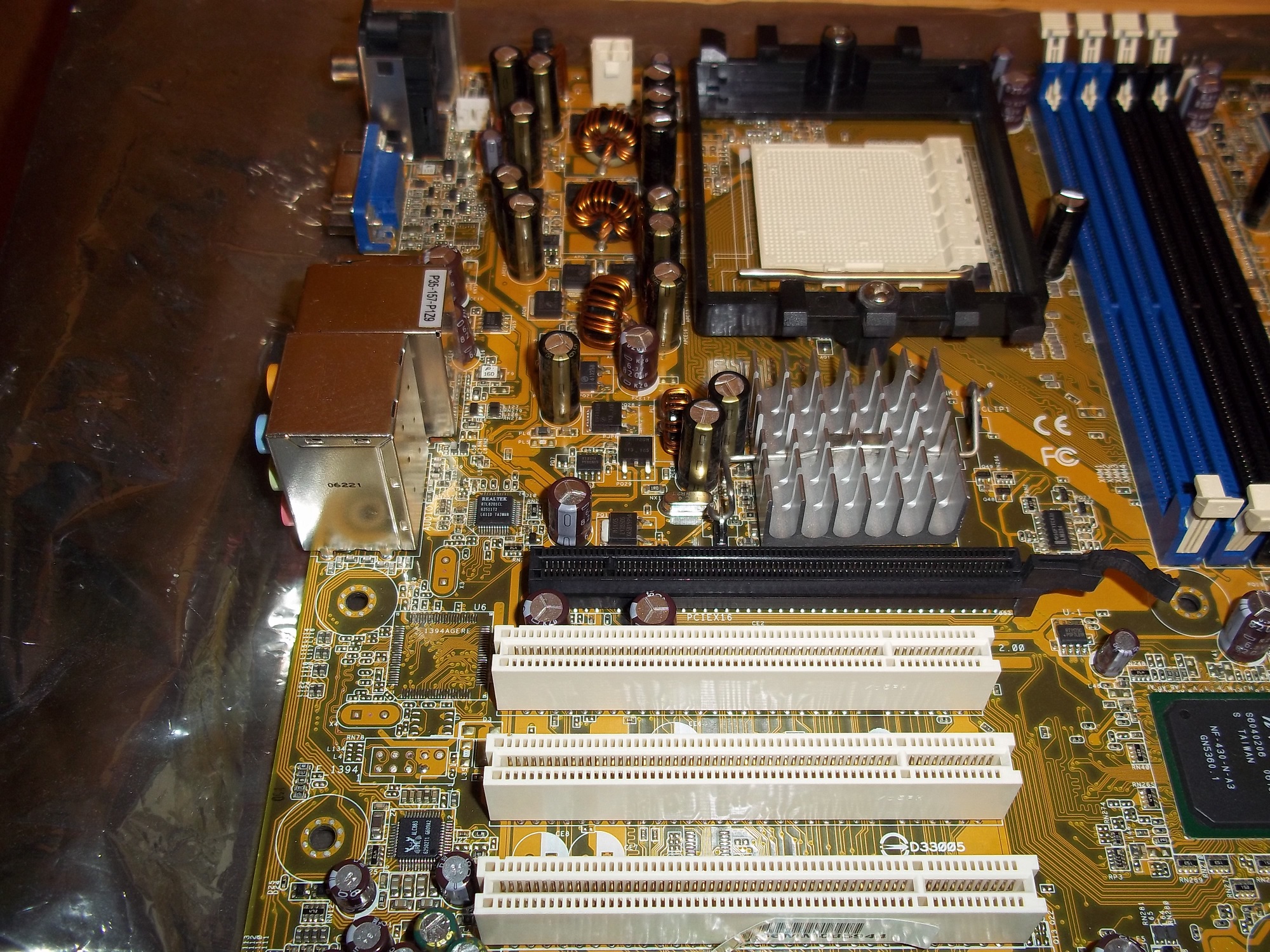

    I just got done recapping all the KZG caps on an A8N-LA board.
    This board was dead when I got it, it would automatically turn on and do nothing after troubleshooting memory and power. The only thing that made me recap it was the three blown KZG.
    There were 12x 820, 2x 1800, 1x 470 all kzg and at 6.3v. I replaced 2 with 1800uf 6.3 HN, one with 470uf 6.3 HN and the rest rubycon MCZ 820uf. I bought the caps from badcaps.net.
    After the recap, it still did the same thing like it was shorted somewhere. I bumped my hand into one of the Panasonic FJ 1500uF 6.3v near the heatsink. At that moment I wasn't paying attention and was trying to troubleshoot the system. I decided to try again and the system did post but far from stable. I ask myself what changed, then I remember what I did.
    What I have noticed is that 5 of panasonic FJ are loose like the leads are loose in the bungs. Four of these are near where a group of blown KZG, one between the heatsink and memory, This one is really loose.
    Am I correct to assume that these FJ have failed or are going bad or is it something else?
    There's also acouple of small Panasonic 100uf 16v scatter across the board, could these be causing problems too?
    What could be causing the board to work intermittently?

        1) It could be the power supply

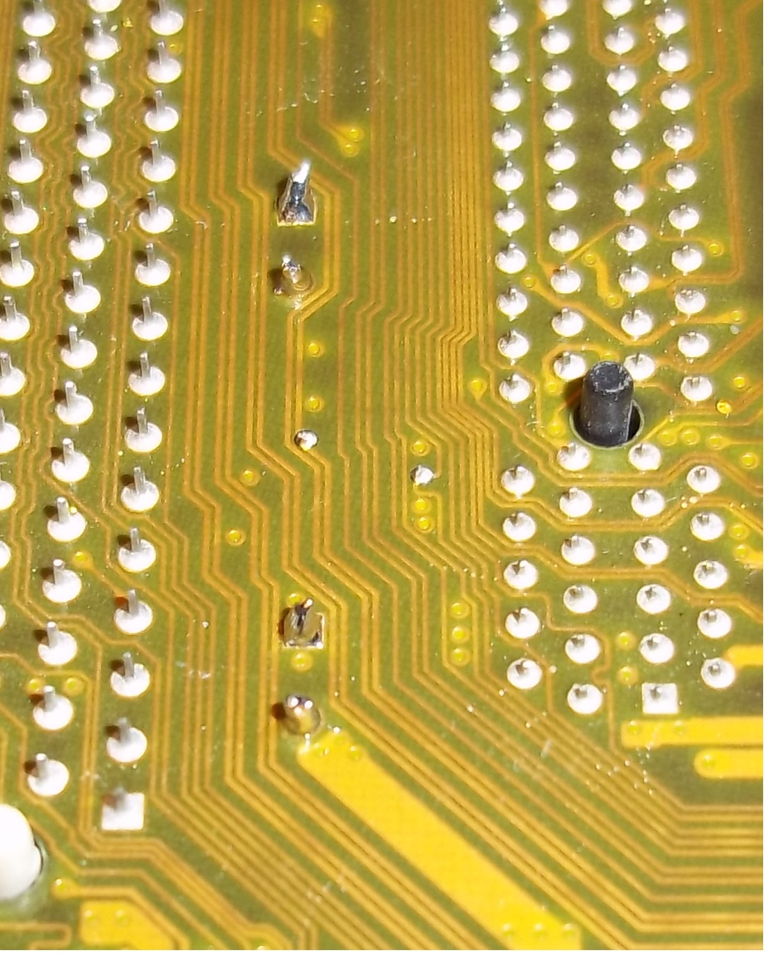

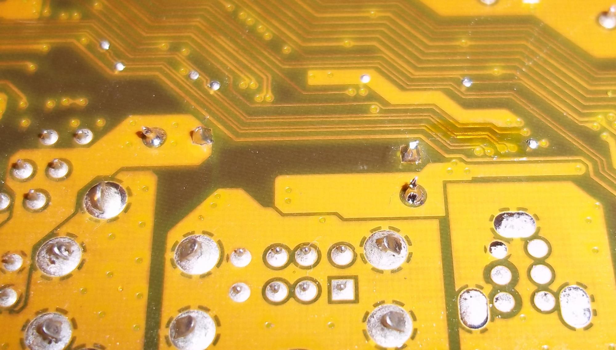

        2) Not to offend you, but it could be the work. Post pics of your solder joints so we can judge if your work is competent.

          1: It plugged into a new but known to work PSU, it's Thermaltake 450W I just got it acouple of weeks ago and have been using it.
          2:... down below.
          I managed to get it to post and boot into memtest and it did one pass fine. But when it resets it hangs, or if I do ctrl-alt-del it hangs too. It's acting like I have bad caps or something.

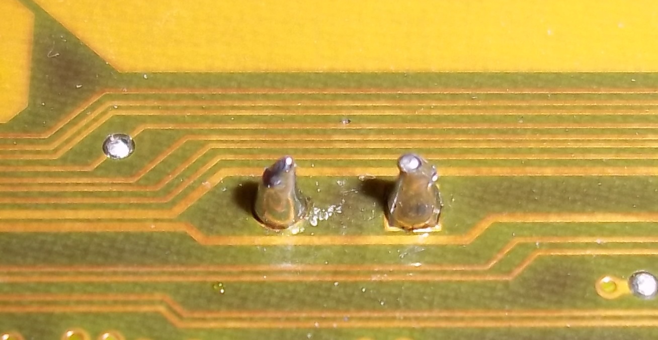

            Thermaltake is making me frown a little bit but it would be wise to replace ALL the capacitors at this point. What have you got to lose. Badcaps has all the 8mm ones I think. Check the Samxon stock.
            Your soldering is good BTW.

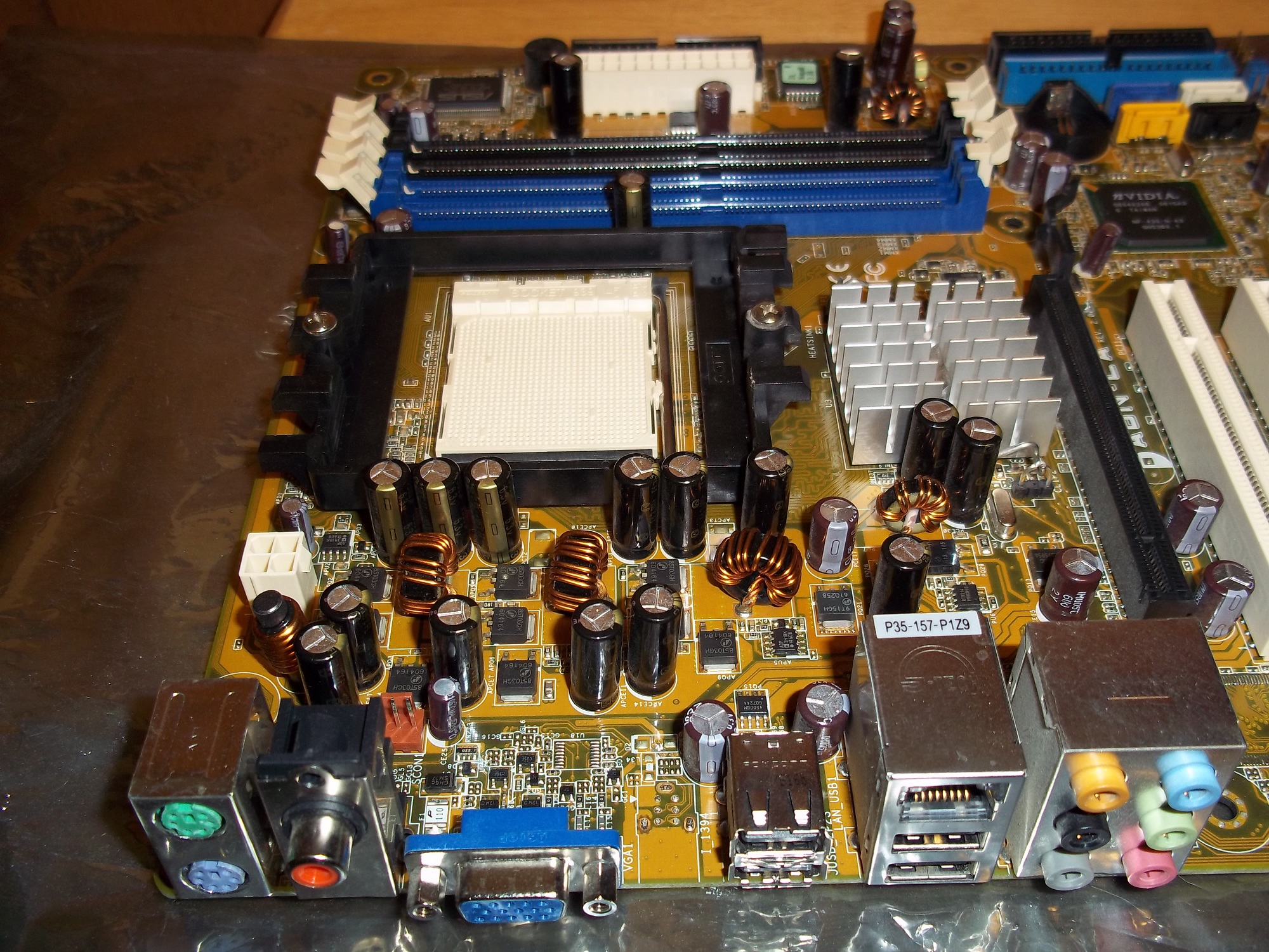

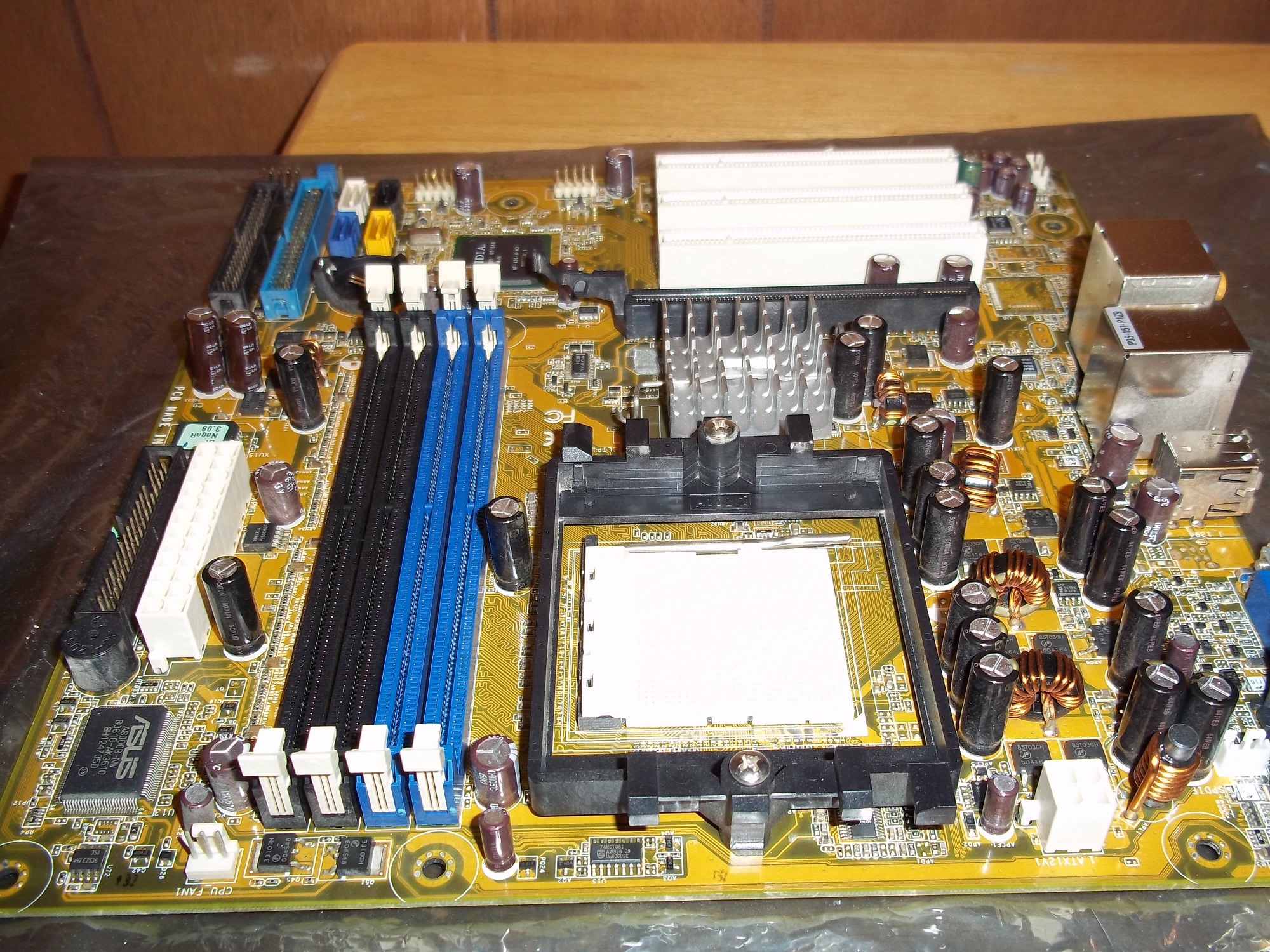

              If photos are from after the work you still have KZG scattered about.
              If you are using 4 sticks of RAM then try it with two.
              Less load on RAM VR and MCH.
              Also some Asus are bitchy about what RAM you use.
              Might try another brand and double verify the specs on what you are using.

                Nope, I only took them before I began work, just as a precaution incase I didn't finish and had to run.
