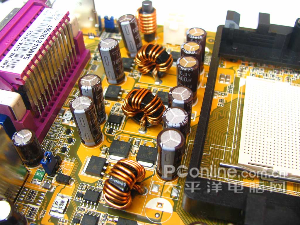

Recapping a a8ae-le and lost track of where the 470 micro F is located. If anyone knows the location it would be greatly appreceited. bill

Originally posted by kevin_12345 View PostI'm recapping this board too and have stupidly removed and lost track of where the three 16v 1000uf caps are located.

Yeah, you are most likely correct. There is those group of three near the parallel port also a group of three near the left upper cpu socket and a group of four at the left lower cpu socket. If someone has this board I'd like to confirm the location though before I change them back.
Re: A8ae-le
That is where I would expected to see the 1000uF 16V caps.
On the 3 or 4 ASUS boards that I have worked on, the 16V caps are normally in and around that parallel port area.--- begin sig file ---
--- end sig file ---
Re: A8ae-le
Those 16v in post #12 are VRM-in.
Not where you'd find a 470uF.
Some cheaped-out boards use 1000uF there but 1200-2200uF is far more common.
Those three -DO- need to be 16v caps, they are on 12v.
470uF in 16v show up in random places on boards.
They don't usually need the 16v rating as usually they are actually on 5v or less.
[Don't assume that... Check it with a meter or use a 16v cap...]
They wanted 470uF and the 8 or 10 mm can that 16v 470uF often come in to get ESR low.
The 16v was 'on sale' that week. [Joking, but you get the point I think.]
*If* the actual voltage is 5v or less then a 10v or 6.3v cap with the same or lower ESR will work fine.

Sorry, I kind of hijacked an old thread about the same board - different caps. The original poster solved the 470 location problem early on. The 16v 1000uf I was looking for are probably for the main 12v input. The board actually boots and runs with the 6.3v there but it probably won't last long before they pop so I wanted to replace them with the correct ones.
