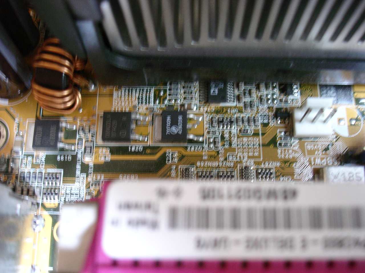

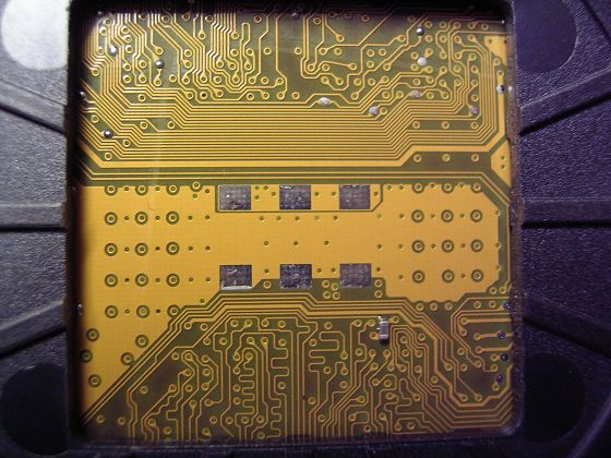

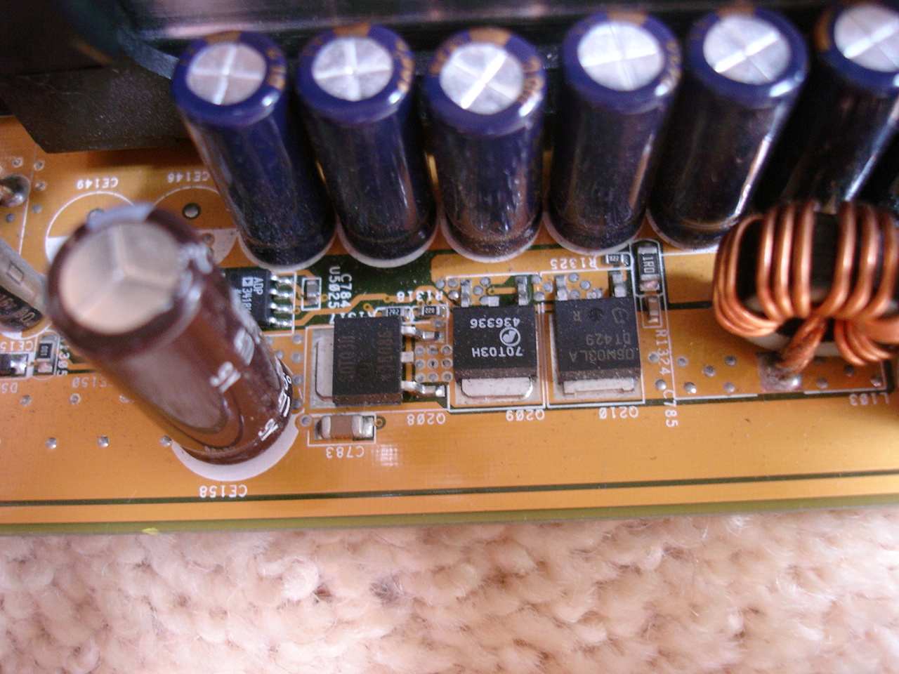

            Does that mean I've hit the jackpot with two recently acquired boards ?
            Refer pics - both have 3 FETs in 3 groups around the CPU, whereas my other P4C800-E has 2 FETs and a blank pad in corresponding areas
            Both boards work, but I was thinking of expunging OSTs from the VRM and all 1000uf 6.3v Ltec's

              Could you re-take the second shot and/or report the numbers of any of the groups. I can't make out the other numbers for the dust or shaking. Little too much coffee today?
              I was mistaken. There are 3 of these used. The 2 you have pictured, and another on the RAM side of the CPU.
              Unfortunately, the 70T03H MOSFET is no longer available. Best bet will probably be salvage from dead boards. I have the Asus A7VBX-MX which uses 4 of them. That does 1 board for me, with 1 piece left over. I have not investigated a cross reference, yet.
              It's not a big deal, as they've been working many years with just the 3 pairs.

                  Here's my report:
                  Right of CPU are Q208, Q209 & Q210
                  Above CPU are Q199, Q201 & Q202
                  Below CPU are Q193, Q195 & Q196
                  On the three FET models:
                  Q193 = Q199 = Q208 = 60T03H
                  ................................438086
                  Q195 = Q201 = Q210 = 06N03LA
                  ................................DT429
                  Q196 = Q202 = Q209 = 70T03H
                  ................................436336
                  On the two FET model:
                  Q193 = Q199 = Q208 = MRC
                  ................................D38NH
                  ................................02L
                  ................................301347
                  Q195 = Q201 = Q210 = D0324
                  ................................FDD
                  ................................6606
                  Q196 = Q202 = Q209 = Empty
