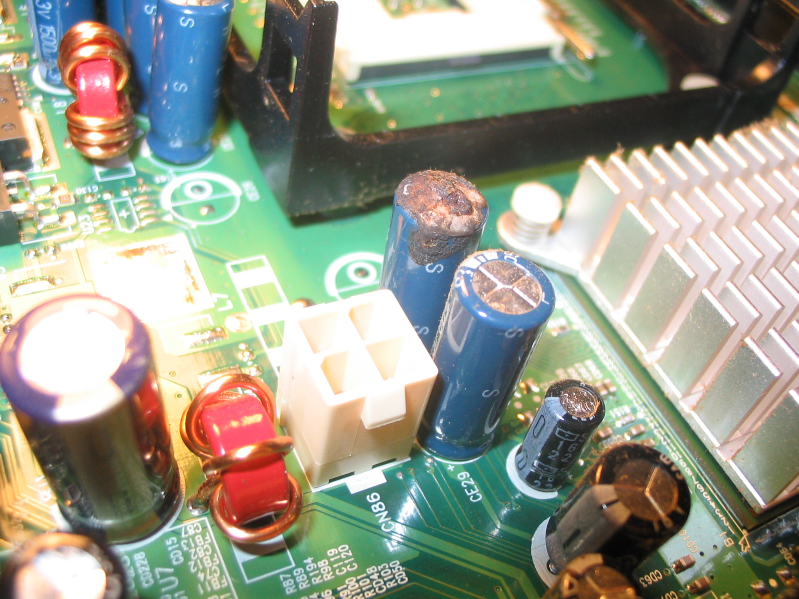

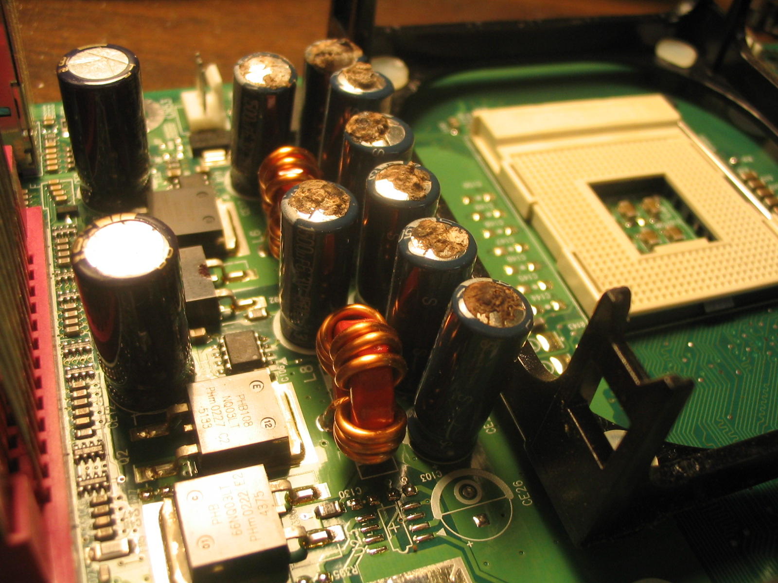

    HP 533 w/Trigem
    I've run across a couple of these, the Trigems are always horrible. The bad caps are TMS; note the Rubycons sitting pretty beside the leakers in the photos.
    I read this thread:
    https://www.badcaps.net/forum/showth...highlight=533w
    According to HP, the "Echo" is an Asus-built board. The two Trigem-equipped models I've seen were purchased at Wal-Mart.

    Re: HP 533 w/Trigem
    TMS are some of the sh*ttiest caps around. It has been joked that TMS stands for Total Monkey Sh*t.

      Re: HP 533 w/Trigem
      Have never seen such gross looking caps. TMS gets my vote for dubious honour in bad caps list.

        Re: HP 533 w/Trigem
        Those TMS caps are the caps which in my list leak the most. I have a Trigem board in an anti-static bag. I checked its caps and it doesn't have TMS caps. It has United Chemi-Con caps in the place of the TMS caps go on the Trigem boards seen here. And those United Chemi-Con caps came original on that board, really! That thing was from an HP Pavilion 514n system.
