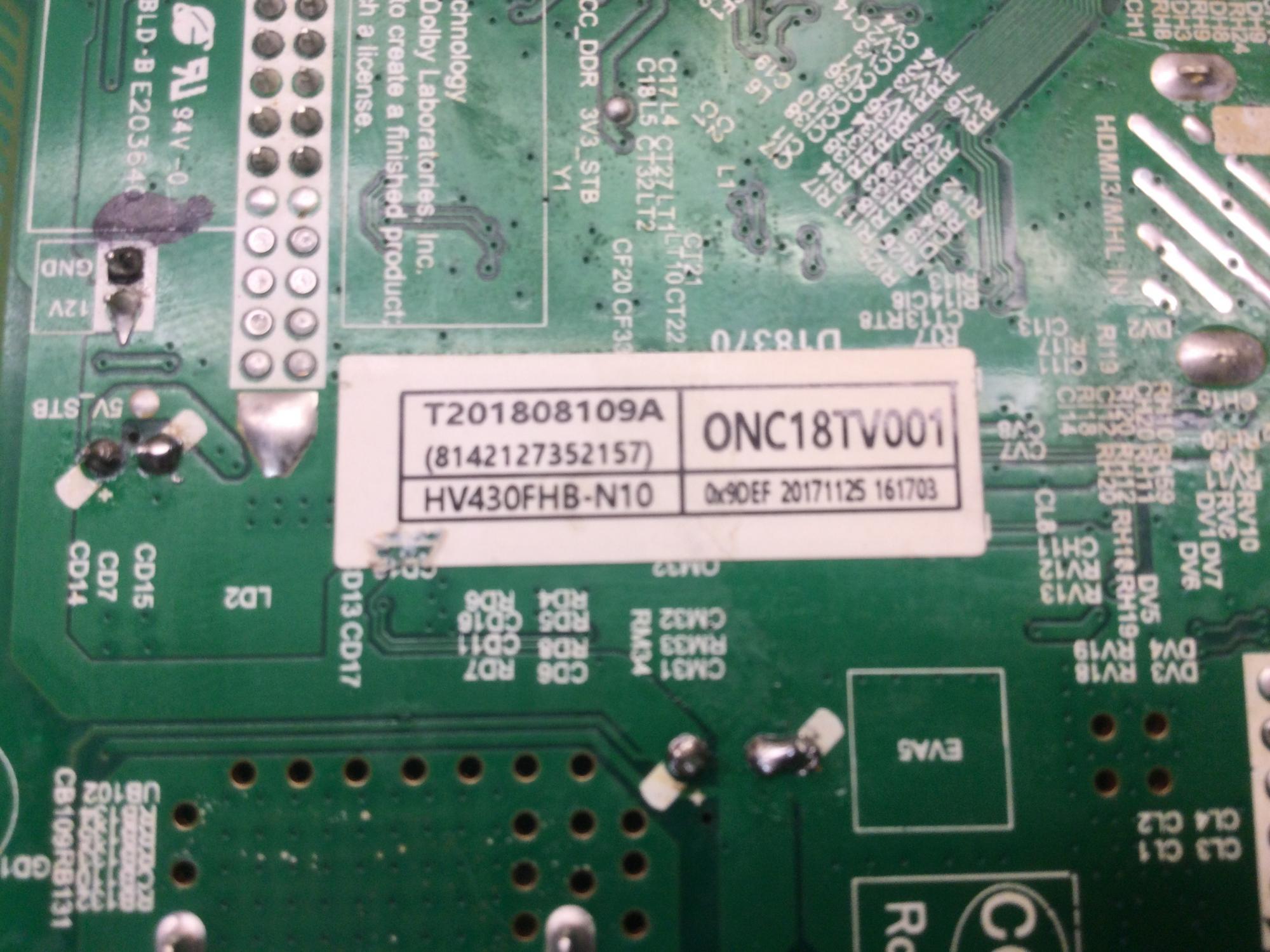

    I have a model ONC18TV001 made for Walmart. I was hoping maybe someone has a schematic or can help me with an IC part number. The LED driver IC has failed. I cannot read the marking on the IC. Looks like a 10 pin msop package. Thank you.

    Re: Onn Tv made for Walmart
    You need to attach some clear, in focus pictures of the board, it is likely used in other makes/models.

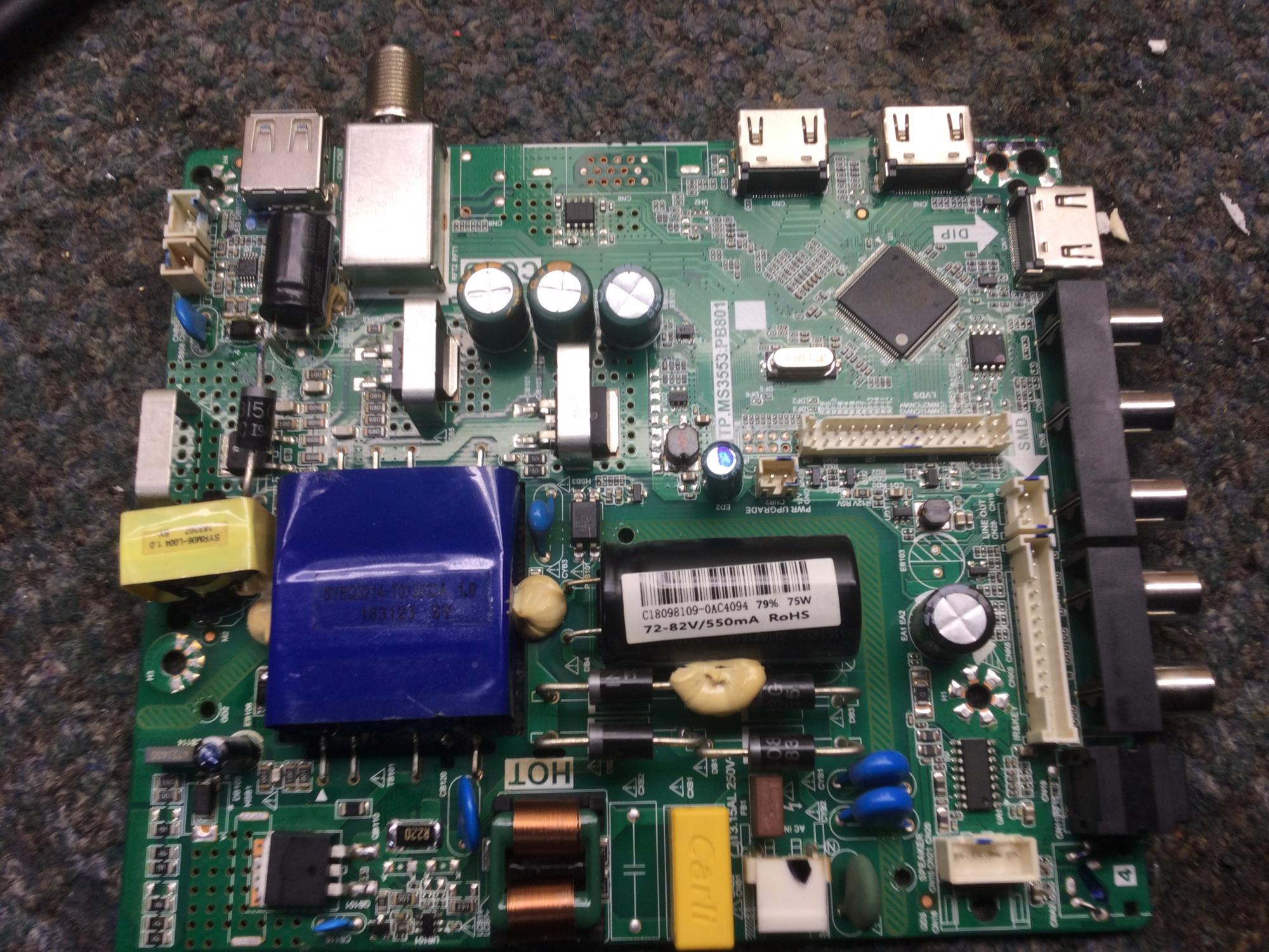

        Here are some pix as promised.

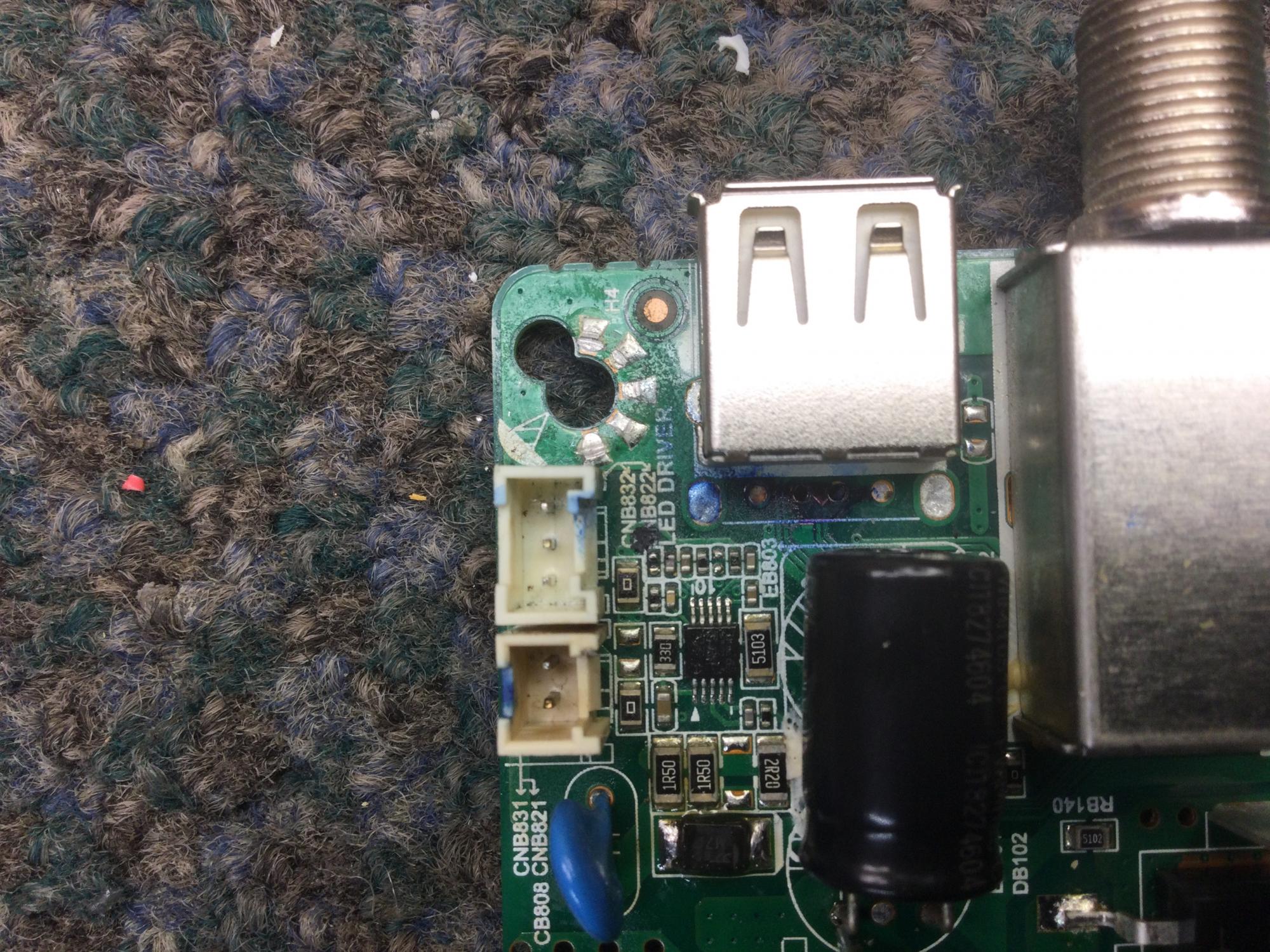

          Are you sure the ic is bad and not bad led's in the panel? Try using some alcohol to clean the top of the ic. you should be able to read the number.
            It looks like there is sime sort of varnish on the top of it that would need to be cleaned off. Sometimes using a bright torch light shone at an angle on the IC can help you read what is written on it.
                I will try to clean it off. Thank you again. The LED backlights are completely removed and there was a short across an smd diode on the power supply board. I took it out and it tested fine. I traced both sides of the diode as best as possible and it appeared to go back to the LED driver IC.
                I will reply back with my cleaning job.

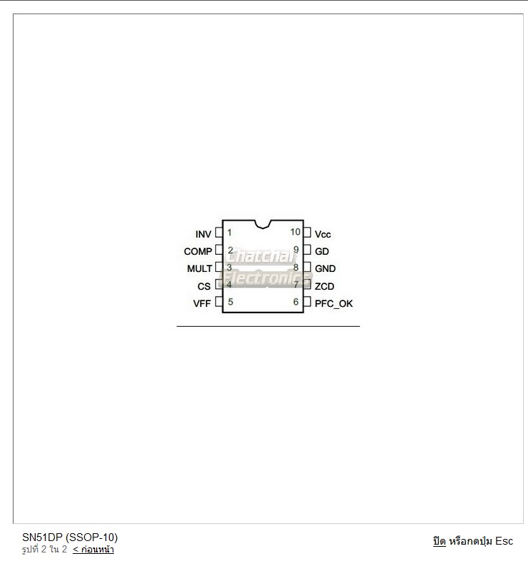

                  I managed to clean it off. While it was a bit damp I was able to read the number. It is SN51DP. I will start testing voltages at each pin now that I know the pinout. I will check for pin to pin and pin to ground shorts. Thank you all VERY much.

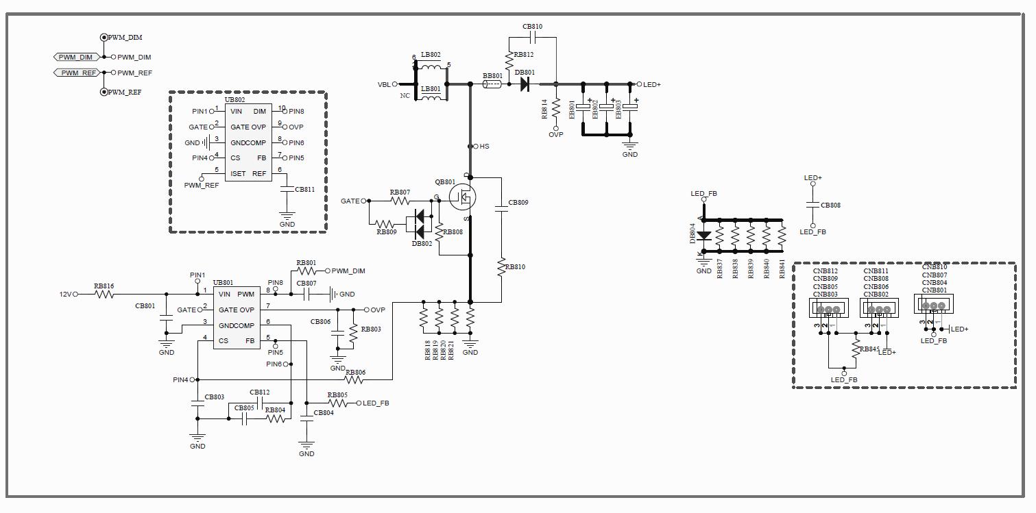

                    This may be the circuit, or close to it.
                      This is the possible pinout for the iC
                      Edit
                      But it doesn't match the information on another site that appears to be as R_J suggests.
                      https://repowebapps.blogspot.com/202...verter-by.html
