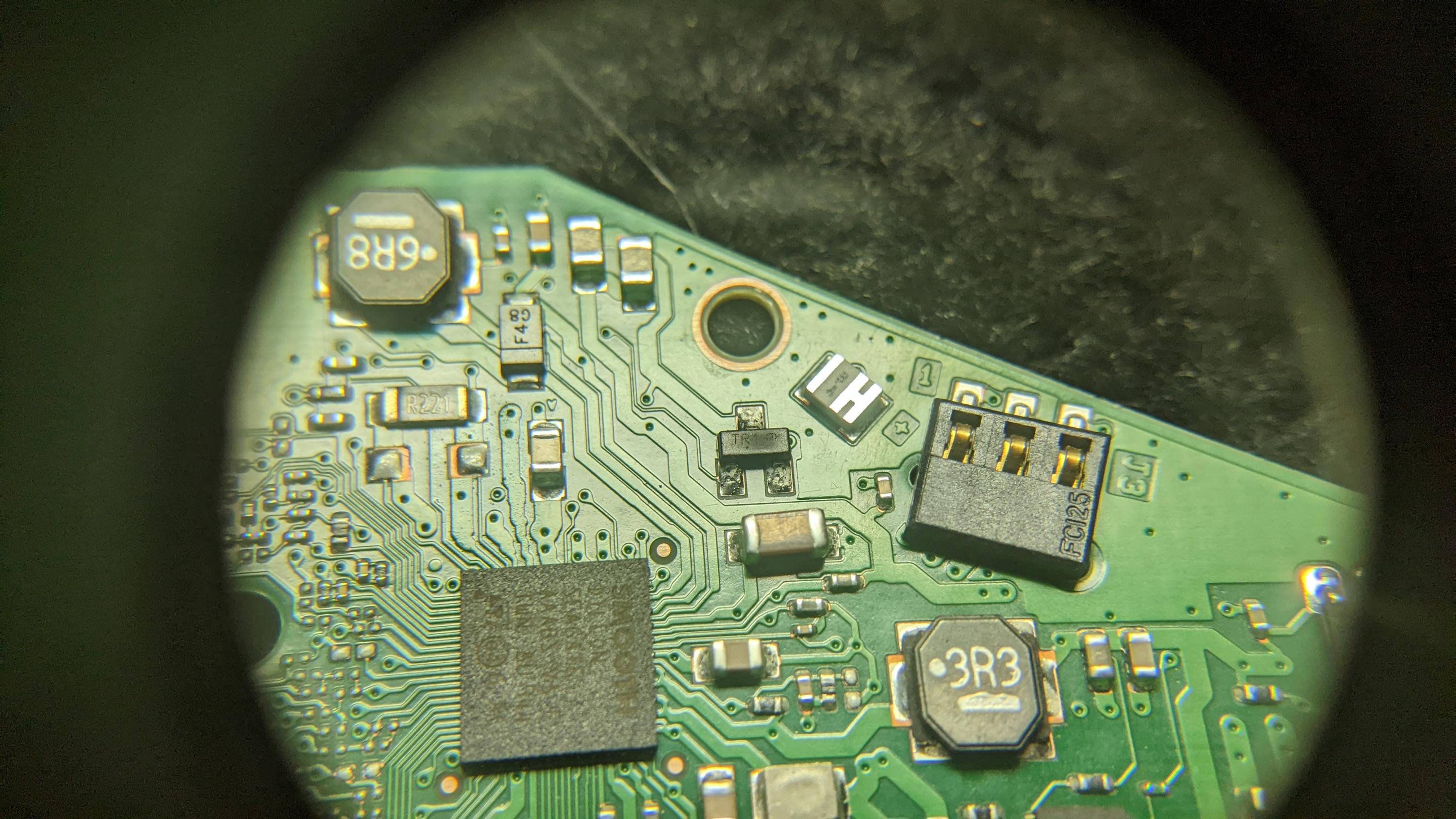

    I had a look at the board with a magnifying loupe and this mosfet looks like it's a bit burned.
    TR1 9
    Would that cause the symptoms I am having?
    The drive stops being accessible after about 2 minutes?

        Yeah the NTR4501 "TR1" mosfet looks a bit faded in the middle.
        I would point a cooling fan at the board and see if that helps enough to mirror the drive.
        After 2 minutes it usually does a servo recalibrate due to temperature change.
        Ensure the flex cable connections to the head are not oxidized, if they are just copper.

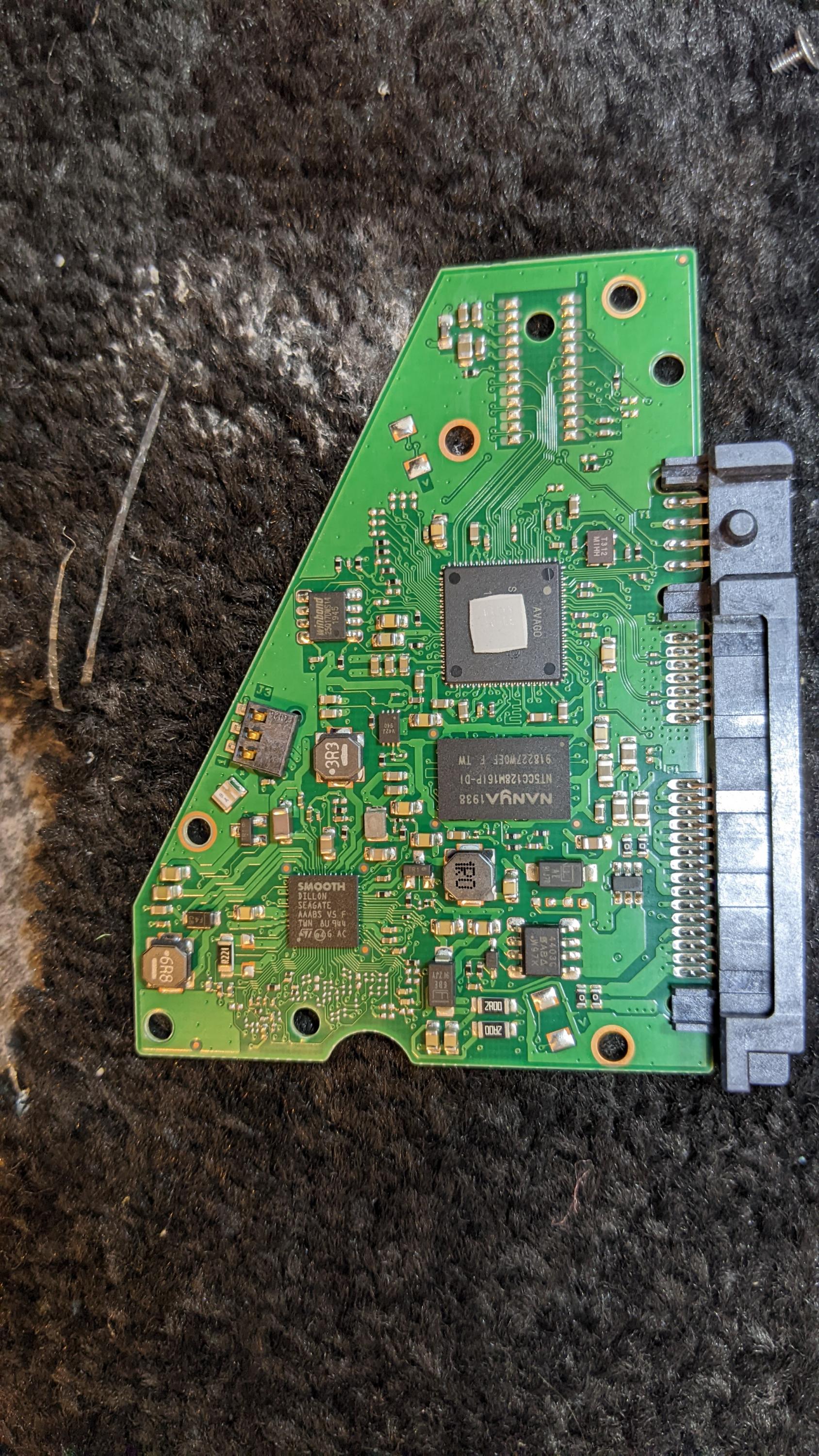

            I got a replacement hard drive motherboard (used but working from Aliexpress) and successfully swapped the firmware chip from my bad drive to the new board as my pc recognised it straight away and I could access the files but, I
            was back to square one with the drive stopping after 2 minutes.
            So the board is very likely not the fault.

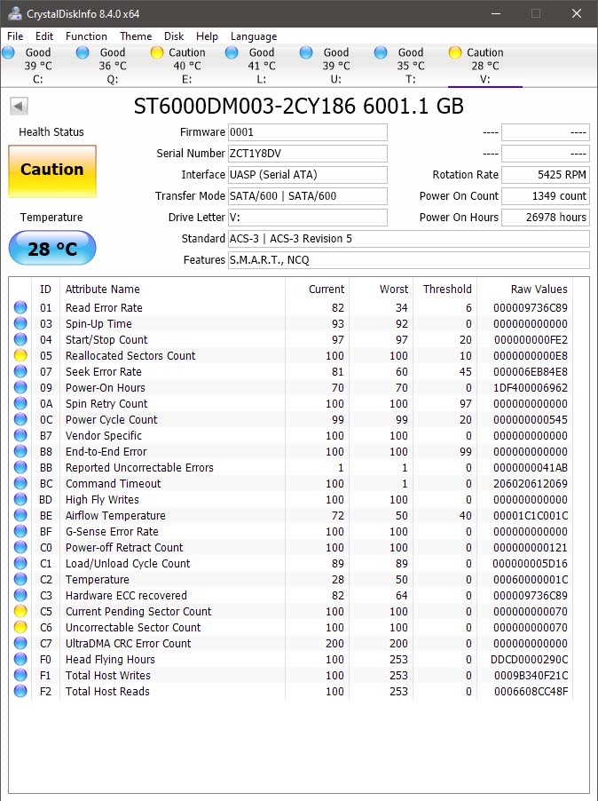

                I've only recently looked at the smart info and it shows as "Caution reallocated sector count" (image attached) which after a quick google search is supposed to be unfixable.

                  232 reallocatated sectors? Time for it to meed the hammer.

                    Ah, you have a -DM003 series drive - a.k.a. DooMed drive. These are known to be unreliable.
                    Before you chuck it or turn it into something more useful like this, see if Seagate has a firmware update for it. IIRC, for some of these, Seagate released firmware updates that fixed some of the issues... though bad sectors is probably related to the magnetic coating deteriorating.
                    My worst one (ironically also a Seagate) has over 1000 bad sectors and still works OK. It's an old 500 GB from the 7200.12 series, IIRC.
                    I also have one older Toshiba 500 GB HDD that has even more bad sectors. That one, I just "isolated" the bad sectors into their own partitions and can still use the HDD for data storage on the "good" partitions. Haven't used it much, but for the few times I did, it's been OK.

                      Main concern is "Current Pending Sector Count" and "Uncorrectable Sector Count", means there are sectors that are unable to be read and could not be reallocated. It can only get worse (and it often does over time). Firmware is probably trying its best to read and reallocate sectors in the background but cannot do so. Drive is dead.
