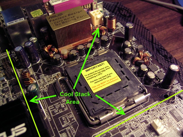

    Does anyone have any tips on how to properly remove the capacitors that are attached to the cool stack board on my Asus P5AD2-E Premium board? I've been trying for about an hour now to get the bad caps out, but I just can't get the solder to melt completely around the leads. I wicked out the top layer on the cool stack board itself, but it looks like there's another layer on the actual motherboard underneath. I have a 40 watt Weller iron with the base cranked all the way up. I was able to remove the other caps that aren't attached to this cool stack with no troubles at all.

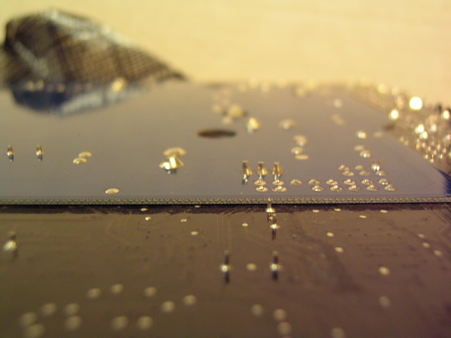

    Higher power iron and larger(wider) tip and use just the corner. Mine is a 3/16" wide, 800°F tip that does okay. None do well as these are through 2 circuit boards. Heat the other side of the board with a hair dryer to assist you, and leave it running while you work. Flux and add solder to each joint to increase the heat conduction.
    The Cool Stack works well, no?
    Which ones are you trying to remove?
    VCore is Panasonic FL, and VRM is Ruby MBZ. They're fine.
    The one ringer is an OST 1500uF that looks like a Ruby (same purple sleeve) on the corner of the CPU area towards the RAM. All the Ltec 820uF have to go.

              Not correct for multilayer boards. Definitely not correct for -this- board in -this- area. It is TWO boards under the CPU/VRM area with a small gap in between (think 1 piece of paper). It's heavily plated and double sided.
              Fortunately the only caps that probably need replacement are those I mentioned in Post 2, the "ringer" OST and the Ltec's.
