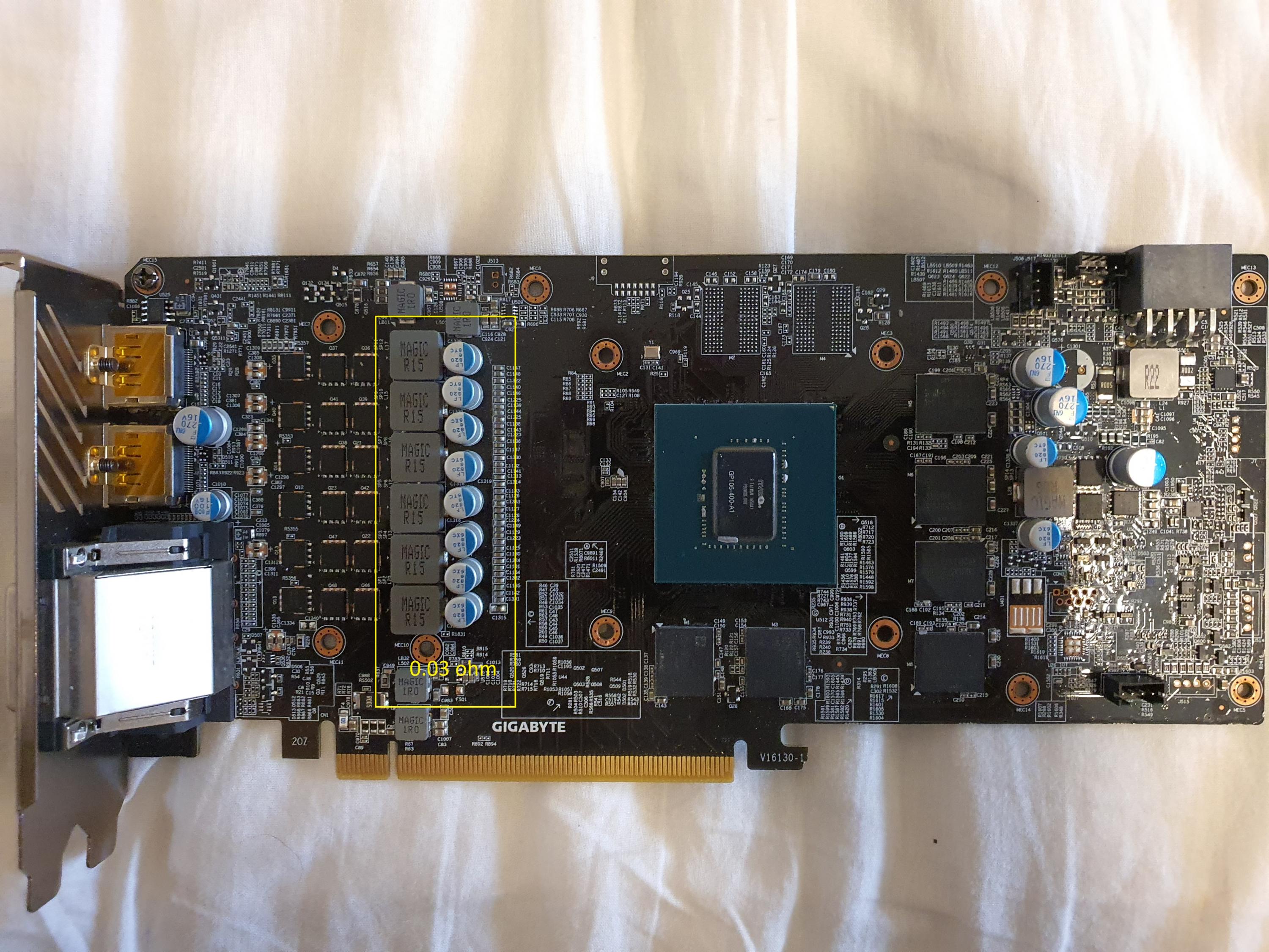

    gv-n1060g1 gaming-6gd dean
    If i have very low resistance on the GPU power supply coils, does it means its a dead GPU chip ?
    details in attached photo

    Re: gv-n1060g1 gaming-6gd dean
    u need miliohm meter or good multimeter to measure gpu ic resistance because it is very low so u cannot compare it to short
      maybe or maybe not! need best vom to mesure it! A normaly it resistance about value 5-7 ohm. Some sepcial case the resistance turn to under 0 ohm,but still working not full function about output port
        Can you help me on starting the process of testing it and see why it is not working ?
        I am usually dealing with laptop motherboards
          measure coils voltages
            Is the 12v connected enough or it must be connected to a powered on mobo?
              it MUST be connected to MB because of reset signals and other powers to work. so yes, u must have connected powered MB and u must have 12V PSU power. thats why everybody uses risers to have GPU off the board for better approach
                got it, thanks for advise i will try to arange it and post back
