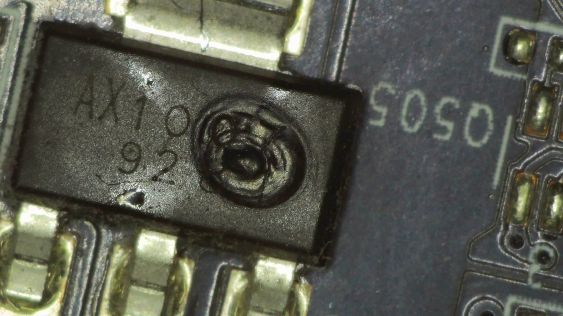

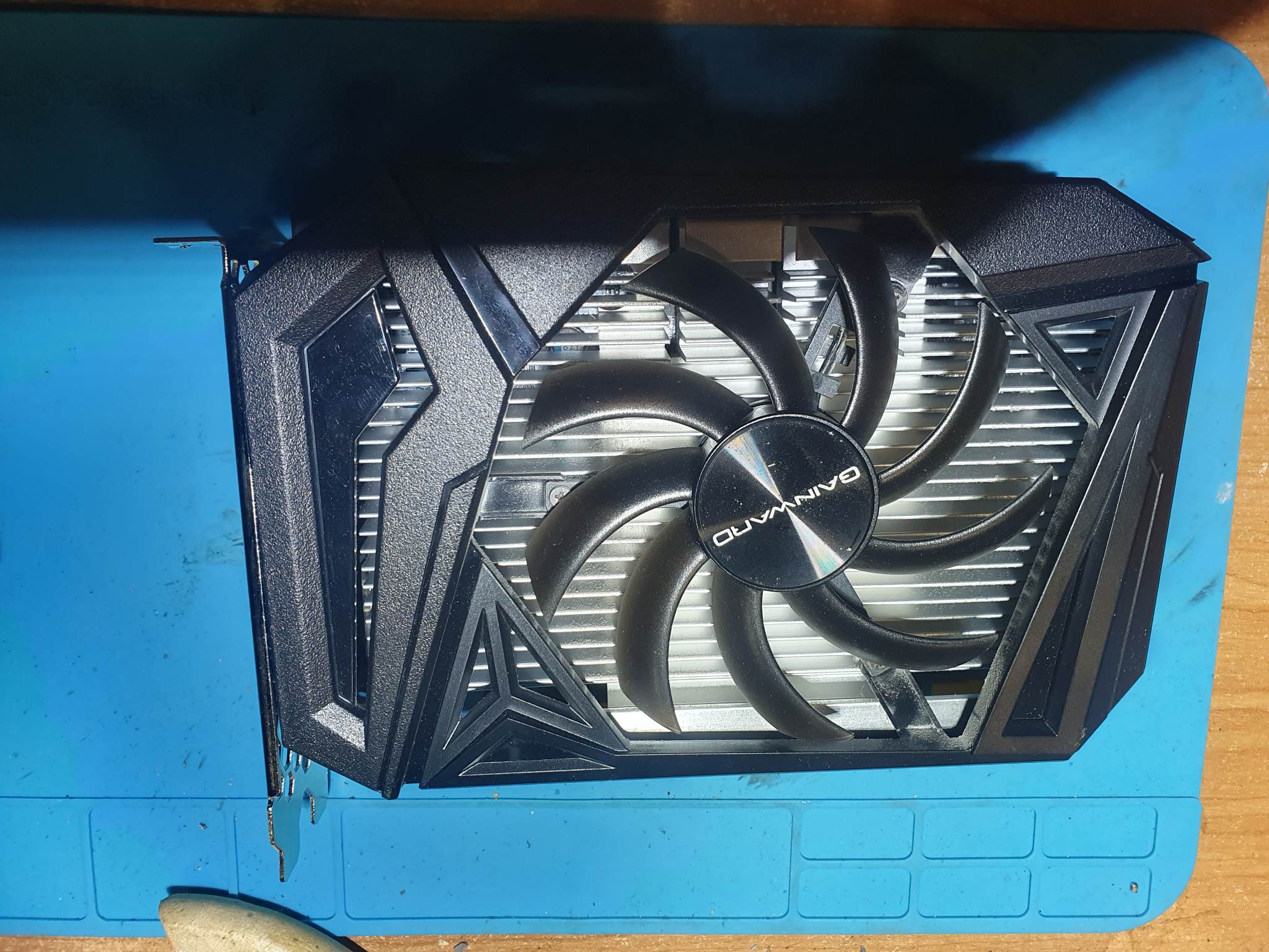

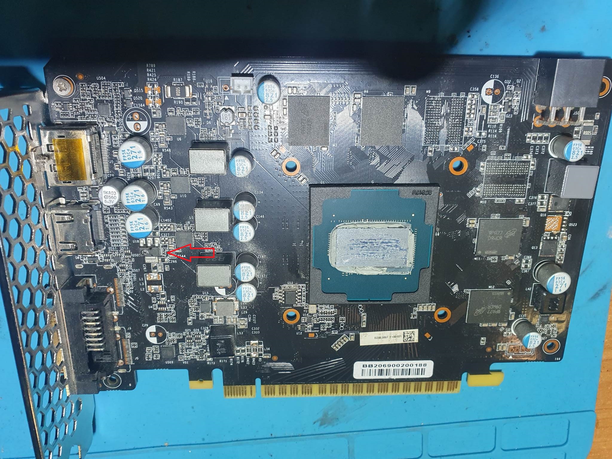

I have Gainward GTX1650 super pegasus with voltage regulator with hole on itself and i cant identify component. Please help
Gainward GTX1650 super pegasus need help to indentify voltage regulator
Re: Gainward GTX1650 super pegasus need help to indentify voltage regulator

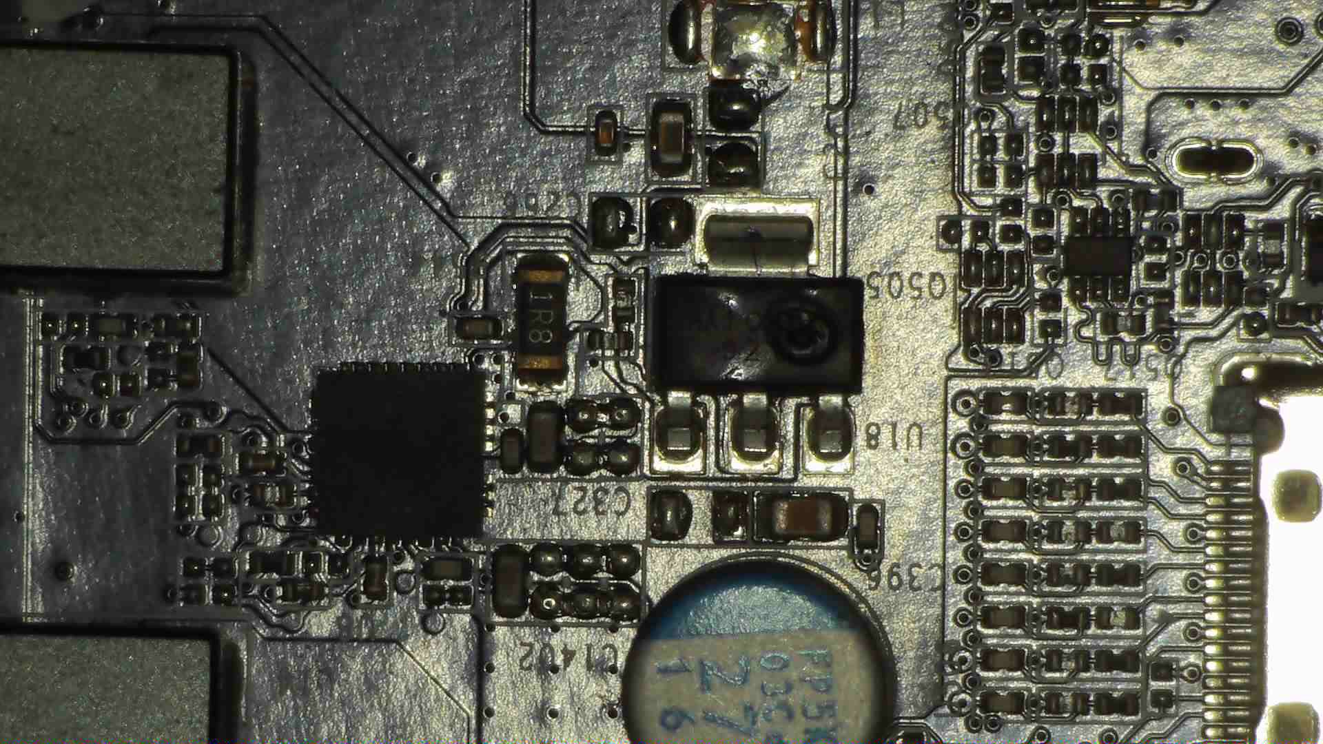

I get information that is ax1007 voltage regulator which one i probably can buy at aliexpres. This is very rare an probably have some equivalent and i will be very gratefull if somebody know something about that -

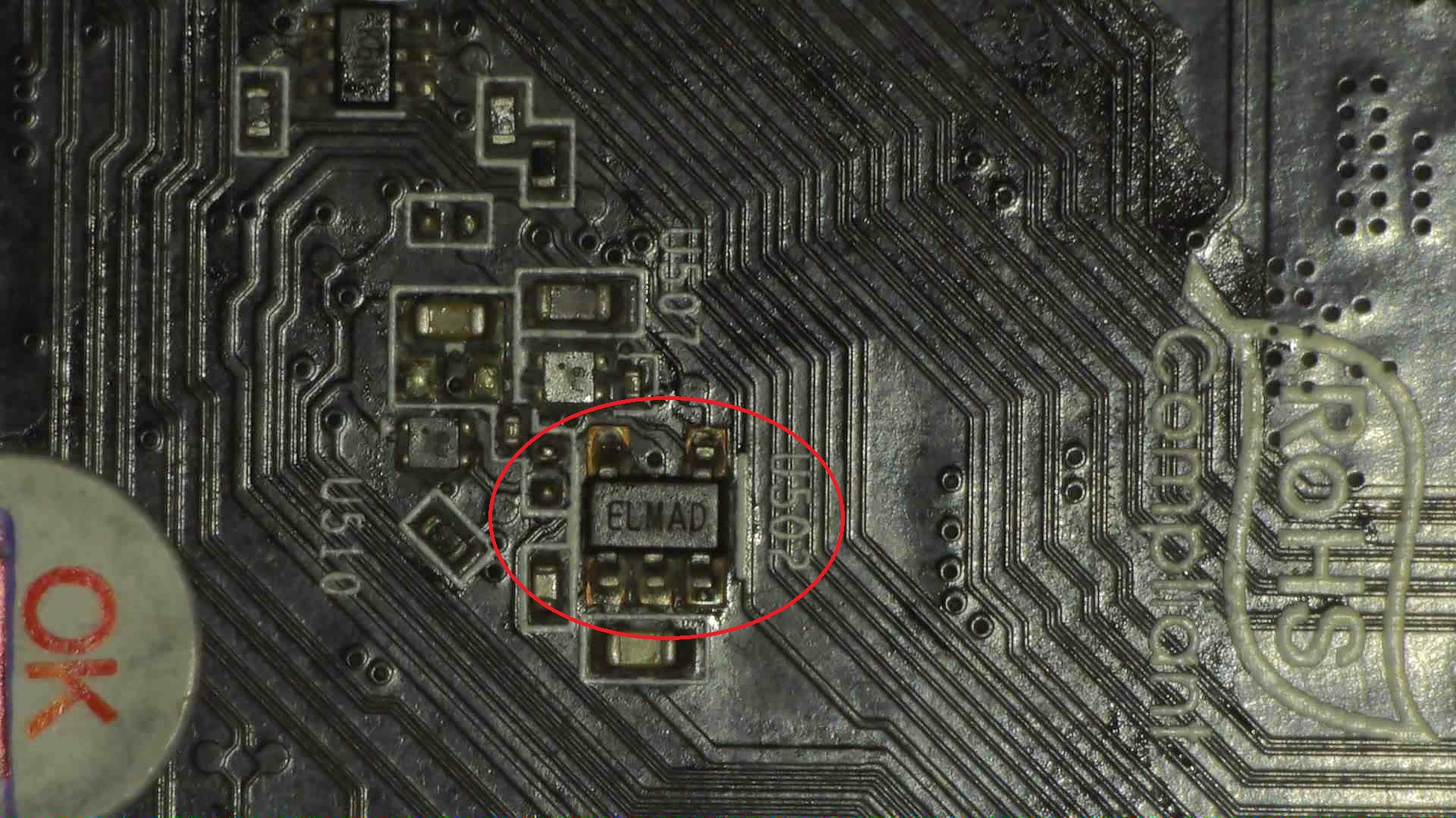

I remove this broken voltage regulator and start investigating why regulator burned. On the output i have 1 ohm impedance and i think that is problem. By voltage injection i discover one fast heating element which i remove and now i have impedance 11.5 ohm. On on the element is text ELMAD. If somebody know what is this element and is this impedance ok i wil be very grateful.Attached Filesif you find these attachements useful please consider making a small donation to the site
Thx for advice. I ordered that part . From my research that text are some smd code. And i hope that is some linear voltage regulator what indicates smd codes page https://www.s-manuals.com/smd/el . I ordered RT9193-33 too and we will see if that works
