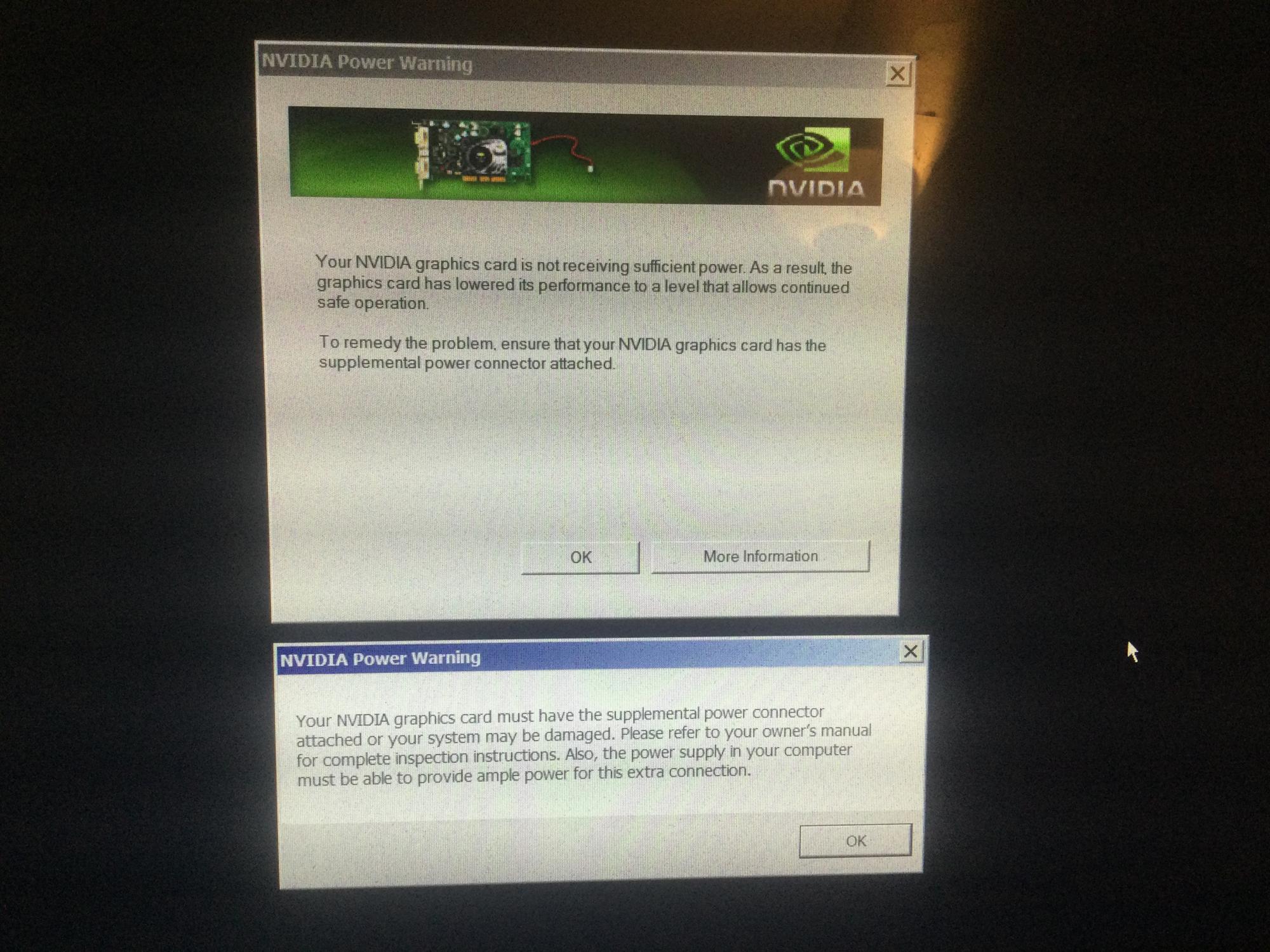

    whenever I booted into windows7, an onscreen message pops out - warning that nvidia card is not receiving enough power and is at reduced performance level. When I opened the case, the GPU fan on the nvidia card is not spinning. after a while, the card becomes extremely hot when touched. I have a new Cosair RMS 750Watts PSU for the pc - replaced an old TruePower 380Watt ATX12V Power Supply, and the extra molex connector on the AGP card is plugged in.

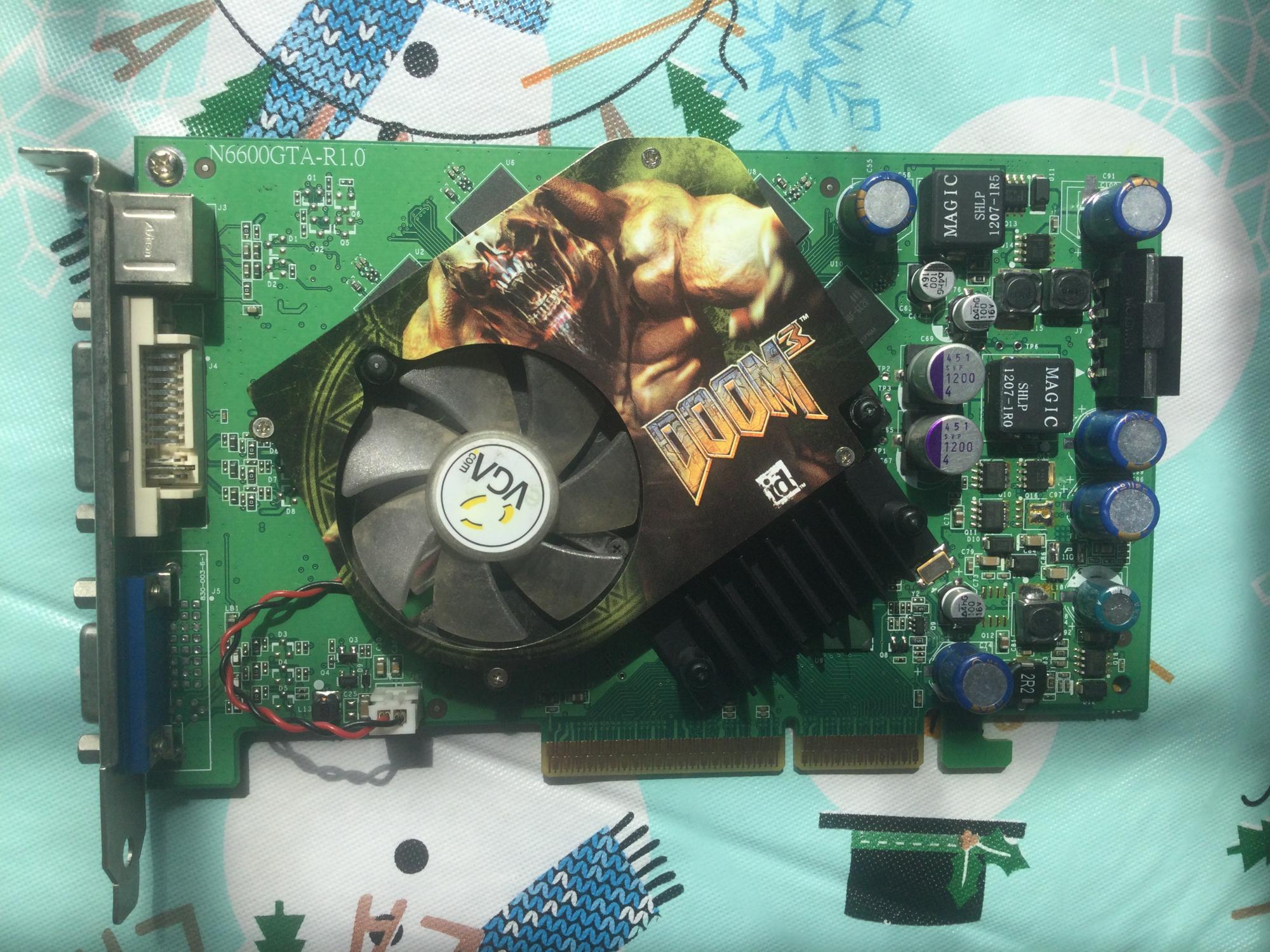

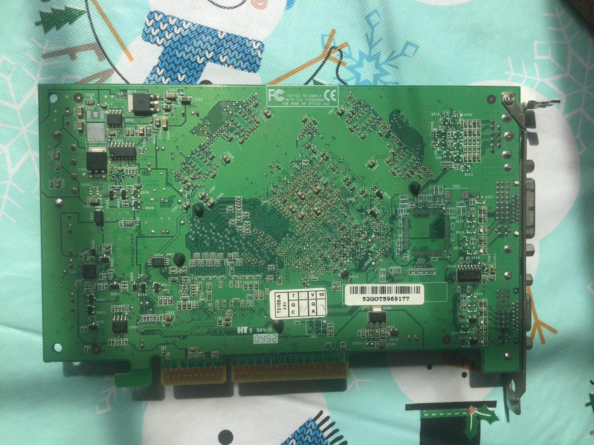

      Re: Help with GeForce 6600gt AGP Card not receiving enough power
      Here are the screenshot of error and pictures of actual card

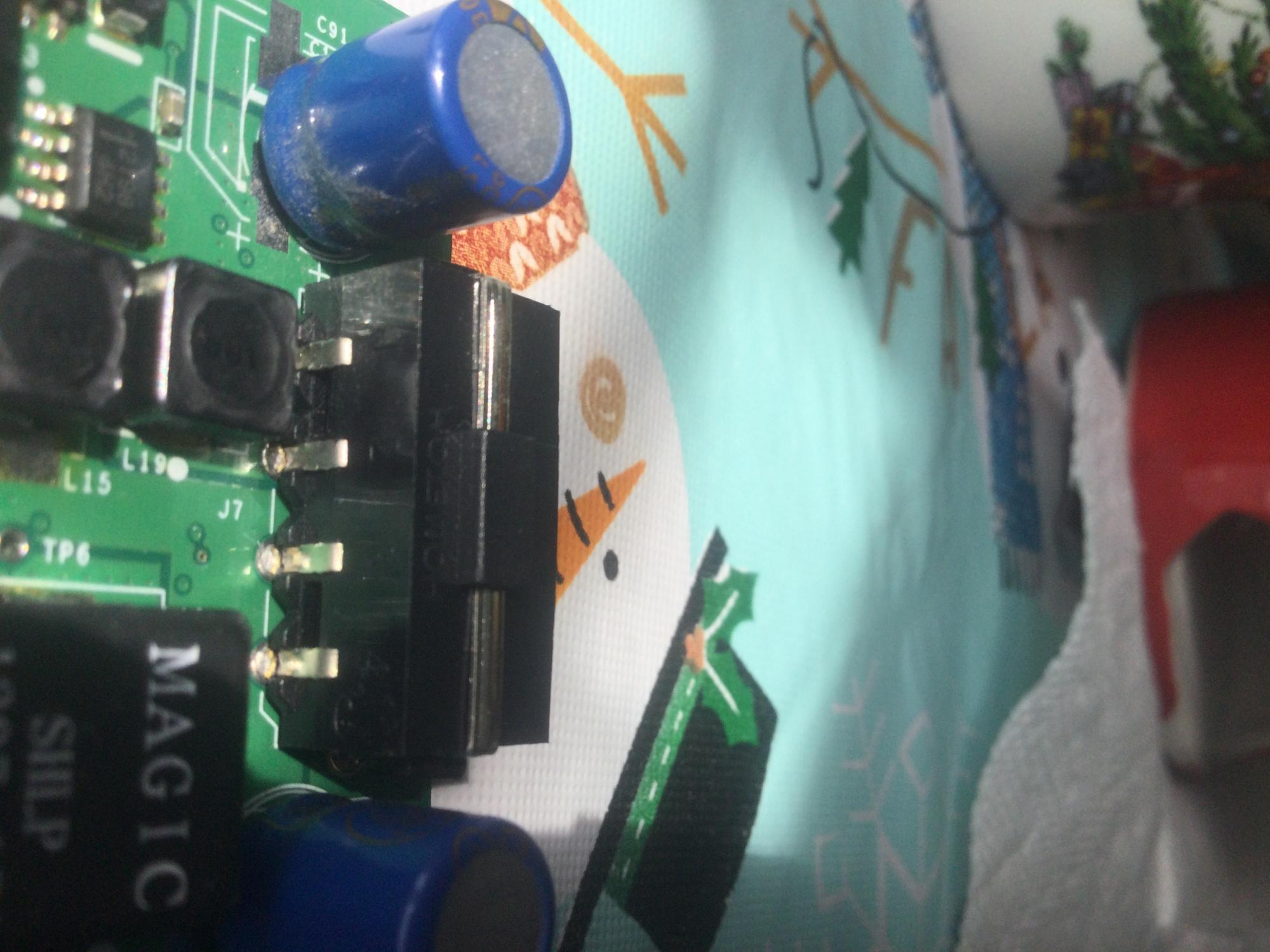

        Check the fuse (F1) top side, near empty Q16 It looks like a polyfuse so check the that you have voltage on both sides as it may reset without any current through it.
              pardon me for the late reply...
              Just revisiting the thread, i was onto other stuff but the graphics card stopped working completely recently, pc showing a blank screen during bootup.
              afterwards I took out the card from pc and checked the F1 as mentioned on the card, it shows continuity across the element, is that normal? or should i check it while the card is installed while pc is running?
