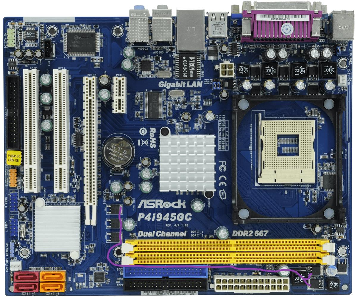

Issue:

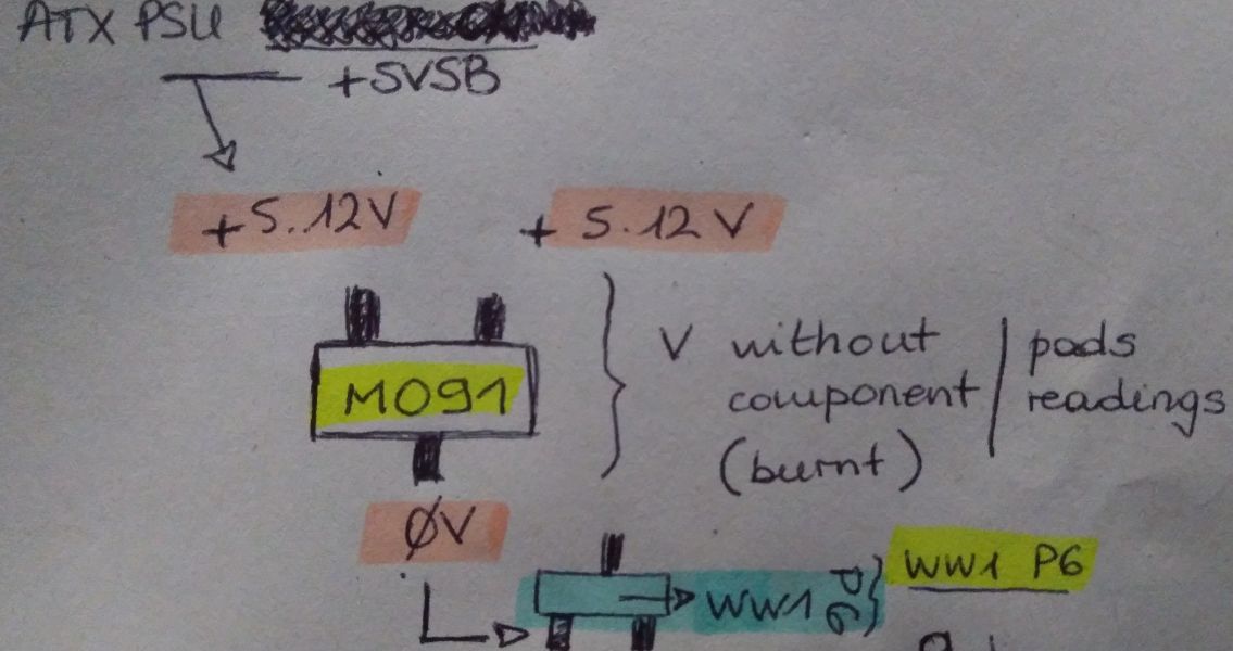

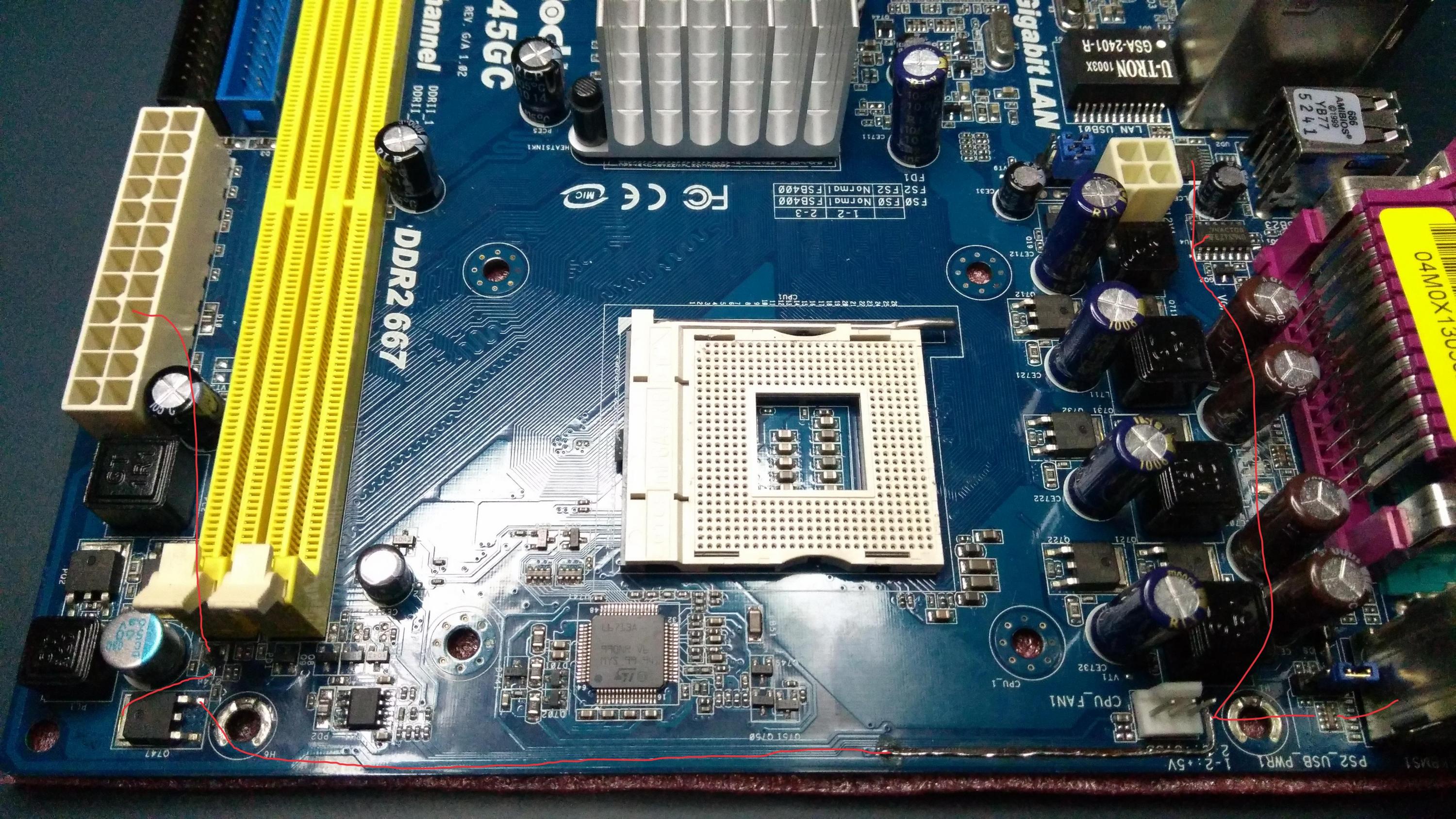

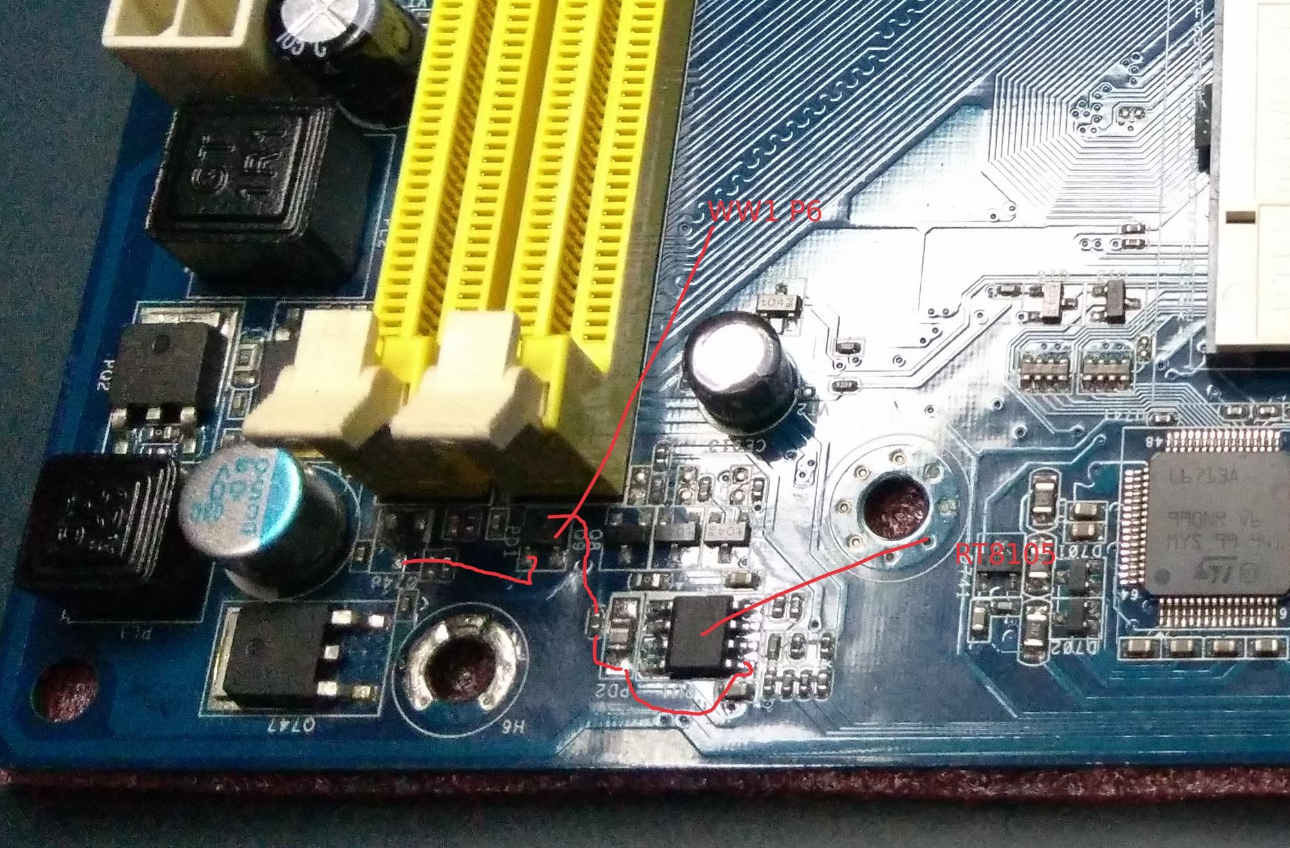

I got this motherboard with a burnt trace and a burnt SOT-23.

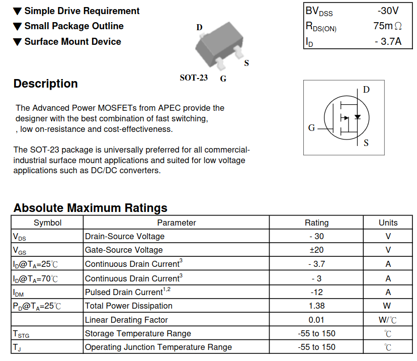

On top it has M091 (I think it's a AP2309GN
https://www.alldatasheet.com/datashe.../AP2309GN.html).

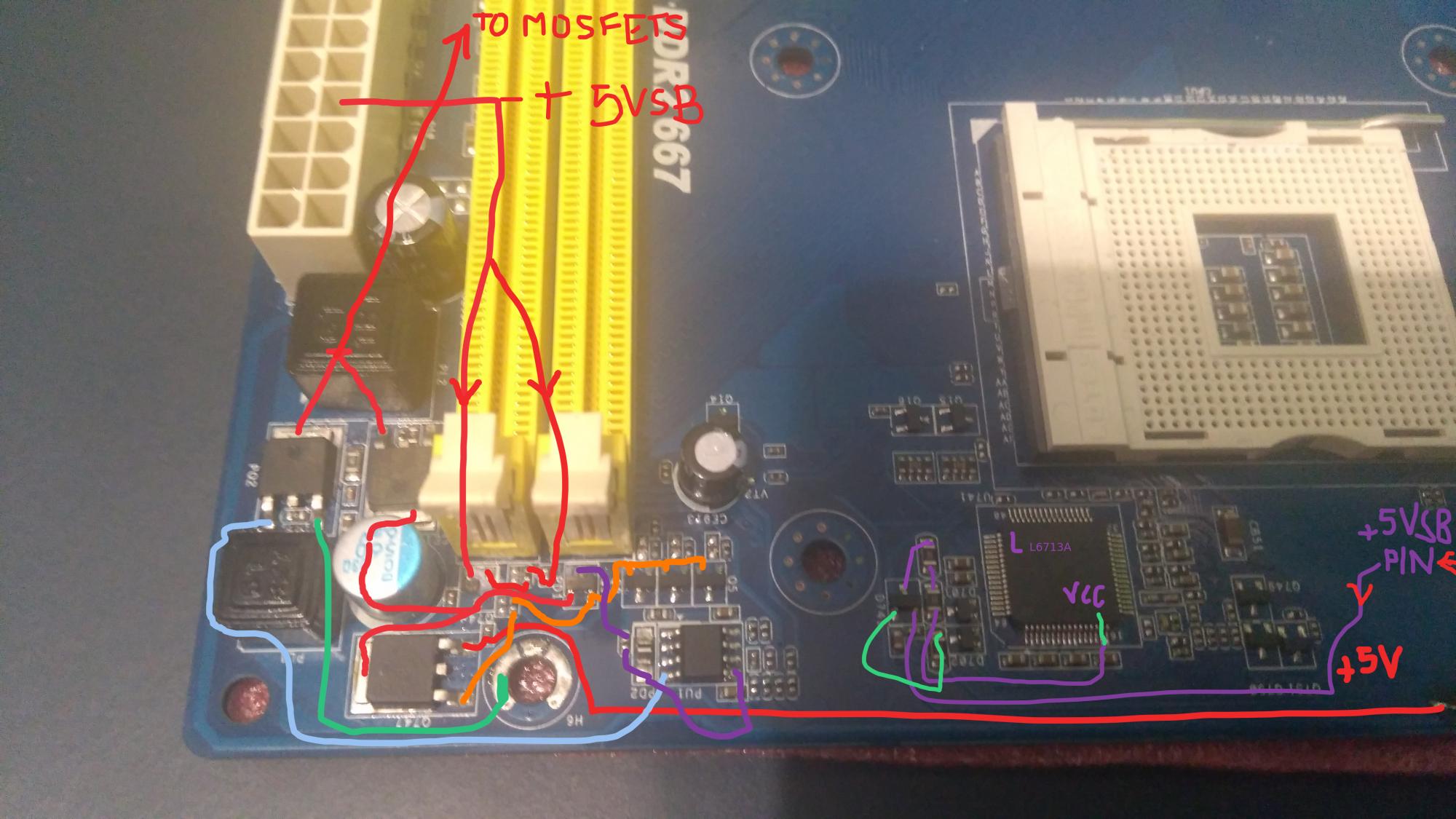

This sot-23 connects to the mosfet that then powers the trace that got burnt (se pics).
It had a blob and a broken leg on the S-D path, G was spared but it shorts to both S and D.
Source is from +5VSB; Gate is +5V can't figure from where.
I can't identify, for sure, what this is and my only solution is to either get the .fz file or get lucky and have someone tip me on what it was. (I already posted in the schematics section)
I was suggested to try a 0.5 or 1A fast blow fuse on the S-D path and see what happens.
Thanks for any help!
(I reposted in this section as I mistakenly put it the same schematics request post)
