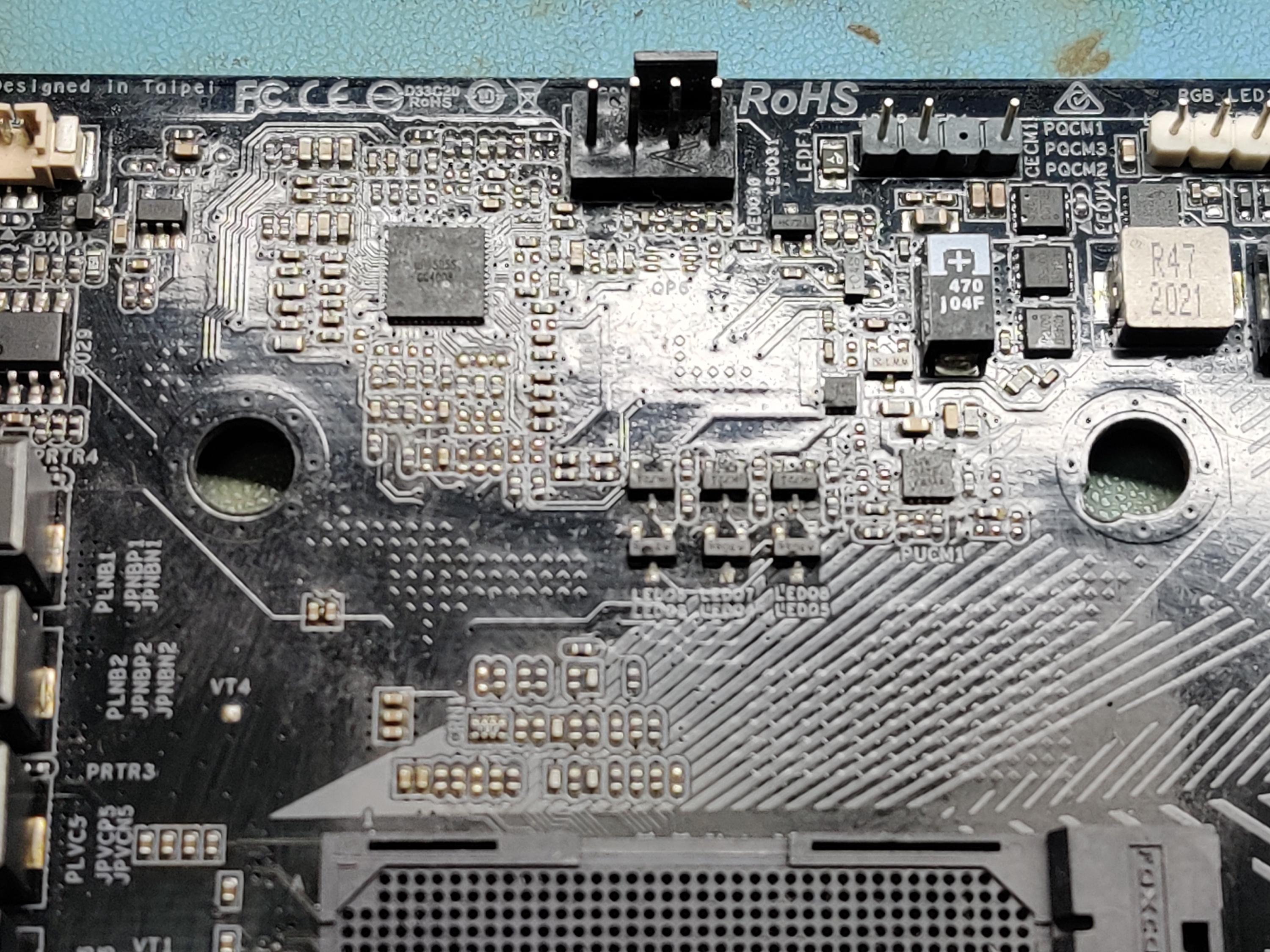

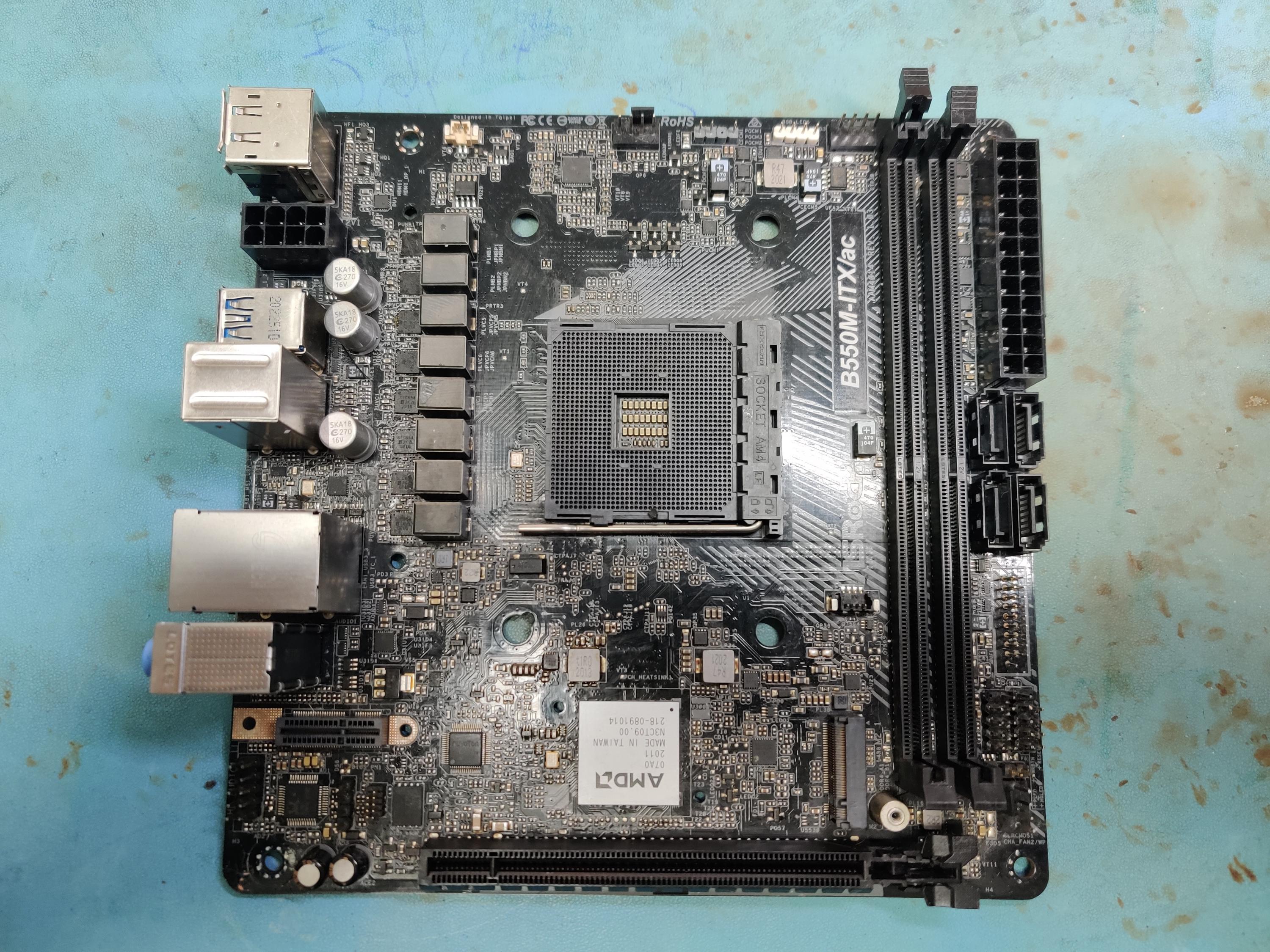

    So I've got hold of a board mentioned above.

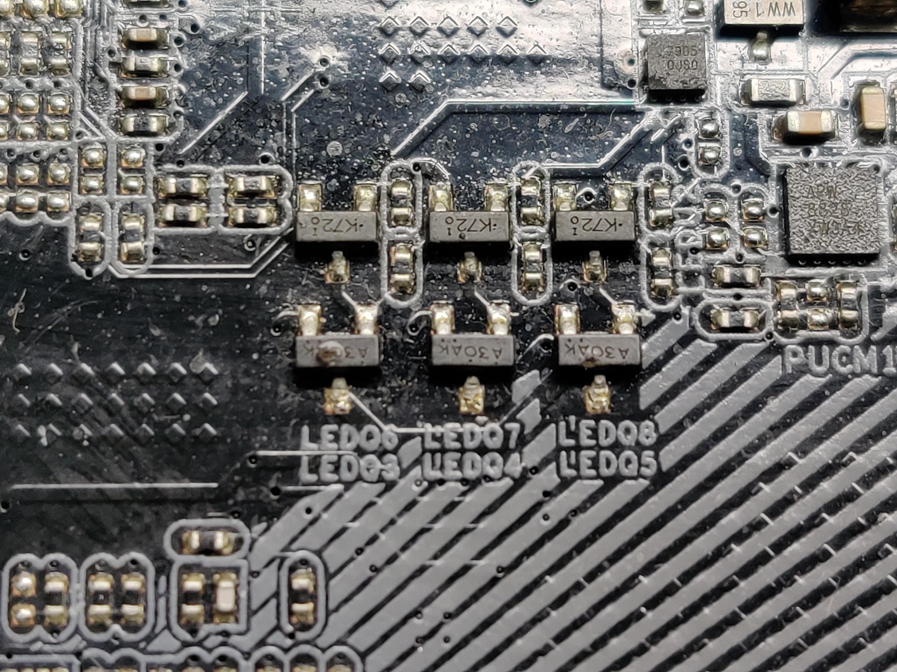

    Need help finding a suitable replacement Transistor/MOSFET of SOT23-3. 2 are blown.
    SMD Marking is A3OAK but I can't find this anywhere on the internet, not even AliExpress.
    What can I use instead of these.
    Multimeter continuity shows it connects to the LED RGB Header.
    So these are LED Drivers, but are they Transistors, Diodes, or MOSFET's ?
    Anyone please help.
    See pics.

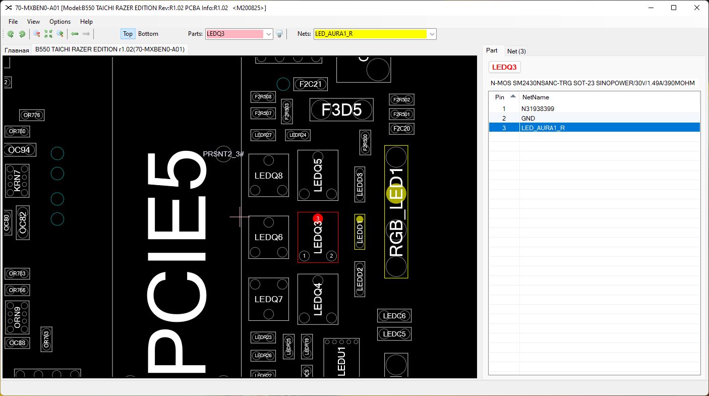

    Hi, looked into some similar generation Asrock boarview's for the same application part, it could be the N-Channel Enhancement Mode MOSFET from Sinopower -> SM2430NSANC-TRG (SM2430NSAN).
    It has the marking code A30XX, where XX is date code, which makes it highly probable it's this device, also as vendors tend to use similar devices over the product palette for lower purchasing prices.
    However you could use here any similar mosfet, with ESD protection and at least the same ratings regarding RDS(on), Vdss voltage (30V) and Id (1,49A), voltage can be even lower, as the maximum voltage present here is 12V, so 20V would also do the job. I would even recommend to use some device with much higher Id eg. 3A and and lower RDS(on), as LED strips can generate really high currents, and probably the reason for the failure was a higher current, than these devices can handle (BTW 1,49A is a fairly weak current, so I would say ASRock has done a bad job with savings here). I know there are devices out there in same package which can handle up to 6-7 Amps, but probably w/o the ESD protection, which BTW is not very critical here (once the mobo is mounted in the case, the risk for electrostatic surges is marginal inside the case - it's in fact a faradaic case).

              I found this out for all 3 of those SMD's.
              Gate (Pin 1) comes from 3 x K72 transistors.
              Source (Pin 2) goes to Ground.
              Drain (Pin 3 goes to R G B pins, respectively of each A30AK/A3OAK).
              So from this, is there any way of telling if it's N or P Channel ? Then I guess we can say if if its Vishay (P Chanel) or SinoPower (N Chanel).

                      Here I found a similar ASRock boardview with same chipset (B550) and even same part numbers, it confirms the SM2430NSAN:
                      As a good replacement you could use eg an Alpha & Omega AO3434A:
