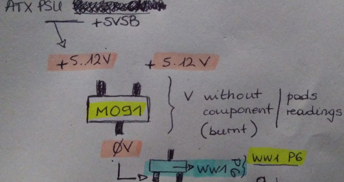

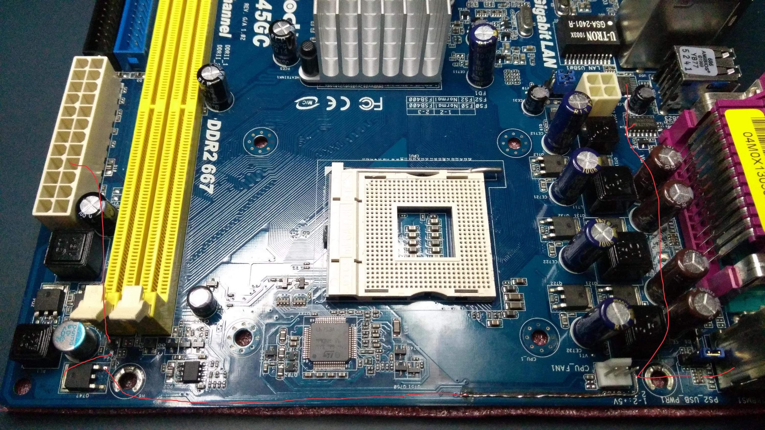

    Hello, I'm new to this forum.
    On another forum I was directed to come here for better assistance.
    Issue:
    I got this motherboard with a burnt trace and a burnt SOT-23.
    On top it has M091 (I think it's a AP2309GN
    https://www.alldatasheet.com/datashe.../AP2309GN.html).
    This sot-23 connects to the mosfet that then powers the trace that got burnt.
    It had a blob and a broken leg on the S-D path, G was spared but it shorts to both S and D.
    I can't identify, for sure, what this is and my only solution is to either get the .fz file or get lucky and have someone tip me on what it was.
    I was suggested to try a 0.5 or 1A fast blow fuse on the S-D path and see what happens.
    Thanks for any help!
    (My english isn't up to the task but I hope not too bad either.)
