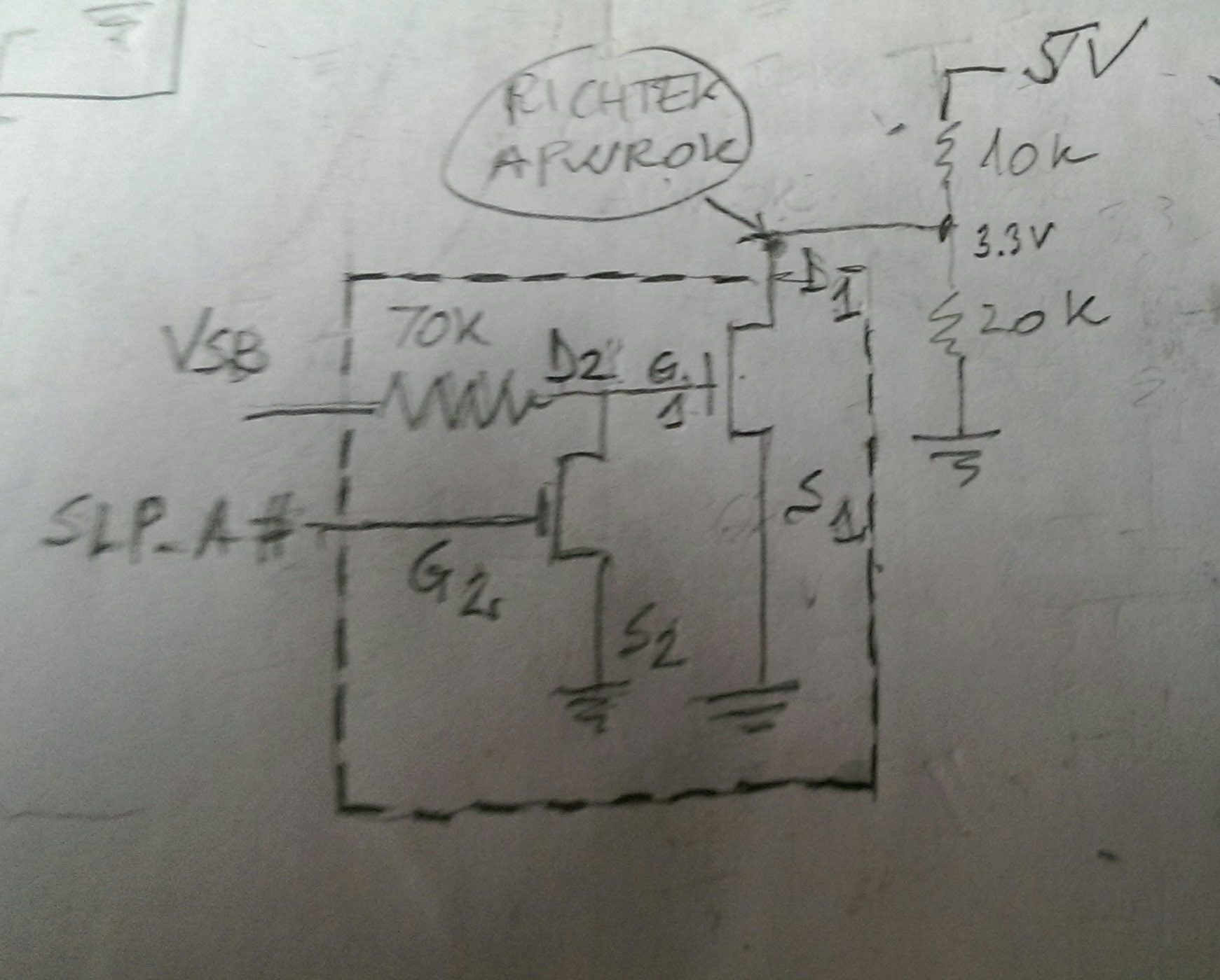

    So, I removed the richtek chip powering ME subsection of the chipset ... I then connected PCH 1.05 to ME 1.05 (after the inductor) ..... but the problem is the power ok signals. He said to connect the APWROK to OPWORK_10 ... but I checked the schematics and the last one doesn't connect to the chip.
    The components involved are not there (and this is right, the schematics don't indicated any component there) and the specific signal is not present in any other part of the board.
    So I guess he got this part wrong. APWROK is connect to the chip, so it has to be assert for the chip to accept the voltage supply for ME .... but how?

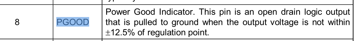

    APWROK, alias PGOOD of the richtek chip, is pulled up by a resistor to 3,3v.
    Is an open drain pin ...
    and the internal mosfet pull down the voltage to ground if it's not in the range.

            SLP_A# is the signal coming from the chipset enabling the richtek chip .... then
            he generates the 1.05me voltage and give the pgood/apwrok signal back to the chipset.
            So I don't understand why he was taking about p_opwrok_10

              Re: ASUS X99-A, usual 00 code, ME voltage 1.4 instead of 1.05 ...
              I tried this mod with no luck .... so, or the chipset is dead
              or it's not quick enough. This because apwrok can be assert before but not after pwrok ...
              anyway I can't think of anything different.
              In standby VSB put APWROK to 0v .... if SLP_A# rise, the second
              mosfet shutdown the first and APWORK rise up to 3,3v
              It's more or less what richtek chip does.

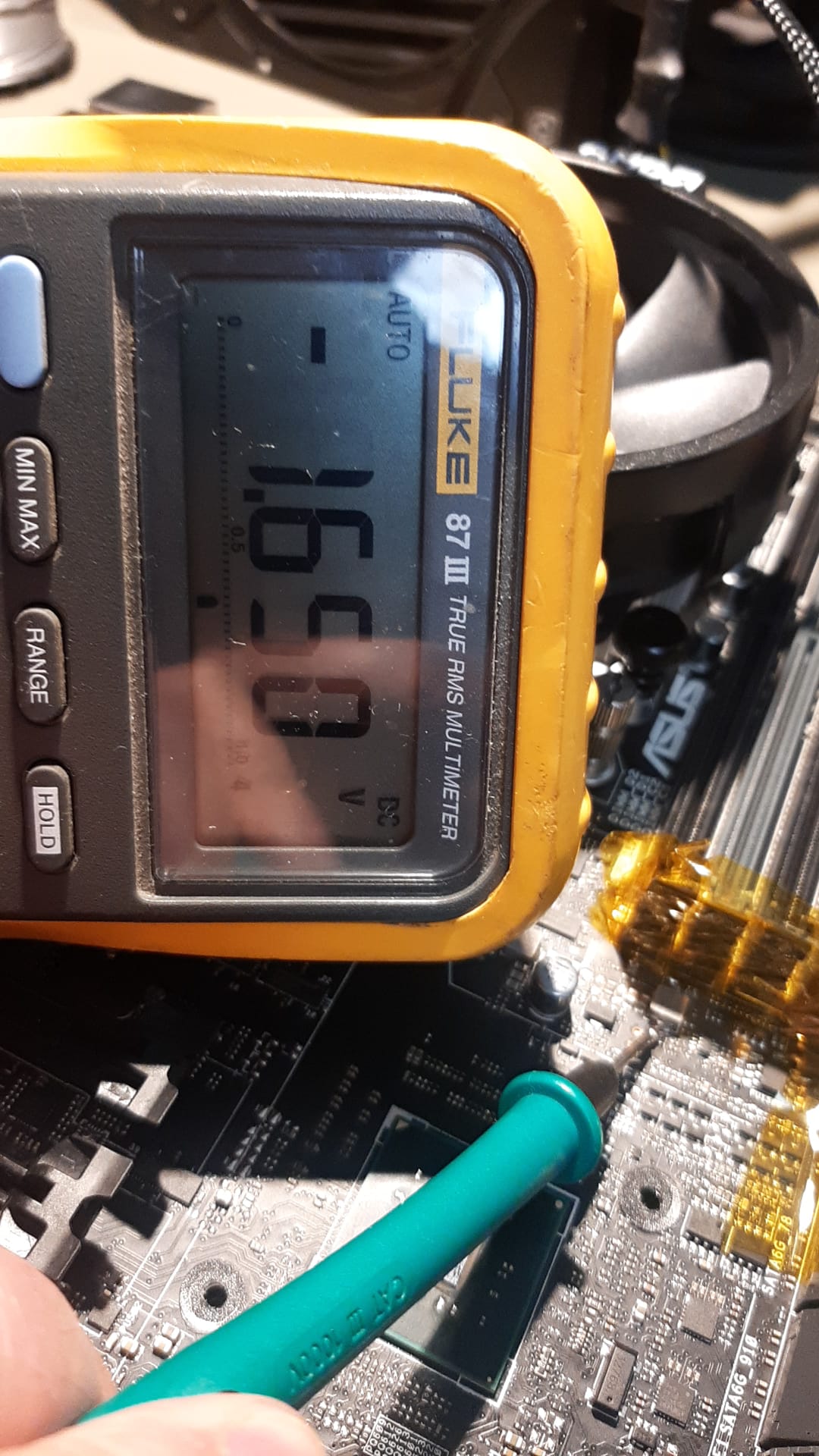

                      hello people , well.... another, in here in the same isue, 1.65v in pch arghhh kill the pch my board x99 deluxe/u3.1.
                      thanks guys, i did direct to check voltage.
                      systems start, q-code run for 9 number, last one is 30 them 00 and shuts down. pch hot.
                      now thinking if i will get the trouble to buy a new one and replace ( 40€)
