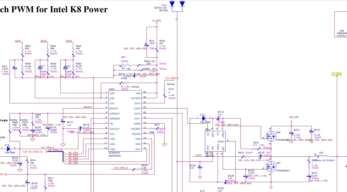

                          Without the CPU there is 46 ohms from controller feedback pin to Vcc.
                          With the CPU there is a hard short from controller feedback to Vcc
                          Couldn't find a schematic for this board, but i found one for a similar board
                          Attached, is the schematic (NF3UK8MA - same controller, drivers, and MOSFETS)
                          Then, i calculated (from the schematic) the equivalent resistance of the series/parallel resistors that are between feedback and Vcc, and got 46 ohms
                          So, unfortunately, that appears to be OK

                              According to the controller datasheet, VCORE is set by VID0...VID4 and on the schematic, these pins are directly connected to the CPU socket.
                              Perhaps you can compare their states (high or low) with this table,
                              ​​​​​​and instead of injecting 1.5V directly into VCORE, I'd force these pins to match what the table says for 1.5V

                                Am assuming that i should be looking at the K-8 output voltage chart that's on that datasheet, since the CPU is AMD socket 939
                                On VID pins 0 to 4 there is 10110 (3V = high),
                                and that equates to 1.00V
                                Meter shows about 1.0V
                                Shorted a few of those pins to ground and had it up to 1.2V and the PCI card moved on to a different code and stopped there
                                But now i noticed that the mosfets were getting hot, Vcore 800mA, and now the CPU is shorted
                                Maybe i briefly put it up to 1.55V, and killed the 3000 CPU since it's maximum specified voltage is 1.35/1.4V
                                If that's true, i wasn't aware that an extra 0.15V could kill a CPU
                                I've now put a 3200 CPU into it, but of course there's not enough voltage to fully power the CPU 1.35/1.4V
                                It's still 10110 (1.00V)
                                00110 would be 1.4V
                                VID4 is 2.77V when the other two highs are 3.0V
                                It's a bit suspicious
                                Maybe there is a faulty component in the VID4 circuit that is stopping it from being pulled low,
                                because 00110 is only one digit different from 10110
                                Hmmm
                                If the VID signals are generated from the CPU, then it seems that the CPU is asking for 1.4V, but it's not getting it, so it's not POSTing.
                                At the moment i'm not keen enough to ground VID4 in case doing so kills this CPU also

                                  It doesn't make sense to me that when it's being forced to pull low, it will end up overheating the mosfets and killing the CPU, because these pins are supposed to change states real-time, in respond to whatever voltage the CPU requested, such as when a user is under/over-volting the CPU on the fly.
                                  Most likely what killed the CPU was the high side mosfets gate were opened and 12V passed through.
                                  ​​​​​Other than pull up resistors, I don't see any additional circuitry. Pins are direct connection from the CPU to the phase controller and shared with super IO for monitoring.
                                  Maybe try turning on the mainboard without a CPU and see if the VID pins change state accordingly (all pulled low = OFF)
                                  The alternative of injecting VCORE from your bench supply poses a much higher risk factor because it involves exposing the components to an excessive heat from your hot air blower gun, since you will have to remove the mosfets and then force the phase controller to stop working (either by pulling VID pins to low or remove the chip)

                                    This board also has an IT8206R "jumper free overclock controller" that's located next to the VRM controller, and VID 0-4 also go to it
                                    There's five 4.7k pull up resistors
                                    with the PSU and CPU removed, they all measure 3.4kohms in-circuit,
                                    except for VID3's resistor, which is 1.3K
                                    With the CPU removed, there is 1.0v VCORE, which corresponds to what's on VID 0-4 10110
                                    With the CPU installed, there is 0.975 VCORE which corresponds to what's on VID 0-4 10111
                                    OK, so i felt confident to start it up while shorting VID3 to ground
                                    which put 1.370V (probably 1.375V) on the VCORE, and code 45 on the pci card,
                                    but still couldn't swtich it off with the power button
                                    And it obviously didn't like it, becuase now the VRM is not being switched (no voltage on the mosfet gates), so nothing on VCORE
                                    i checked the CPU - fortunately, it's VCORE isn't shorted to it's ground like the other one.
                                    Tried resetting the bios, but no change
                                    Was reading that resistors don't usually fail short, so the pull up resistors are probably OK
                                    Am thinking that that out-of-line reading across VID3 pull up resistor is possibly an indication of a faulty controller chip
                                    • прямо
                                      • Sep 2022
                                      • 261
                                      • Indonesia
                                      Try pulling VID3 low again, but without a CPU this time, and see if you will actually get 1.37V or not, because I don't think the phase controller chip is faulty, after all it was able to put out the correct voltage for 0.975V, 1.0V and your earliest attempt at 1.2V
                                      • socketa
                                        Asbelowsoabove
                                        • Jun 2014
                                        • 661
                                        • samsara
                                        Did that (sorry, it was VID4, not VID3, that i pulled low to get 1.375V)
                                        There's 12V on the three drivers supply pins
                                        There's 8.57V - 8.64V on the low side gates,
                                        but there's no voltage on the high side gates,
                                        and of course, there's no VCORE
                                        The controller is putting out a signal 10110 (1V)
                                        and when grounding VID4, there is still no VCORE, since there's no voltage on the high side gates
                                        There is no voltage on the PWM OUT pins
                                        Then i accidentally shorted OUT1 to AGND, and it shut down, now the board wont start
                                        It tries to start (nForce4 fan twitches), and shuts down nearly instantly because the high side mosfet's drain and source are shorted to each other
