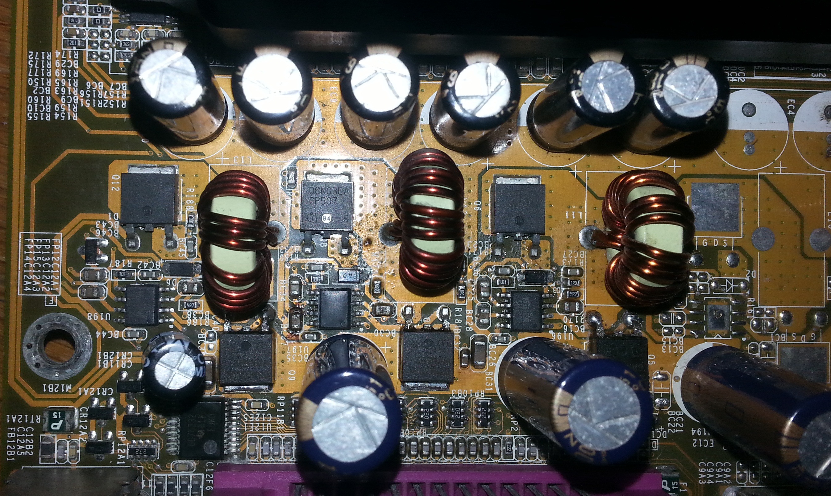

    The VRM caps all test good (MCZ and MBZ)
    There's normal-looking voltages on all of the big MOSFETS that are on the board.
    The VRM MOSFETS are not shorted.
    Anyway, i mistakenly thought that there was too low resistance on the high side MOSFETS (12Kohm) but after checking out a similar board schematic saw that that was normal.
    But by that time i had removed the three high side MOSFETS, three electrolytics, and the six little SMD decoupling caps that were in parallel.
    So i put the MOSFETs, electrolytics, and three of the decoupling caps (lost the other three), and powered it up.
    To my surprise, it booted normally, no problem, and didn't freeze when in BIOS, i verified this several times, and all appeared to be working well, and all of the rail voltages that were listed in "health" section looked great, "yay!"...

            While looking over the area again, i noticed a bulged driver
            Now, i don't know it it was like this when i got the board, or if it was a consequence of spending too long heating the MOSFETs when removing and replacing them (i only had the hot air gun on the MOSFETs)
            So i'll order another one and another MOSFET, and hopefully replace them without destroying any other components.
            Could a damaged VRM driver be a reason why the board is faulting?
            Also when i got the board i noticed that the NB driver fan was noisy/erratic, and had being replaced, and that the third wire was disconnected (which i reconnected, and the BIOS health screen showed that it was monitoring it's RPMs, and also spins lot quieter now) - So the NB may have being running without a fan for some time.
            The fan makes a big difference to the NB temperature - from being fairly hot when it's not connected, to being luke warm when it is.

              What soldering tools are you using to replace the MOSFETs and drivers? Hot air?
              The VRM area is pretty hard to heat, so it's definitely possible the driver IC could have been heat-damaged from the hot air.
              I myself prefer using just two soldering irons to remove such parts and save the hot air only for TSSOP or finer pitch ICs. In case of MOSFETs, I use my 75W station to heat the tab, and then a 30W iron alternating between the two legs. Once all heated, I slide the MOSFET away. Same with 8-pin ICs, like that driver. Takes only a few seconds to remove a MOSFET that way and there is minimal heat leakage to any other components. Before doing any of that of course, I first add fresh solder to the tab and legs of the MOSFET. And in the case of 8-pin SO/SOIC, I add solder to bridge all of the pins on each side.

                  Yeah, i used a hot air station.
                  Thanks for providing a better technique/alternative
                  That "bulged driver chip" now appears to be a good chip with a coating of flux on top of it (i realized that after measuring all of the pins to ground, and they all were the same)
                  So, i cleaned it up, plugged the two ATX connectors back in, pushed the power button, and now get horizontal dashes on the POST analyser card. (which is what happens if i forget to plug in the 4-pin CPU ATX connector)
                  So then i check the voltage of Vcore, and it's 1.01V, which is significantly less than what it was before. The drain pin is 11.94V.
                  I didn't do anything, except wipe the flux off of the top of the chip. Now i turn it back on, and Vcore has dropped to 1.01V

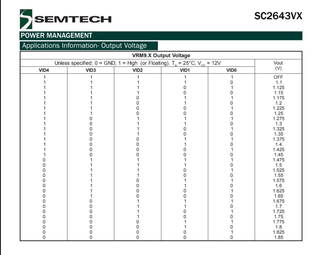

                          Without the CPU there is 46 ohms from controller feedback pin to Vcc.
                          With the CPU there is a hard short from controller feedback to Vcc
                          Couldn't find a schematic for this board, but i found one for a similar board
                          Attached, is the schematic (NF3UK8MA - same controller, drivers, and MOSFETS)
                          Then, i calculated (from the schematic) the equivalent resistance of the series/parallel resistors that are between feedback and Vcc, and got 46 ohms
                          So, unfortunately, that appears to be OK

                              According to the controller datasheet, VCORE is set by VID0...VID4 and on the schematic, these pins are directly connected to the CPU socket.
                              Perhaps you can compare their states (high or low) with this table,
                              ​​​​​​and instead of injecting 1.5V directly into VCORE, I'd force these pins to match what the table says for 1.5V

                                Thanks for that
                                Re-flashing made no difference
                                Am assuming that i should be looking at the K-8 output voltage chart that's on that datasheet, since the CPU is AMD socket 939
                                On VID pins 0 to 4 there is 10110 (3V = high),
                                and that equates to 1.00V
                                Meter shows about 1.0V
